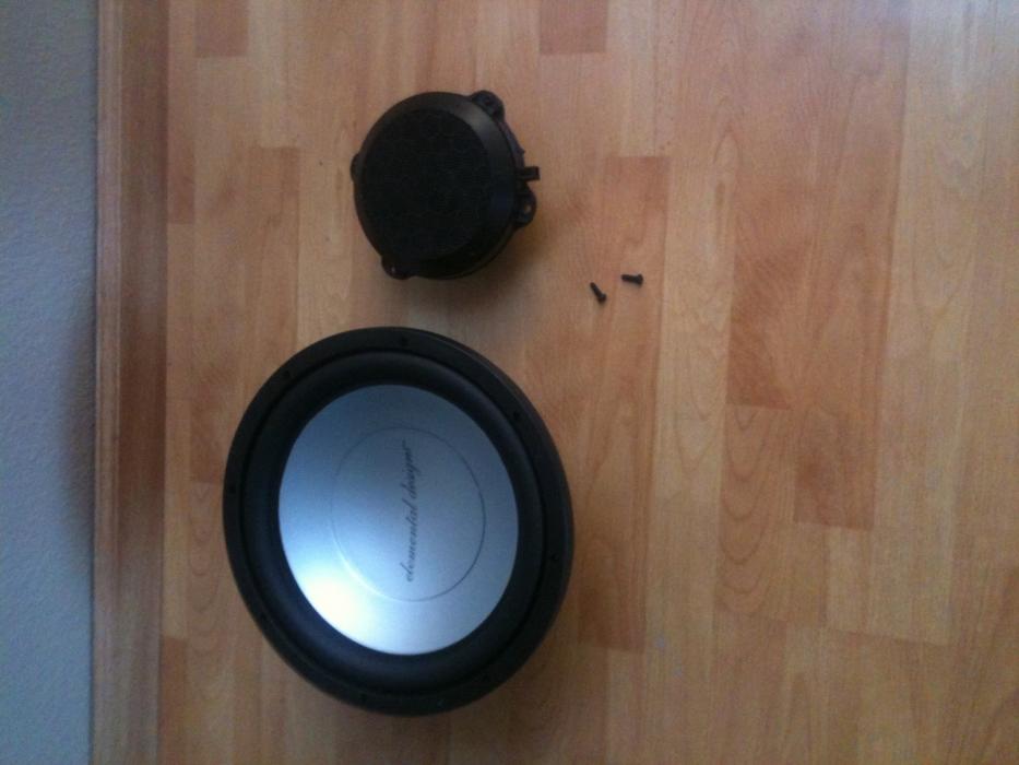

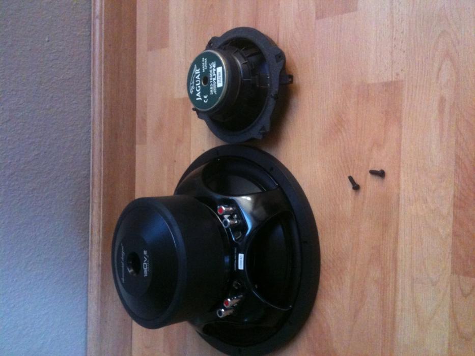

here's the pics of the two subs side by side....
Attached Thumbnails S type R Subwoofer Upgrade - Elemental Designs 13Ov.2 dual 4 ohm-ed-sub-1.jpg   S type R Subwoofer Upgrade - Elemental Designs 13Ov.2 dual 4 ohm-ed-sub-2.jpg

the sub box is built and I'm breaking in the sub slowly at relatively low volume with my home system until my car is out of the shop. The box ended up 1.13 gross cu ft and I used poly fill to make the box seem even bigger. The performance should be pretty dang awesome. The sub motor and magnet structure is massive.
