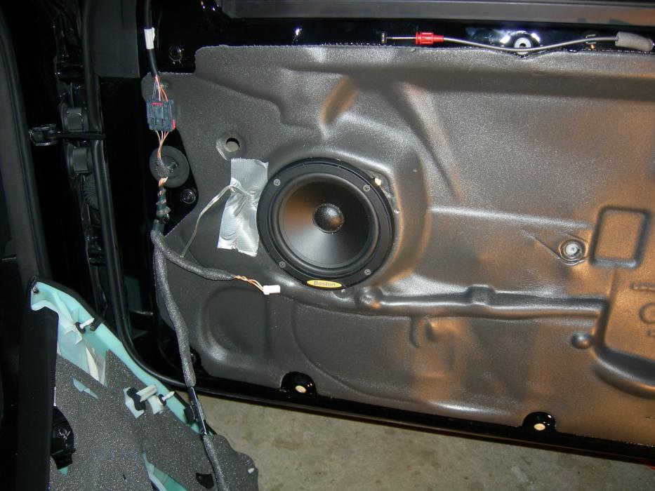

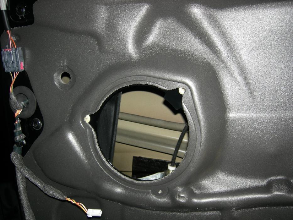

I had a Boston Acoustics 6.5" component sent mounted into the doors of my X-type. I removed the factory speaker in its entirety (including the plastic housing). And drilled 4 holes for the screws in the metal. I used those metal clips that act as a retaining nut that come with the speakers to hold them down, and the grill frame to act as a seal.
Here's a pic.
Attached Thumbnails Will a standard 4 screw speaker fit into an 02 x-type?-dscn0583.jpg   Will a standard 4 screw speaker fit into an 02 x-type?-dscn0581.jpg
