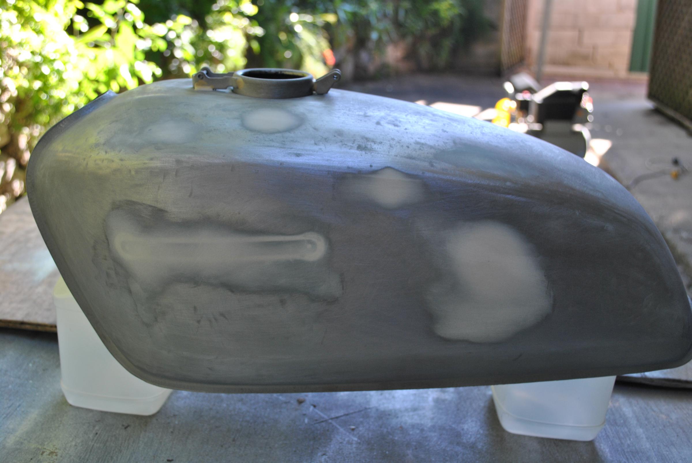

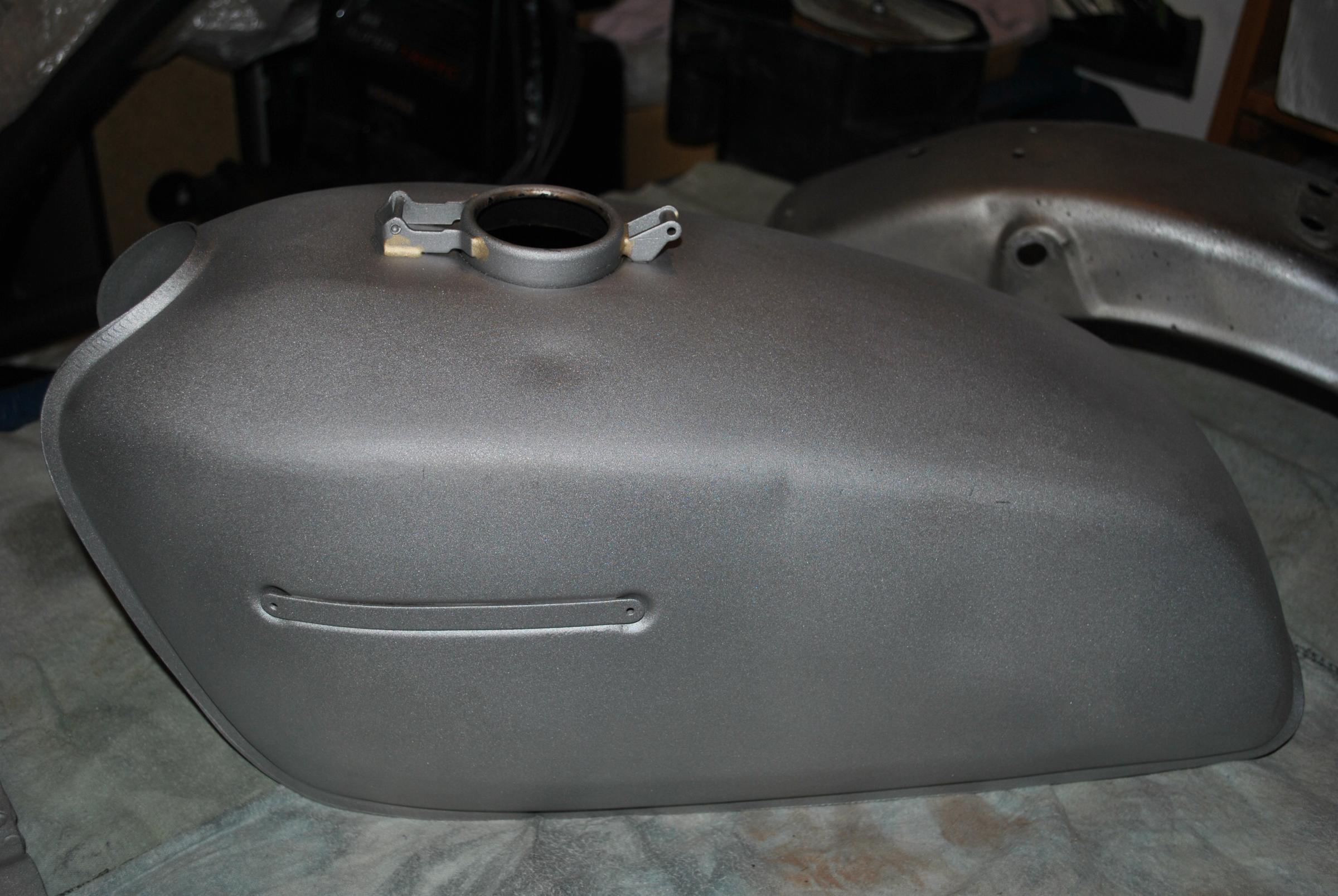

Hi Vincent, I usually use a body filler first to get a blank canvas then use spray putty then primer, then a colour base coat before many layers of clear coat.
With all the prep and sanding done as Dr Youtube says of course.
All my aerosols are from Repco or Supercheap Auto ,nothing expensive. They have lasted many years on jobs I have held on to.
Preparation is the secret, get that right and paint will always look good.(DR Google and DR Youtube are your best friends).
Take your time, every time I try to hurry paint work I end up doing it again.
You can get amazing results on small parts. But if you are using a two pack paint that requires baking you either need an outdoor pizza oven or a really understanding wife.

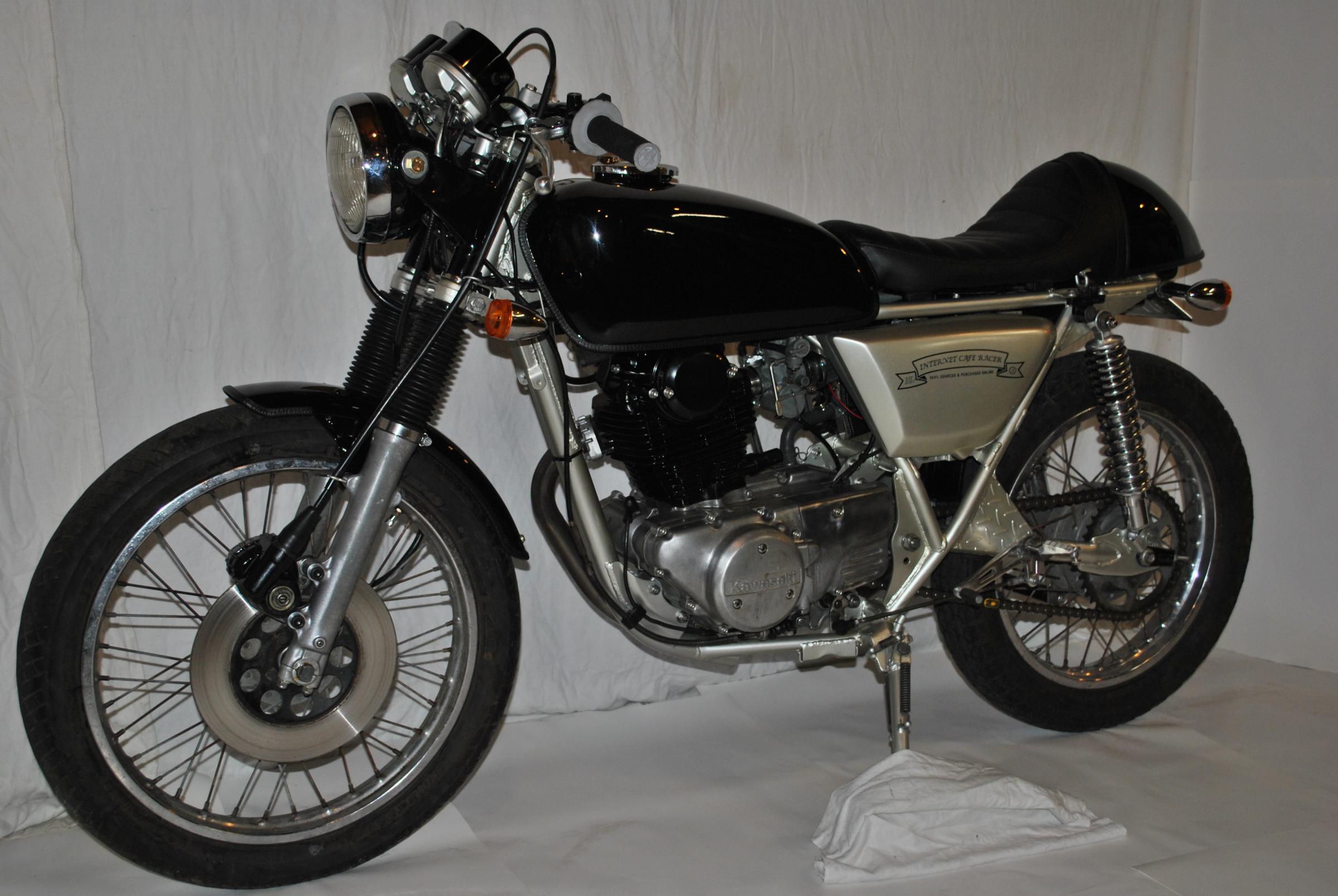

You can buy 2 pack here in aerosols and no warnings are given. I just bought it and painted in my yard. My brother who was a spray painter in the 80's & 90's said it should be baked for best results so I used "Her Indoors" oven.
results were near perfect for a novice.
