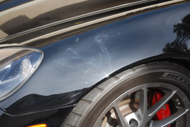

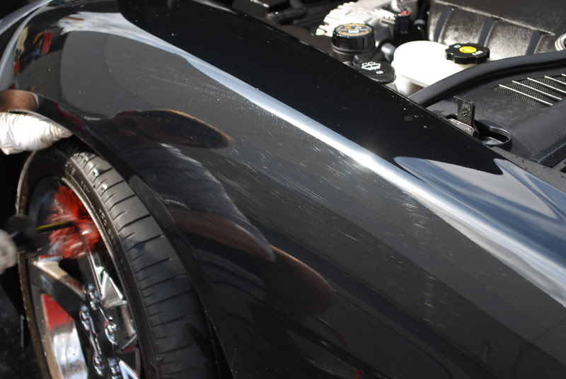

Here are some pics of a couple very recent customers that religiously used the Duster. As you can see from the photos, what this has done is create a million v shaped inclusions into the paint which takes away from the overall depth and gloss. Kind of like an older record, if you look at the surface its not reflective like a mirror, the grooves make the surface appear less reflective or distorted. This is exactly what happens to your paint by using this Duster to move around all these contaminants which are as sharp as a kidney stone. Therefore marring the finish to the point where it needs correction by means of polishing....

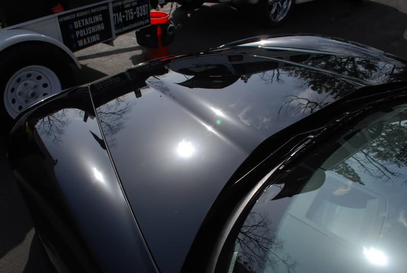

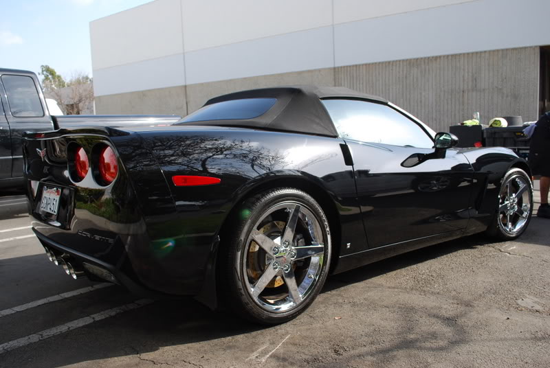

Now take a look at these shots after the paint was rotary polished to correct the scratches caused by the duster. This technique is very similar to that of a jeweler, remove the least amount of material to correct the defect....No one wants their gold jewelry hacked do you, well neither should your vehicles paint!
Now, all paint should look like this, deep, reflective, shiny and brilliant!
