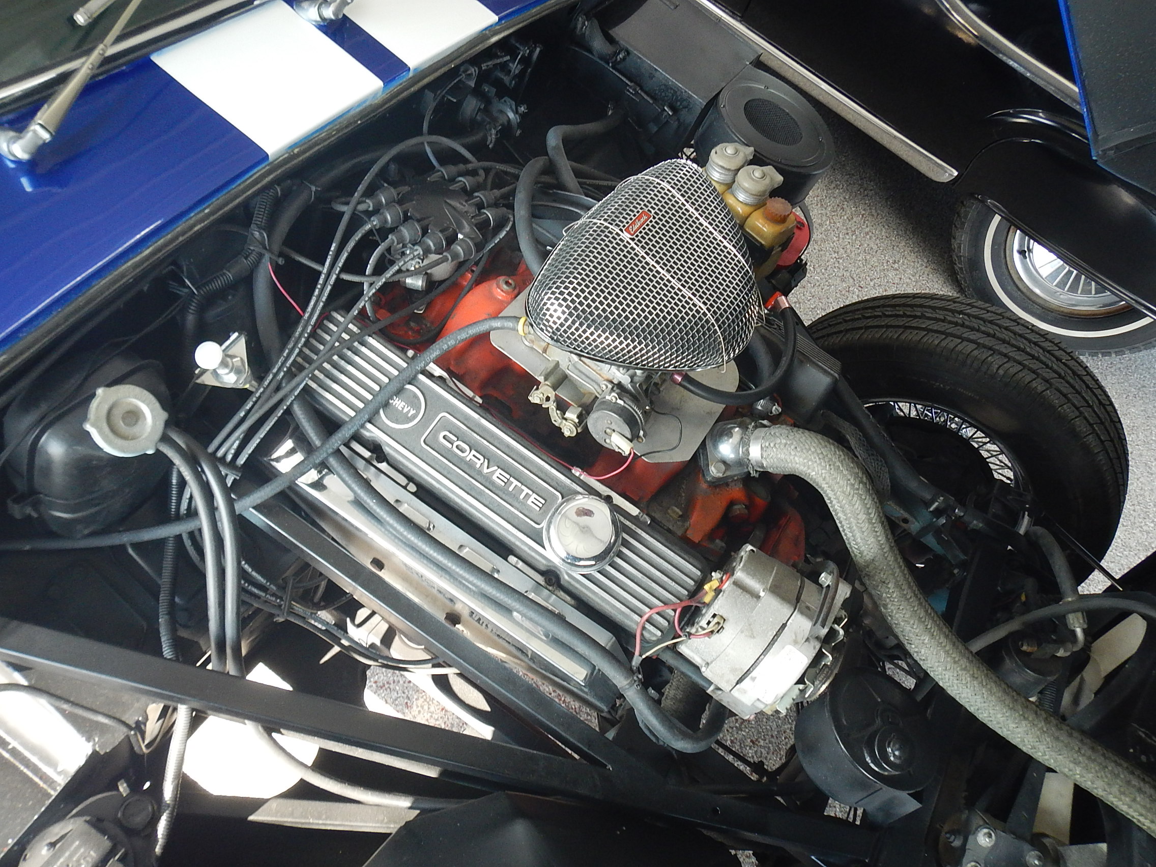

Default Now if you really want to have vacuum advance...
Doubt many of you will go for this though... (as a side note you can get a Chevy engine to fit in an XKE).

Old Nov 11, 2017 | 03:47 PM
gtjoey's Avatar

From: new york
I like it but.....It takes all the pain and suffering which comes with original ownership.
You also put Castrol 20/50 out of business......bahhahhhh

Old Nov 11, 2017 | 05:19 PM
enderle's Avatar
Posts: 2,852
Likes: 703
From: Bend, OR
I've had the SUs, Strombergs, and Side Draft Webbers (45CFM which I had on the '64). I'm in the process of pulling the double pumper on this thing and putting on a Holly Sniper EFI. I've become a huge fan of just turning the key to start the damn things. The drama of chokes and ugly cold starts got really old over the years. (And I bought the car with the Chevy in it).
