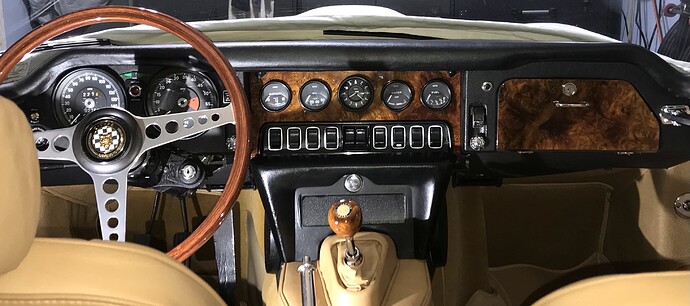

So, my shift knob and dash carpathian elm project is as complete as it can get for now. While I don’t have and haven’t been able to get a manufacturer to respond re a tach/speedo piece, I’m comfortable with the current look. Any and all opinions welcomed.
As an FYI, to install, the glovebox took the most work, if you can call it that. I had to drill holes for the glovebox metal stay (leveling) piece as well as for the door pull handle. The lock opening was tight and had to be sanded down to receive the lock mechanism. The gauge piece was straight forward as many pointed out above, upon removing the gauges and loosening the screws affixing the vinyl covered wooden piece to the metal backing, the wood came right out, allowing for installation of the new wood piece.
