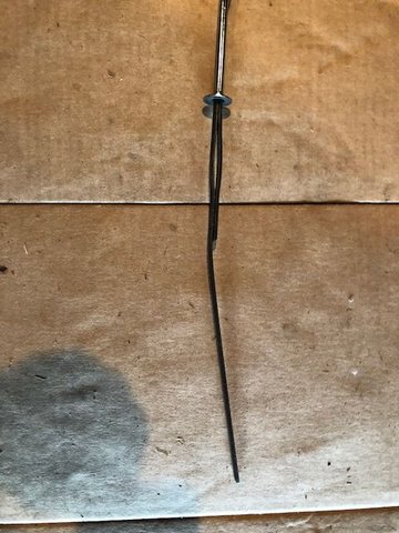

The dip stick does not appear to be able to have the stop disk move. I measured the distance of the "E" mark to the dip stick
stop disk and it is 9 1/4 inches measured direct, and 9 1/2 inches measured along the dip stick. The dip stick has a red circular handle indicating to wait

A followup comment. From the measurement you can tell that the stick is bent. I have attached a couple of photos.
Reading on the "E-Type forum", someone reported that the straightened dip stick read in the knurled area.
Can someone confirm whether the did stick is supposed to be straight.
Thanks,
Dan..

the oil level dipstick on my 1968 does not have a bend like yours. Straight all the way down.

Well, when I straightened the dip stick, it now reads oil to the top of the knurled area indicating a full
oil supply.
