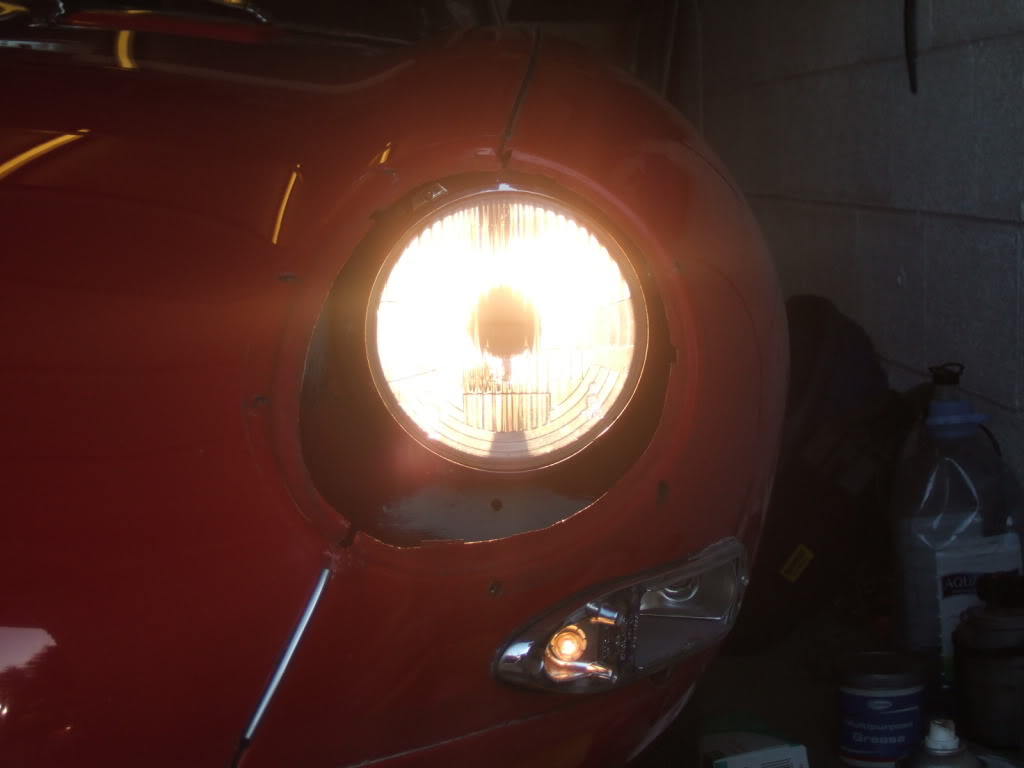

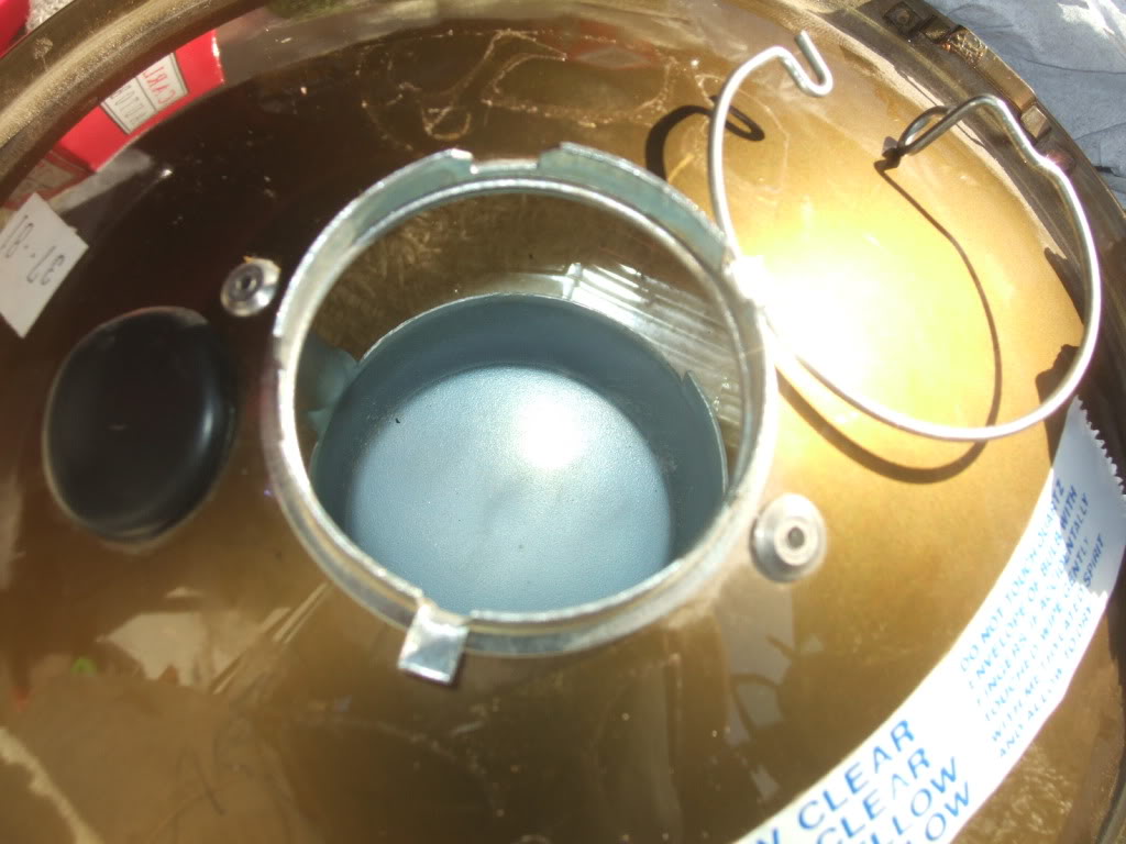

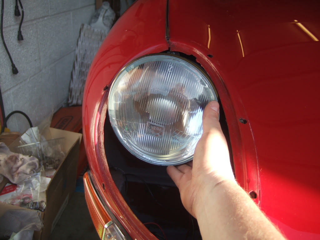

Refitting my headlamps today and came upon this issue:
I refitted my Lucas H4 headlamps this afternoon both with Halogen H4 bulbs
1 shone like this:
No. 2 like this
Yes its on.
Inside it looks like this...
Do the rivets need drilling out and taking the inside piece out, I tried it with 3 different new bulbs no joy :?:
Any suggestions :!:

What's changed? Presumably they both were fine before. Are you just upgrading the bulbs or have you changed the whole headlight fittings left and right? You say No.2 is on but do you just mean it's switched on or can you see if the bulb is actually burning though somehow obscured?
I doubt the inside piece is the issue. Presumably the two fittings are identical in this respect. I think it might be a wiring issue not having the answers yet to my questions.
I upgraded from original equipment a couple of months ago, to Hella H4s troublefree, for a vast improvement.

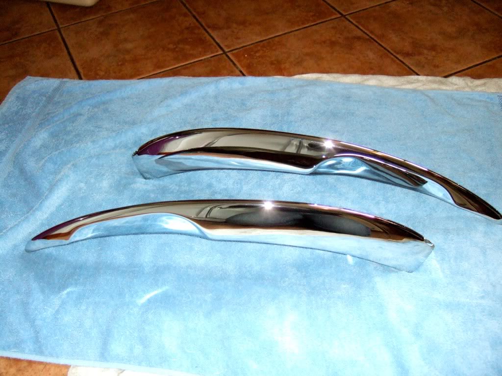

The reason for doing the headlight was i came home from a friends one evening in the autumn and could hardly see in front of me with the headlights on full
Headlight upgrade was then required, so was the rechrome of my front bumper
Toothless and ruthless

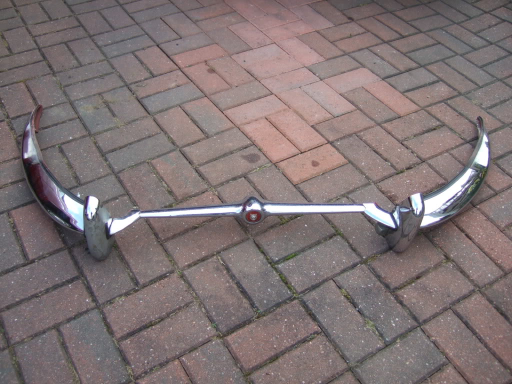

Ready to go to the platers before stripdown.

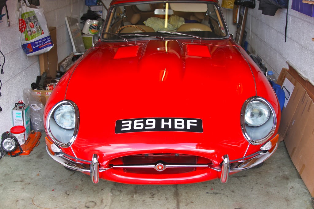

Parts back ready for the re build
Finally back together
Before someone says it, yes I am short of garage space
By the way the headlamp turned out to be an earth wire was off
