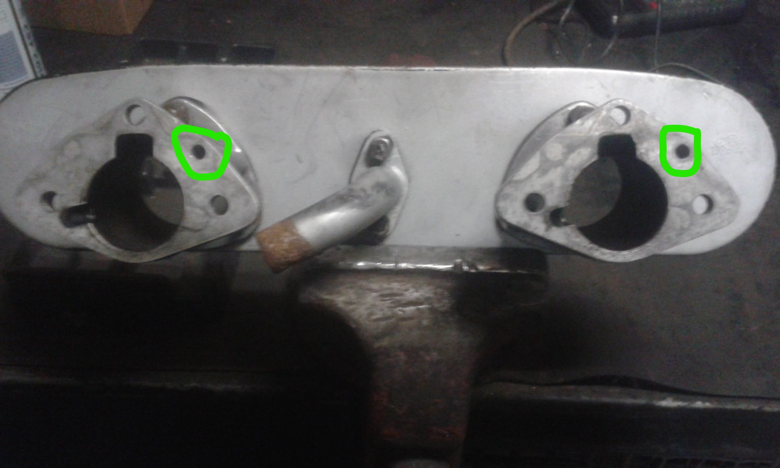

Dual stromberg or triple SU carbs ?
I've had the same problem on my car ( dual stromberg carbs) and it turned out to be wrong metering needle's and blocked float chamber vents on air filter side

Also check if the secundary throttle valve's open up
