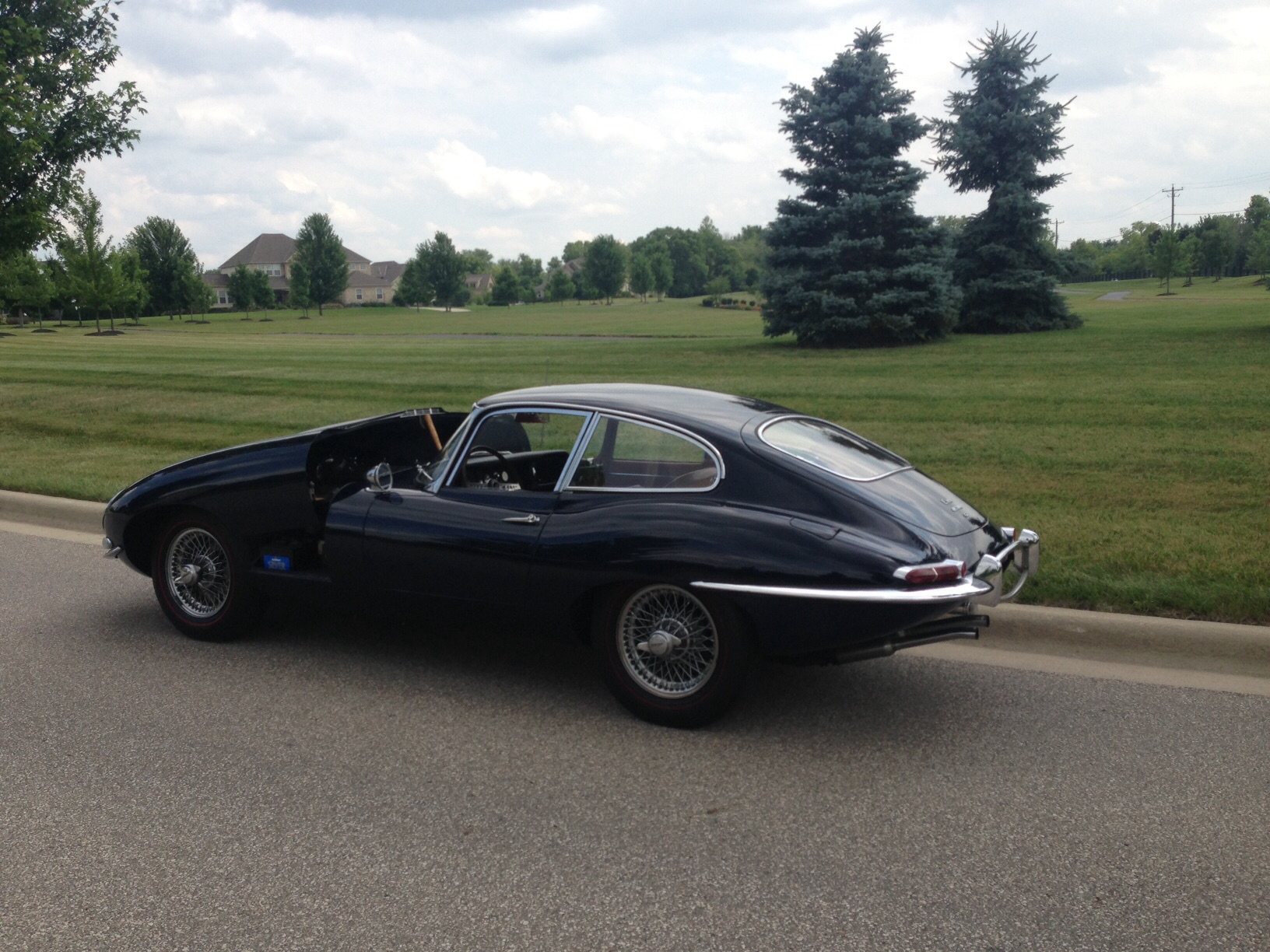

runner's Avatar
Joined: Mar 2009
Posts: 18
From: ohio USA
Really and it's worth it
