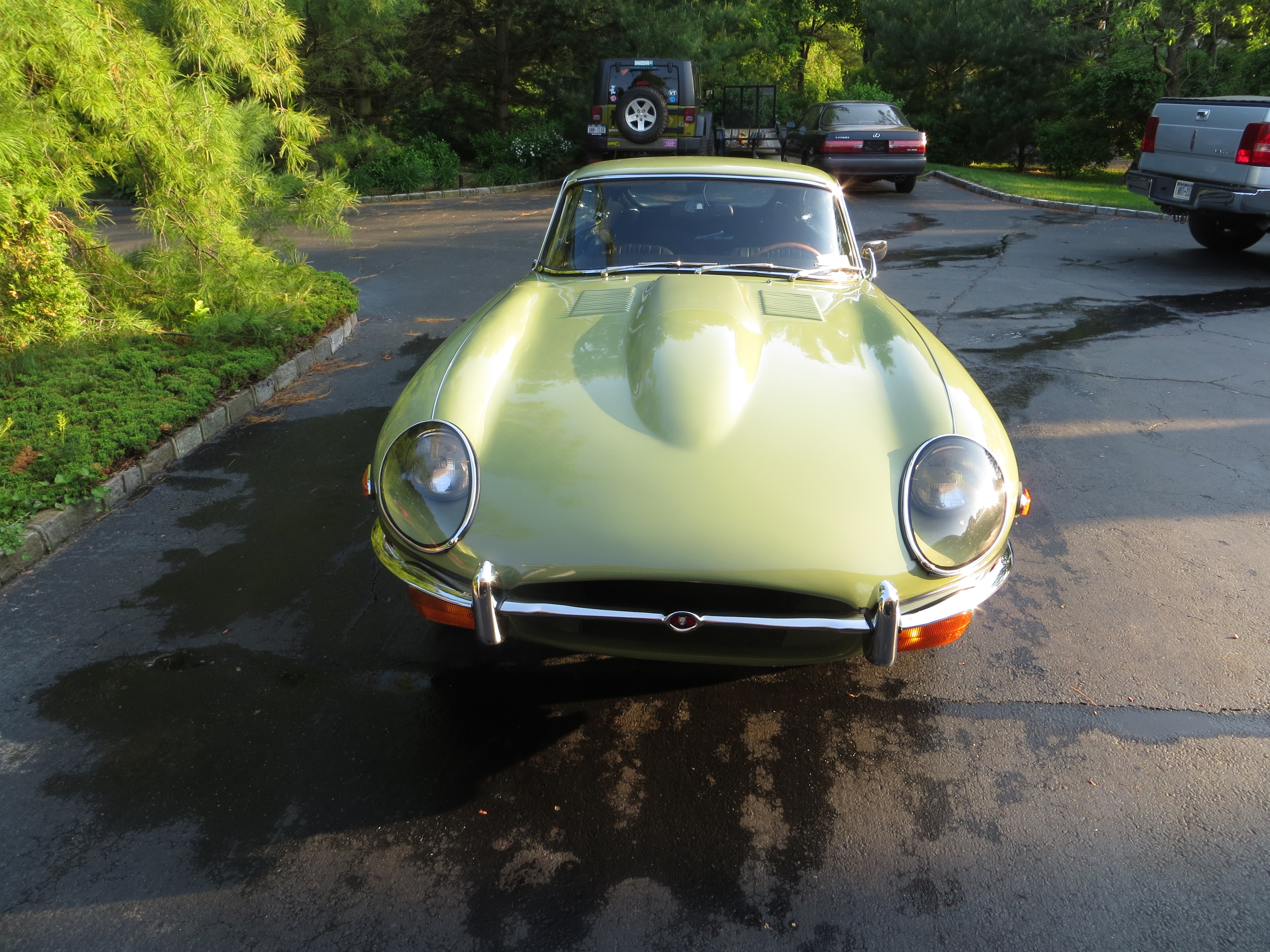

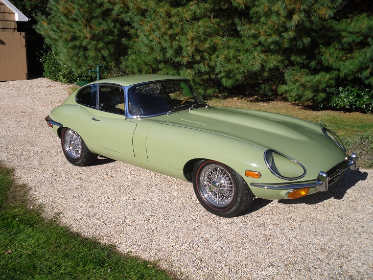

Old May 31, 2016 | 09:23 PM
gtjoey's Avatar
Joined: May 2016
Posts: 346
Likes: 63
From: new york
I agree.......try to guess this one!
Attached Thumbnails Series 1 carburators-img_0338.jpg   Series 1 carburators-sdc11270.jpg

Series 2 , with Series 1 covered lights?
