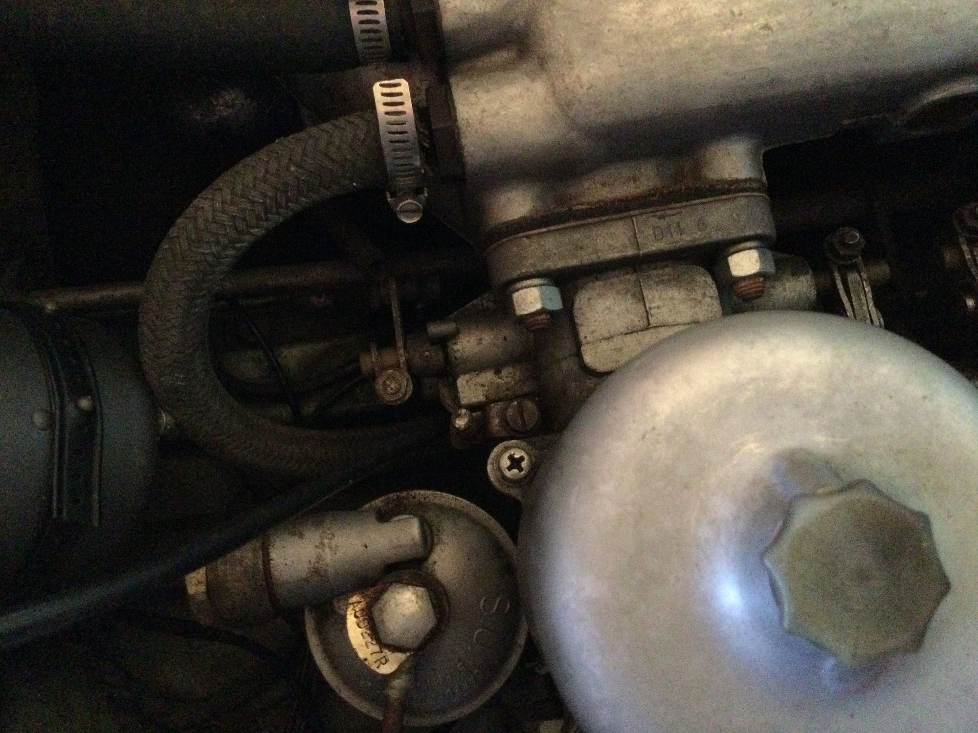

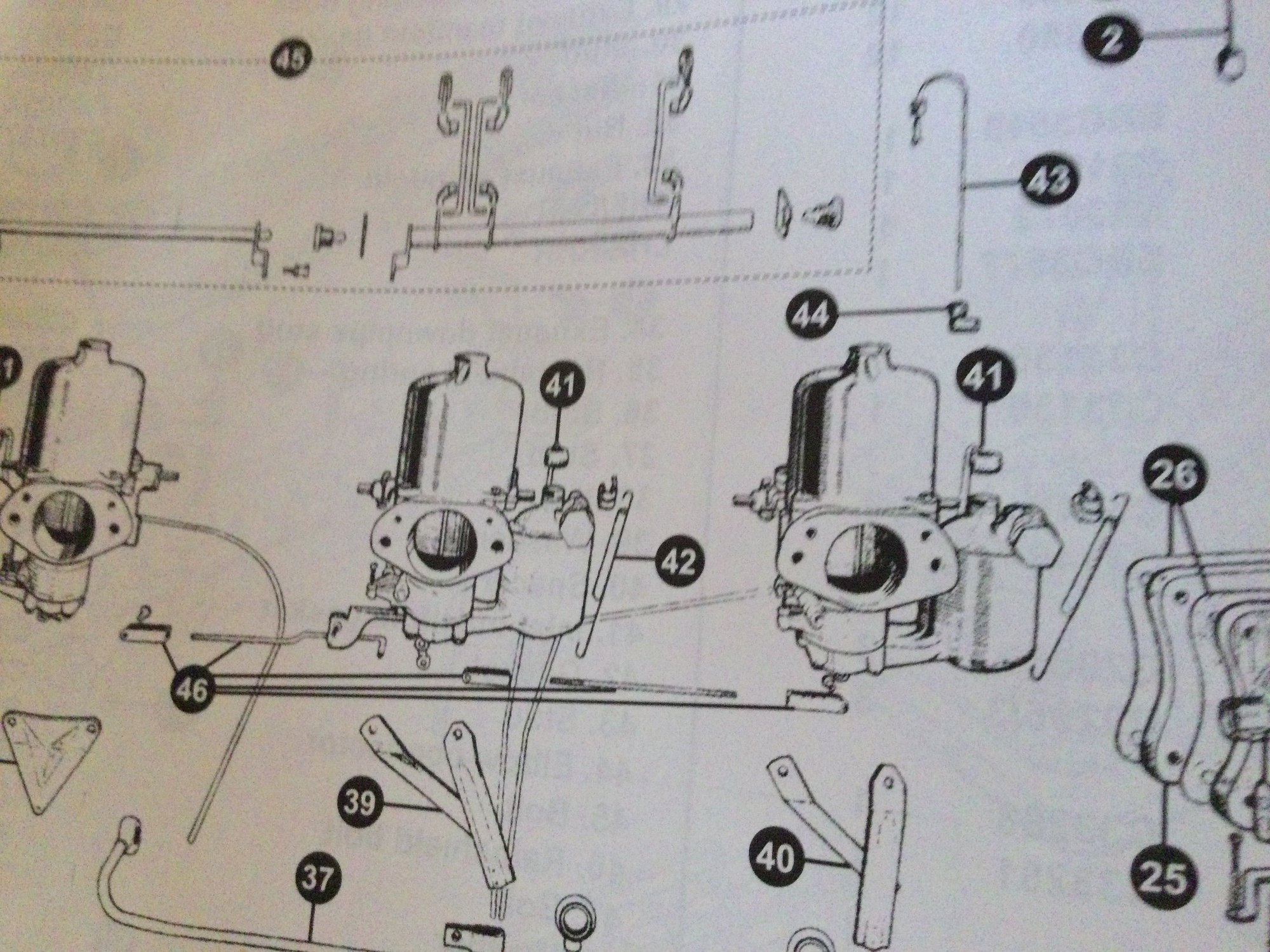

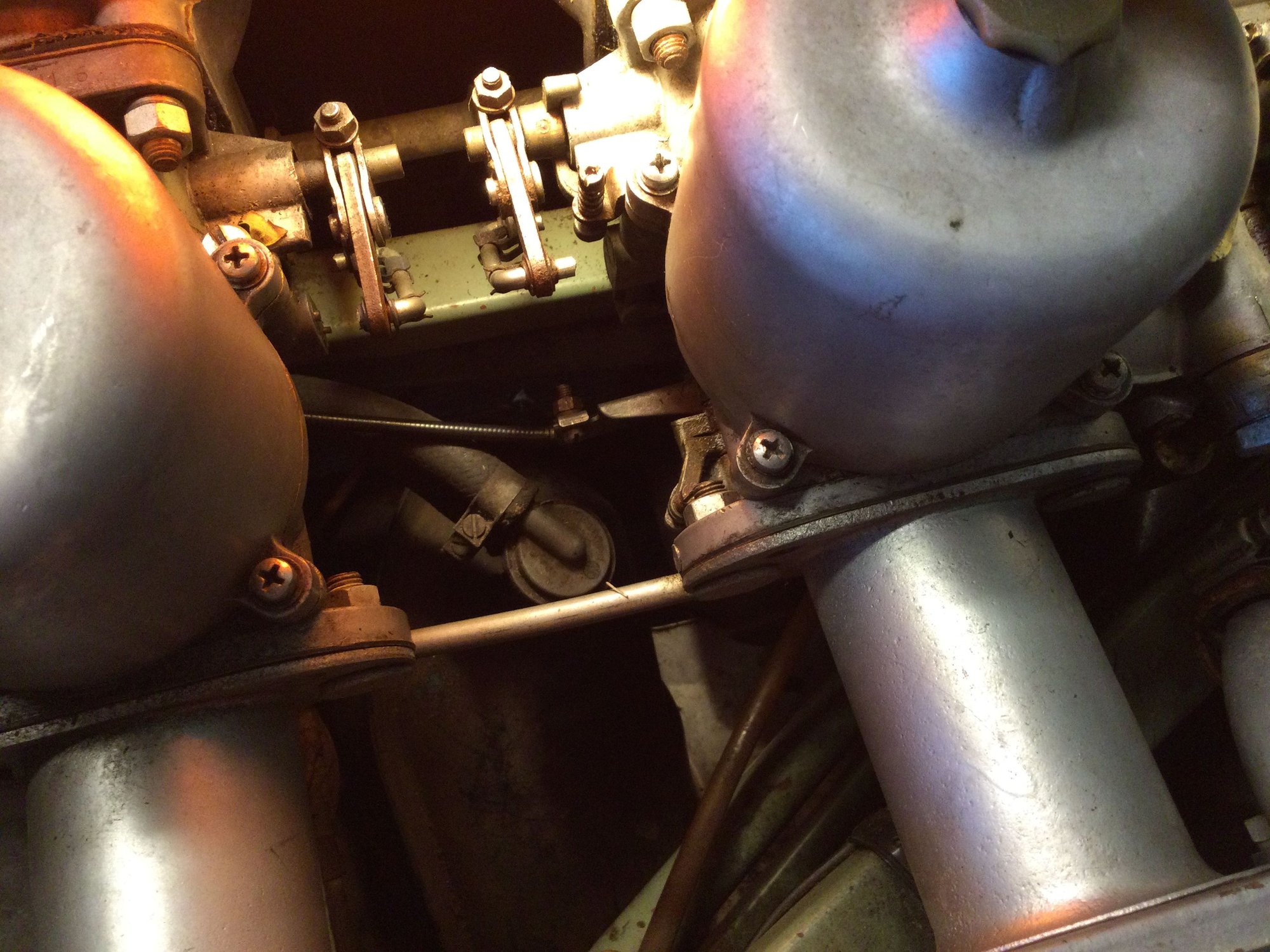

Terry
I have a 69 converted to triple SU and the choke hookup was very straightforward.
I am going by memory here. The Strombergs used two choke cables, I used one and let the other dangle. The SUs had linkage for cable connection. That is the critical part you might be missing.
I will try to get some pictures
Pete

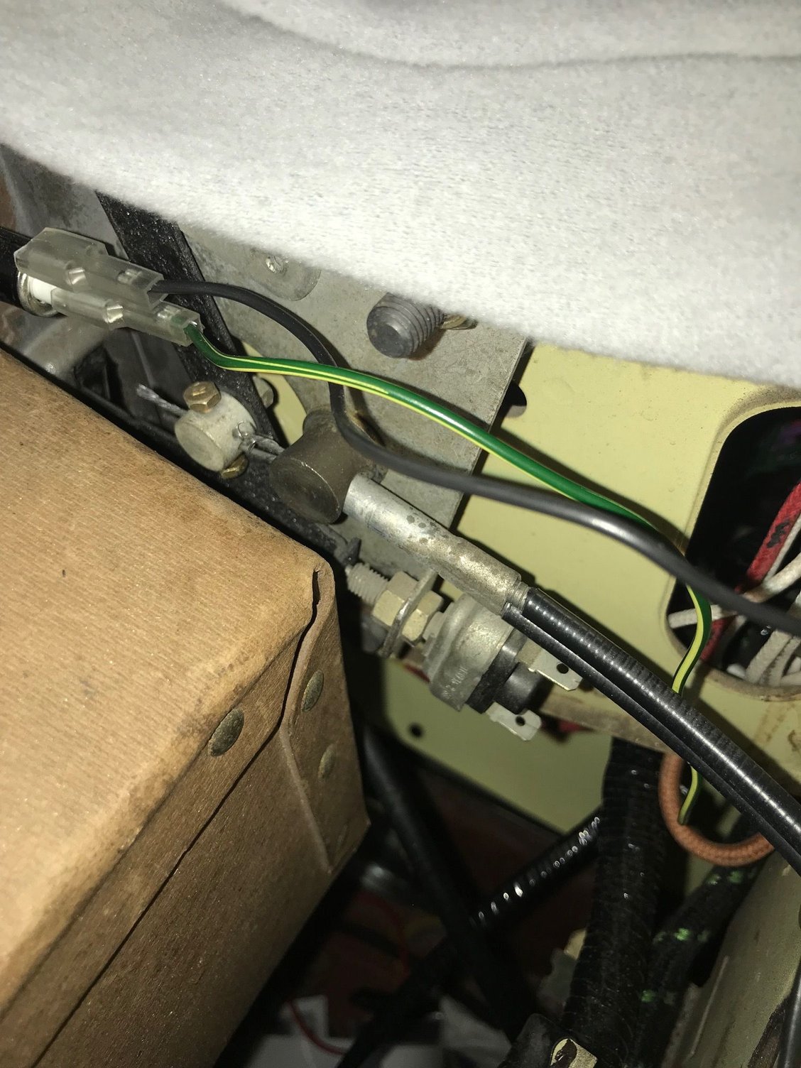

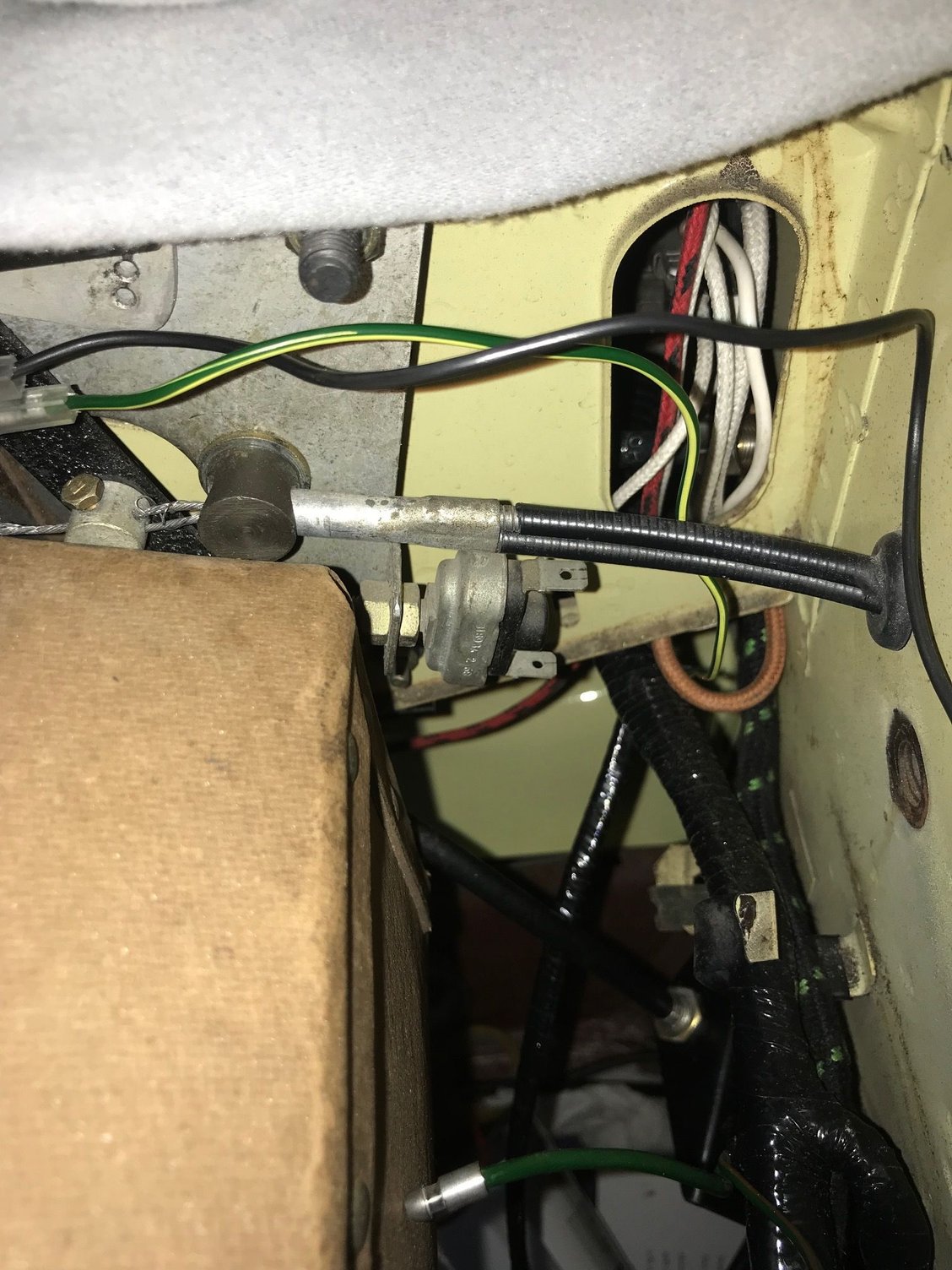

Hi Terry,
Below are two photos of what the choke cable connection looks like at the choke lever. This is a view from the top as my dashboard top is removed. As you can see, even with the dash top off, it is a tight space and not easily accessible. The choke cable liner does not slip off of the silver basket easily. Unless you decide to remove the dash top, I think your best bet for now is to try spraying some type of lubricant inside the cable liner. Disconnect from the carb lineage, find a way to hold the cable in a vertical position and spray some lubricant inside of it. Good luck and let us know if that works.
Bill.

I was very frustrated with the condition of the choke cable at the Carb end, it was severely distorted and the strands had separated. This caused the choke to be unreliable in release..
The solution was simple. I sliced the glove compartment at the top and sides. This gave me access to the lever.
I removed the inner cable and replaced it with a new cable. Repairing the glove compartment was relatively easy, it is cheap and nasty piece of equipment, not worthy of Jaguar.
The addition of a spring to the forward choke lever solved the minor problem of the outer casing distortion.
I could not understand why I could not remove the outer casing, it was seized solid in the lever. The mechanism is not robust and I did not want to damage it by heaving on the end from a very awkward angle.
It all works fine now the tuning is back to good, but will have to wait until Spring for a more detailed adjustment
Bill,
Thank you for the photos, they helped immensely. Maybe you could let me know how the top of the dash comes off. I just replaced a broken windshield washer spray nozzle, my arms are scraped to pieces. Doing it from the access hole under the dash was challenging.
