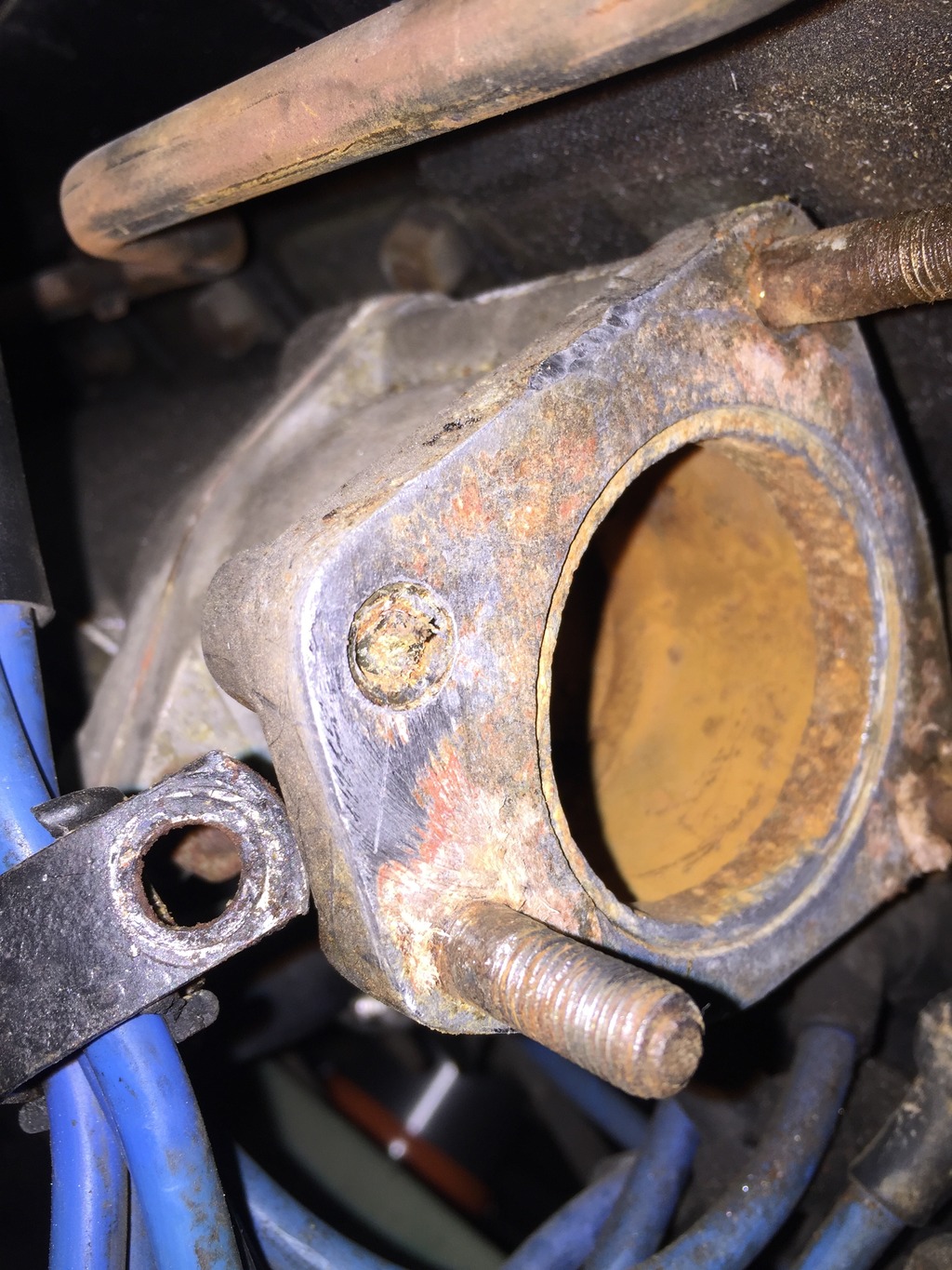

What is this and why is it clogged?

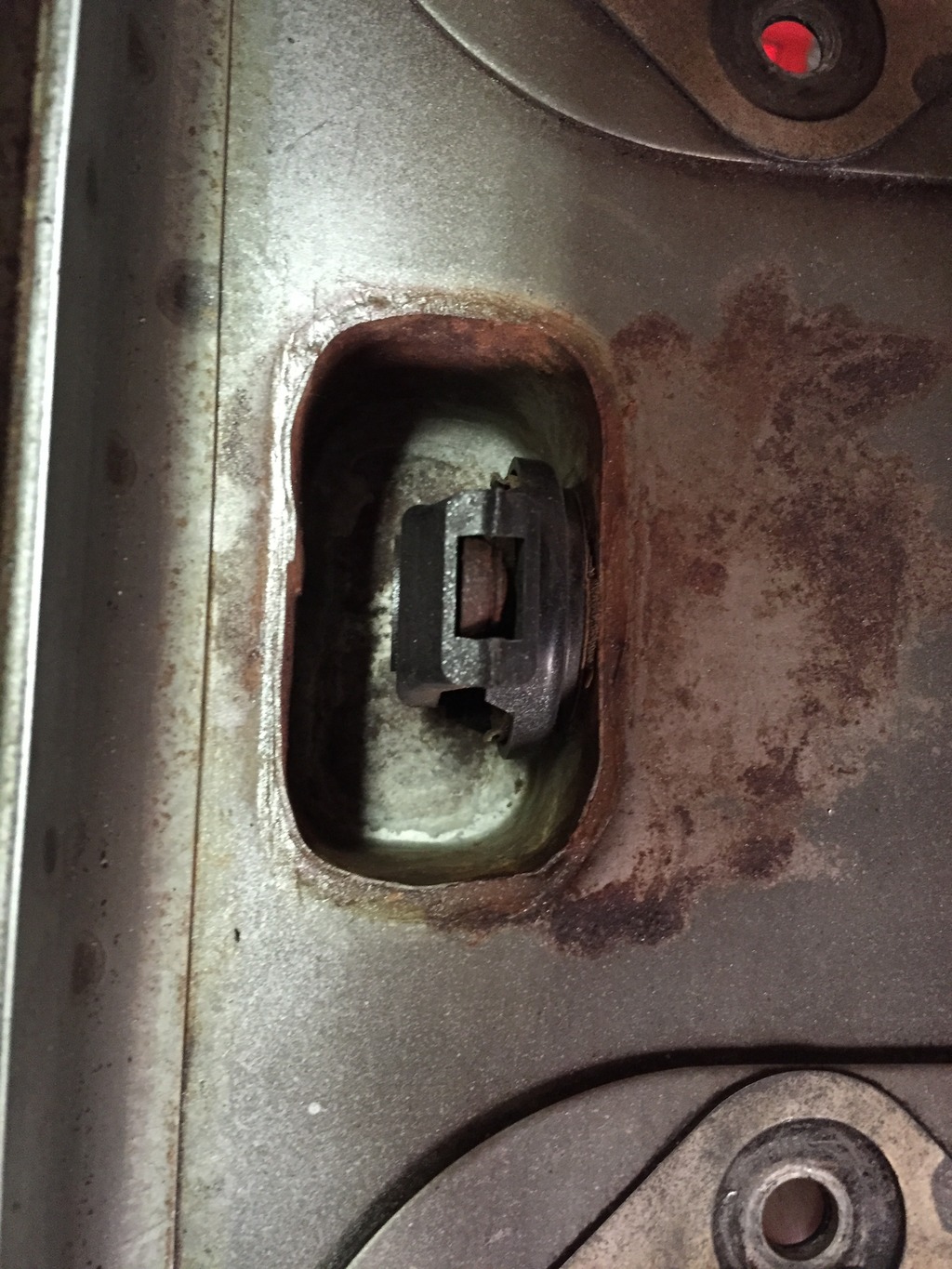

What the hell is this too? Lol it's in the air filter mount for the carbs. It's not hooked up to anything and there's some vacuum thing on the outside of the airfilter cover that wasn't hooked up either

You probably want to pick up the Bentley's manual or even better the SII book from XKEBooks.com. The stuff you're looking at is pollution controls and they were pretty crude and improvised at that time. Here is a doc from Jaguar describing the emissions for 1970.

I am pretty sure this is the device that controls the hot or cold air going into the air cleaner. It should have 2 vacuum nipples, one goes to manifold and the other to the vacuum actuator on the air cleaner.

No vac lines connected to any of those things you mentioned. Would the car run better with them connected?

Maybe when it is cold out, probably not in warmer weather. If below about 50F, and damp, you might get carburetor icing without it.

That's for emissions control and its function is described on the fourth page of the PDF from xkebooks I linked for you in post 6.
