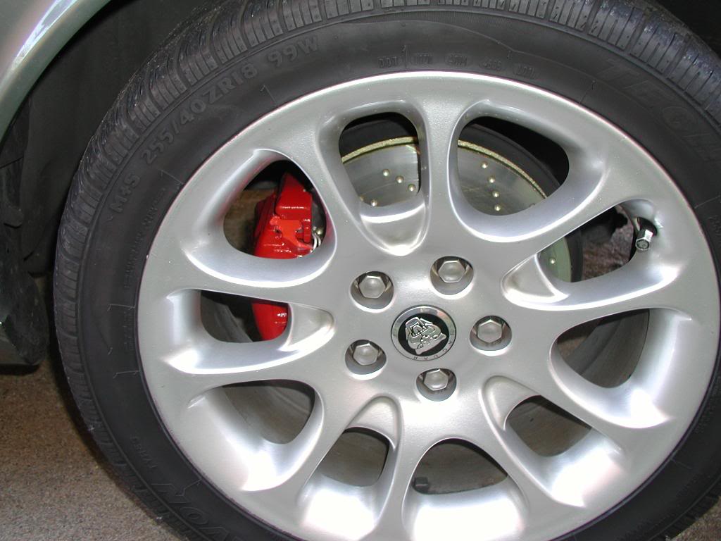

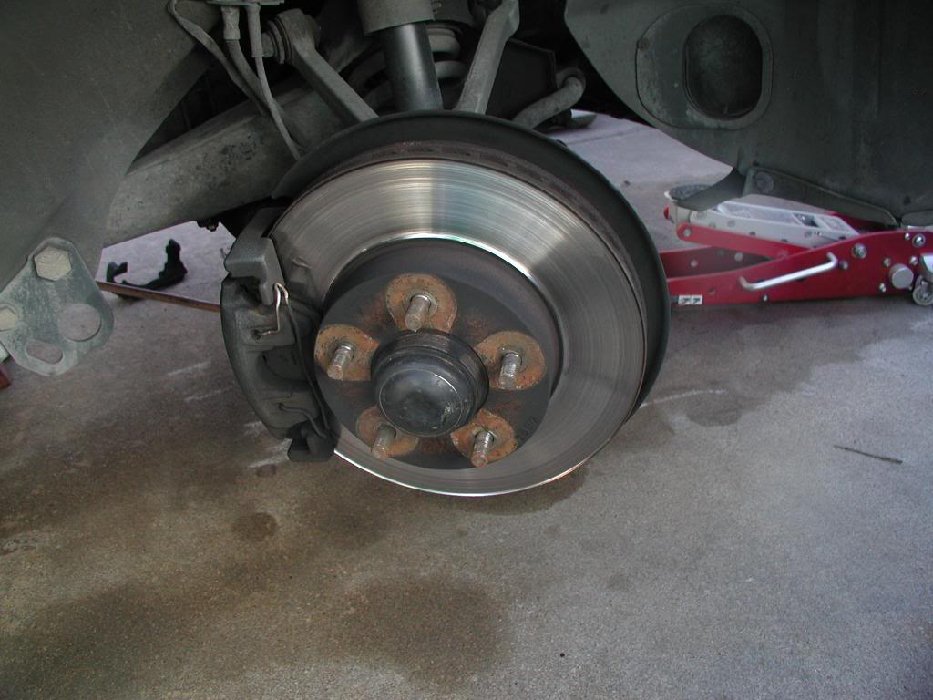

Well this weekend when i wasnt on here, or BBQing, or watching Arizona getting beat. I put new dimpled, slotted, EBC rotors, and red stuff pads. I previously used green stuff and wihile ok I wanted even better braking perf. So moved up to Red Stuuf and theyre alot better for the short driving Ive done(still breaking in the pads). I also gound, scrubbed and thoroughly cleaned the heck out of the calipers and slides. Then painted with Dupli color red caliper paint for that detailed custom performance brake look without the high cost of them...All in all spent $540 for front and rear calipers and rotors, including paint and 12 pack of beer and 2 afternoons..

That looks slick, and draws attention to a really nice set of wheels.
Pic #1 is the example for the "How come they say I need new rotors?" crowd. Those look about 1/4" skinny.

Looks awesome! Got any pics that aren't quite as zoomed in?
