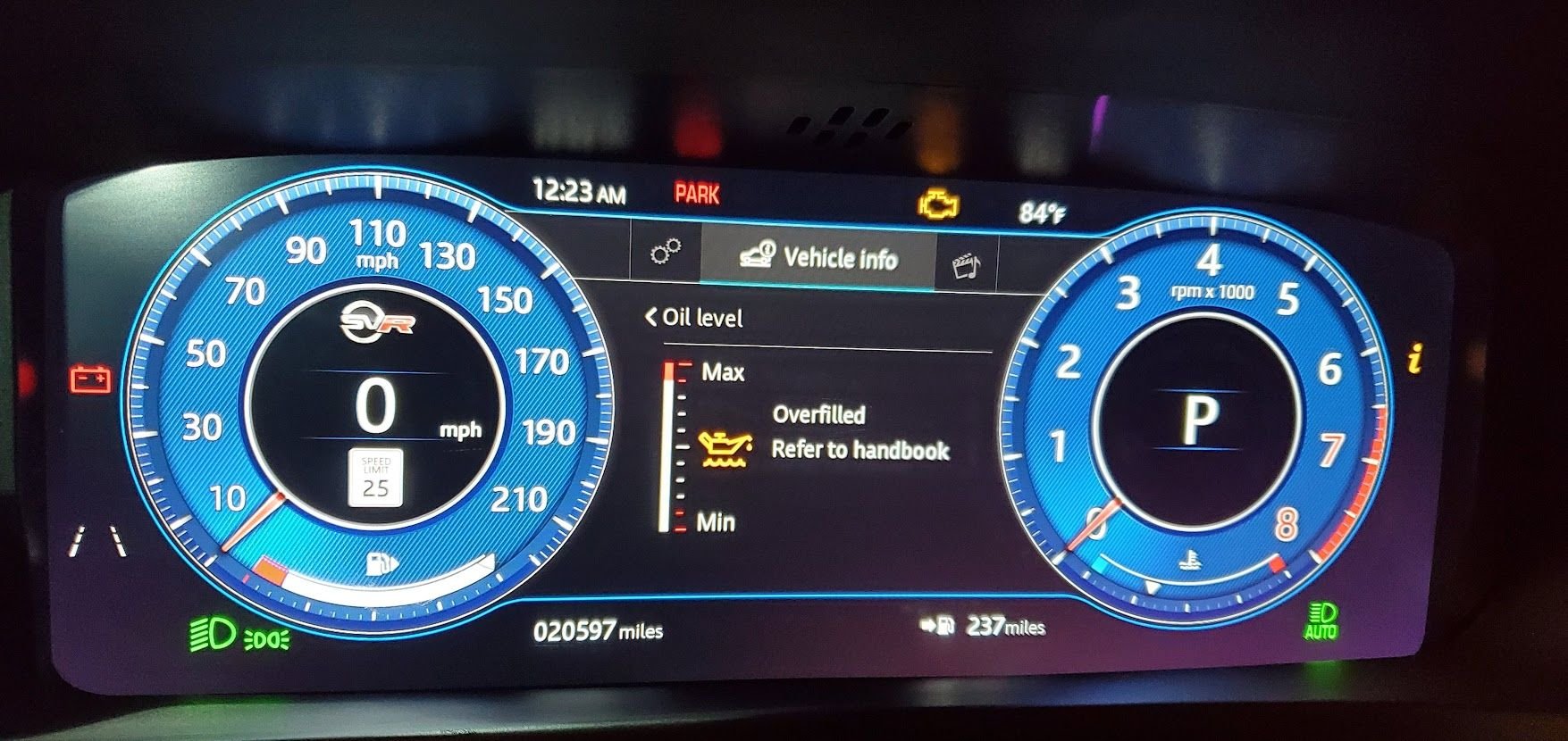

Curious if you were able to do anything about getting the original exhaust sound back, did they ever call you back ? It must've been the Engine Management ECU update that muted the sound ?
I just got my 2020 Certified Pre-Owned SVR from out-of-state and it showed Overfilled when I checked the oil right after I got it. I took into my local dealer and they sucked some out to get back to the OK level.
I made an Appointment for next month since the original in-service date was October 2019 and I'm still going take advantage of the free EliteCare service even though it was just Certified in June 2021.
I definitely want to make sure when it's in they don't apply any software updates to change the exhaust though, the sound is just amazing.
Oil is OK now but this is what it showed the day I received

The F-Pace SVR is AWD like the post-2015 F-Type R and has the exact same engine and sump.
On the F-Type sub-forum there are numerous reports of the "oil overfilled" warning appearing straight after a dealership service, and the cause has been determined as idiot dealerships overfilling. Coz the RWD takes 7.25 litres but the AWD takes 6.5 litres which they ignore or forget or simply don't know and they chuck 7.25 in the AWD, hey presto overfilled!
Moral of the story - if you have an AWD with the AJ133 (or AJ126 V6) and choose to have a dealership do an oil change then double check the oil level straight after, before you drive off.
And plenty of reports that telling them beforehand "remember it's an AWD so it takes only 6.5 litres not 7.25 litres" often doesn't help.

The pans are the same. Early documentation on the V8 was wrong which led to the overfill situations. To be on the safe side, when you get the car back, do a early oil level check through the menu. (And, be sure the car is on level ground.) If there's a problem, you don't want to deal with the aftermath, even if it's "their" problem.
