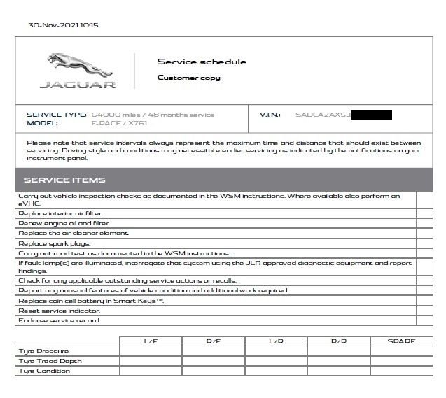

Old Jun 15, 2022 | 08:52 AM
Likes: 17,003
Originally Posted by SlimGoody
When I called the dealership I was told that since I’m over 65,000 miles I would have to pay $750
As your vehicle has exceeded the 16K miles per year for a 12 MONTH time elapsed service interval, it should have been serviced on a MILEAGE basis. This means it's now due the 64K schedule. Here's the relevant check sheet from mine:
I don't see $750 there .........
