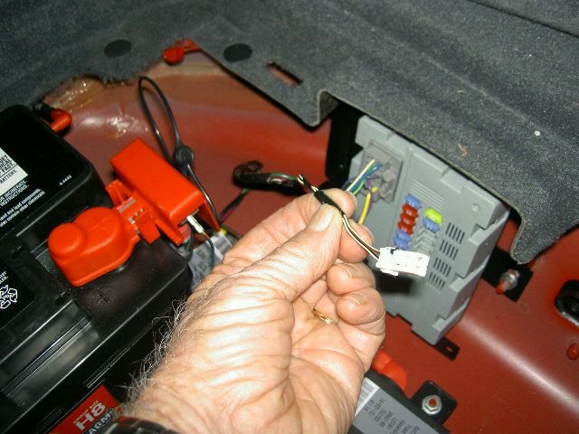

Once again, I’ve replaced the battery, fully charged it(12.75V), loosened ground & hot connections, cleaned & replaced. I’ve gotten this occasional warning off & on since the day I brought the car home! Been to dealers several times and I still have the light.... Does anyone have a possible solution (Other than poor ground or bad battery)?
Found this un-connected wire near the positive end of the battery.. Can anyone identify it? Can’t find a spot for it...

I think that plug is used for initial tranportation and serves no purpose in a running car. Another hope dashed - sorry!

Thanks....
Took a short drive and the damn thing healed itself again! But, then again, it’s English.
