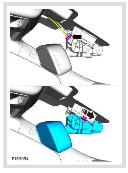

Here's one I wrote just for you
https://www.jaguarforums.com/forum/f...-guide-240020/

I swapped my mirror to the frameless and about a year ago. the plastic cover should separate into 2 in the middle by squeezing or you can try using a plastic pry tool to disengage the little hook keeping the 2 pcs together, its really simple.
FYI, you will no longer have the auto high beam feature if you switch to the frameless mirror because of the electronics (auto high beam and auto dimming) there's only 1 harness and connector that plugs to the motherboard behind mirror which no longer has a seperate mini board plug for the auto high beams camera unlike the original mirror which has has to has 2 seperate harnesses and 2 separate circuit boards for the auto high beam camera and the auto dimming. I chose asthetics over function and gave up the auto high beam feature and kept the frameless mirror.
note, you will need to swap the metal brackets that holds the stem the round ball sits into (the bracket which holds the round ball, it how the mirror stays in place when adjustion a pacticular position) because the metal bracket on the frameless mirror is not compatible with the windshield mount and wont fully slide and lock into into it. you separate the mirror stem from the metal bracket by firmly folding untilt he round ball pops out of socket of metal bracket and you do same with your original mirror and once mirrors are off, mate the frameless mirror with the metal bracket from the original mirror by gently pushing the round ball into the bracket socket until its securely snapped in and its ready to go back on the windshield.
here's some images on how remove the cover

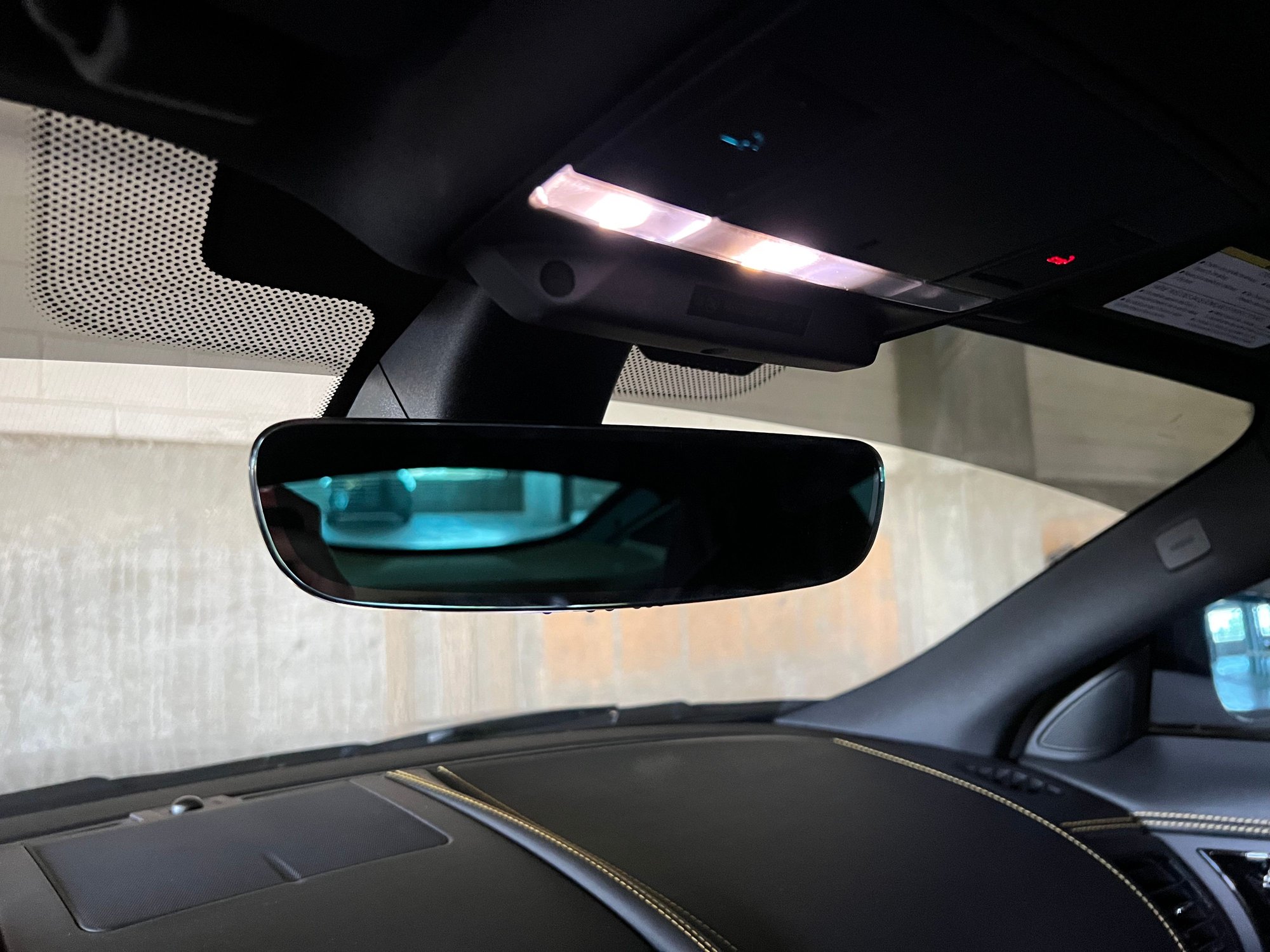

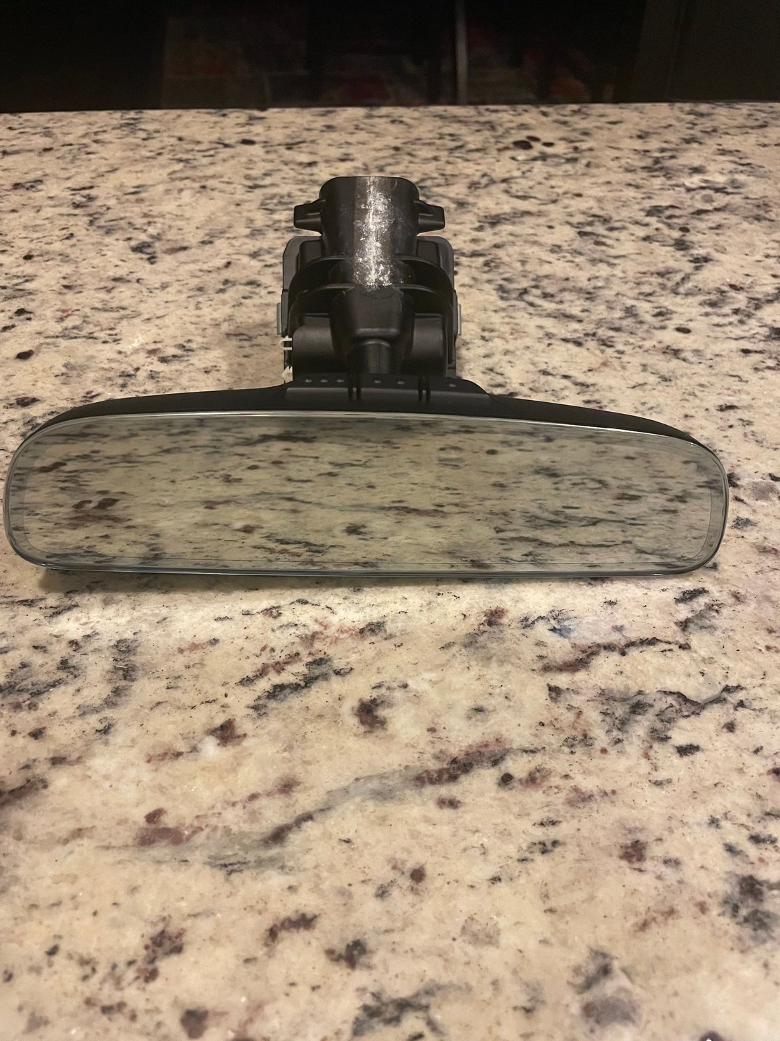

Thanks to all for this helpful thread. Picked up a frameless mirror on eBay that came off a wrecked 2019 XE for $90 and installed it in my 2018 400 sport coupe yesterday. The toughest part was definitely putting the rear cover (one touching the windshield in the back) on. But it is done and I am loving the new modern look without the extra thick bezels. Just a heads up, the Jaguar dealer parts department said that it wouldn't fit cuz it came out of a different model. This isn't true. JLR uses the same mirror between Discovery, XE, F-Type, etc. The connector plugged right in with no issues.
Stock mirror
The "meat". As others instructed, just twist counterclockwise to take off.
Ta-da!
