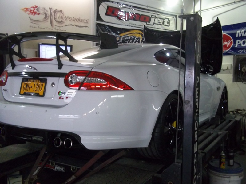

Here is some info on a 2014 XK-RS GT that we did back in 2014. Keep in mind that the car started with 550bhp rating from Jaguar. This received our upper pulley and tuning. This shop was selected by the customer and installed our pulley.
I had another customer in NY that just installed the upper pulley on his 2010 510bhp XKR and he reported that it gave him 30 rwhp. Unfortunately, he faxed me the dyno sheets and I have misplaced them. I think 30rwhp is a very strong #, but I can see 20+ rwhp gain.
Mike
