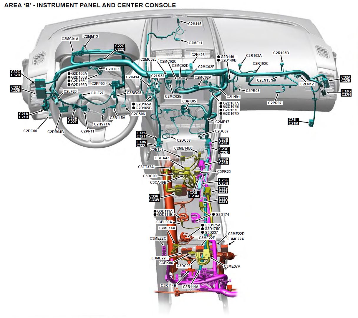

Referring to the electrical schematics for the X152 on TOPIx the position sounds like somewhere approximate 10cm under connector C2H415, which would place it towards the rear of the evaporator housing but just on the inside of the chassis bulkhead. I have attached an image to show the area on a LHD car.
