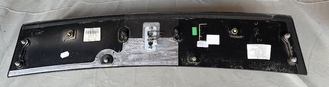

Here is a pic of the complete antenna panel from the coupe that must be removed. Note: there are (6) 10mm nuts that have to be removed before you can pry the panel up from the plastic clips. (2) nuts are openly accessed from the top edge of the rear hatch, and there are (2) more nuts on each side of the edge of the hatch underneath a small pop-out plastic cover.
DO NOT CUT THE DATA CABLES TO REMOVE THE COVER PLATE FROM THE CAR (this was a spare plate I received from a junkyard, removed from the donor car in haste). Proceed to additional steps below for data cable disconnection.

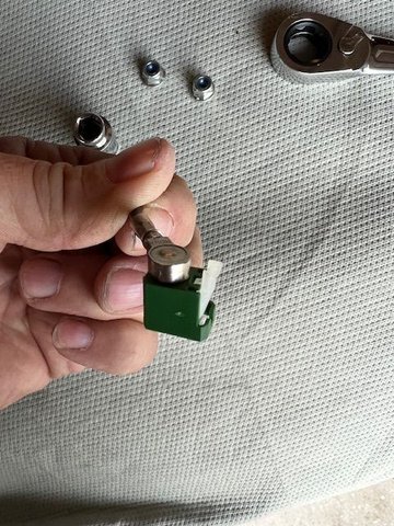

To remove the data cables, you must first access the white release tab. In my case, I had to rotate each cable to get to the release tab ....

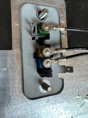

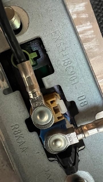

You will have to pull each white tab up in order for the data cable to release and allow its removal from the antenna

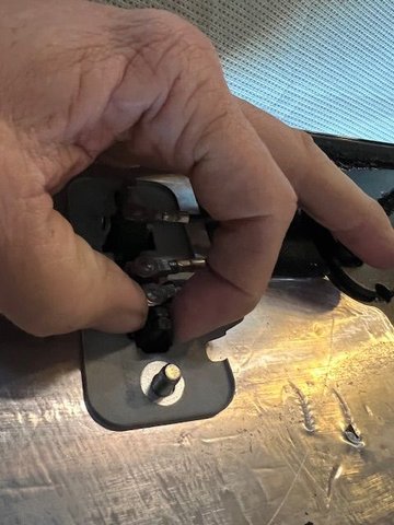

After removing the cables and the (2) 10mm stud nuts, you will see a pair of black tabs that must be squeezed together in order to allow the meatal base plate to be removed.  Once the plate is removed, your antenna unit will be free to replace.
After removing the cables, the entire panel can be removed from the car. Once panel is removed, loosen the (2) 10mm stud nuts from the frame assembly.... then you will see a pair of black tabs that must be squeezed together in order to allow the metal base plate to be removed by lifting it off the studs. Once the frameplate is removed, your antenna unit will be free to replace.
