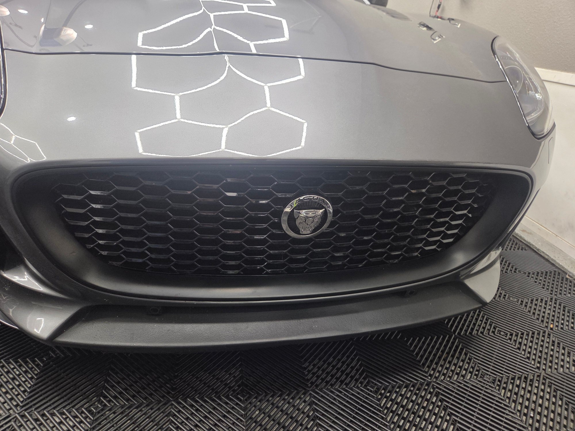

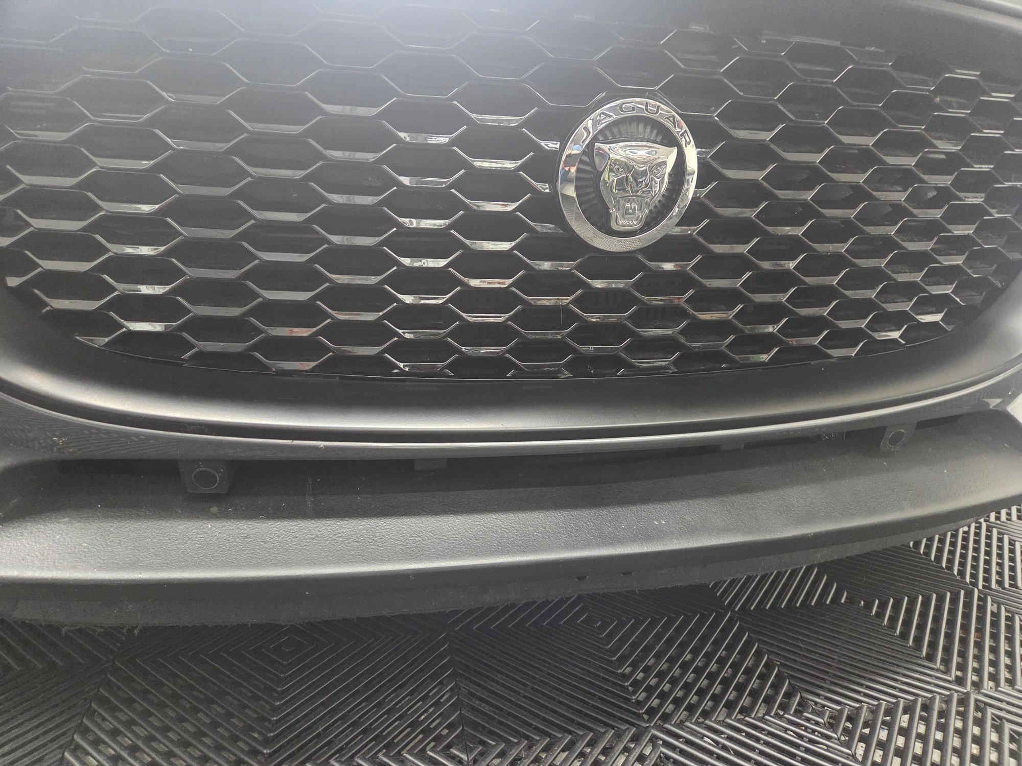

P7 style front grill.
I relocated the parking sensors. I never use them butb they seem to work ok.

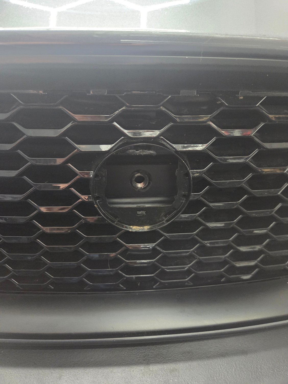

I made the emblem removable and installed a spot for a tow hook behind it.

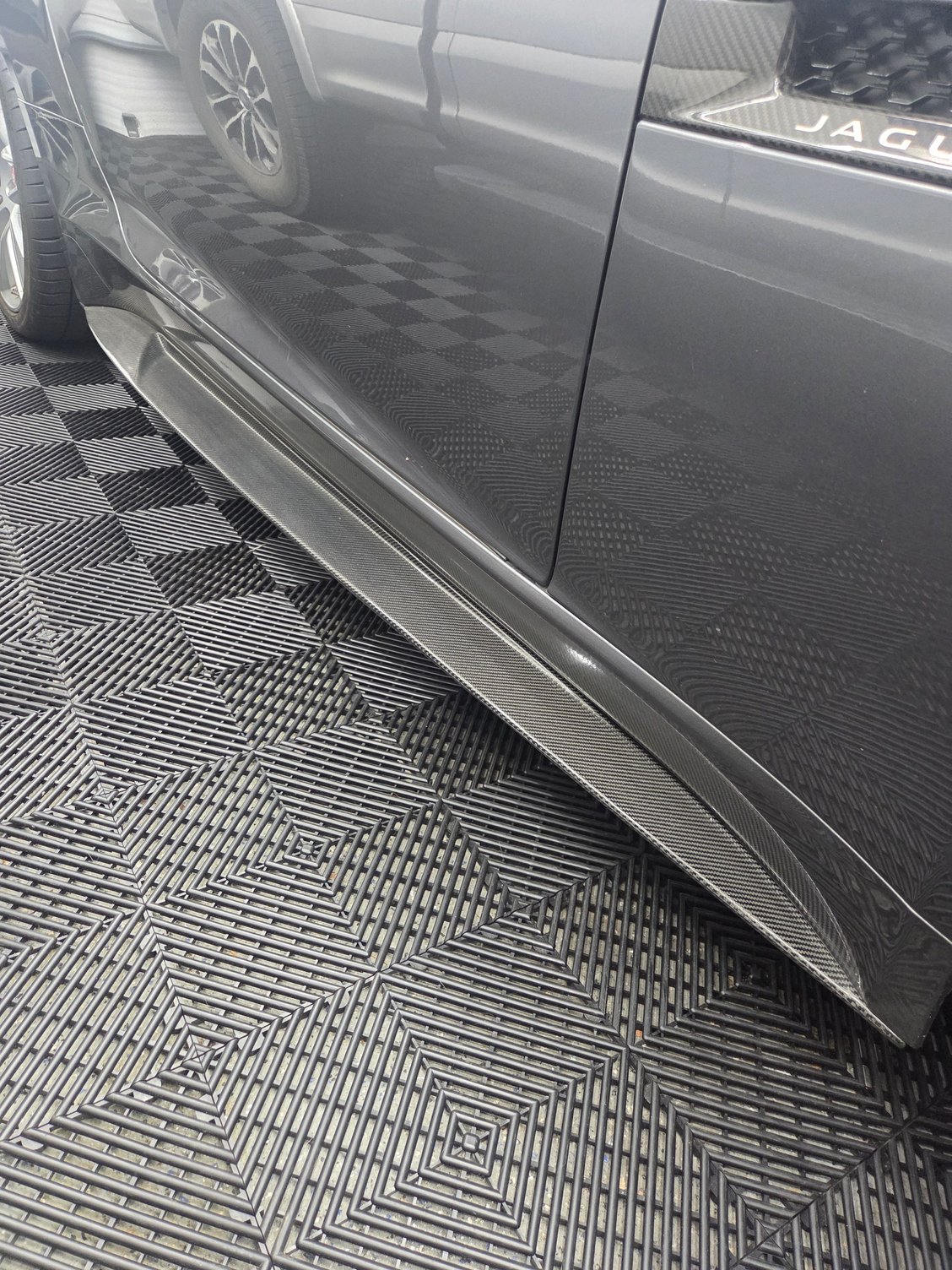

Carbon fiber side skirts. This was a bigger job than I thought it would be butb they came out well.

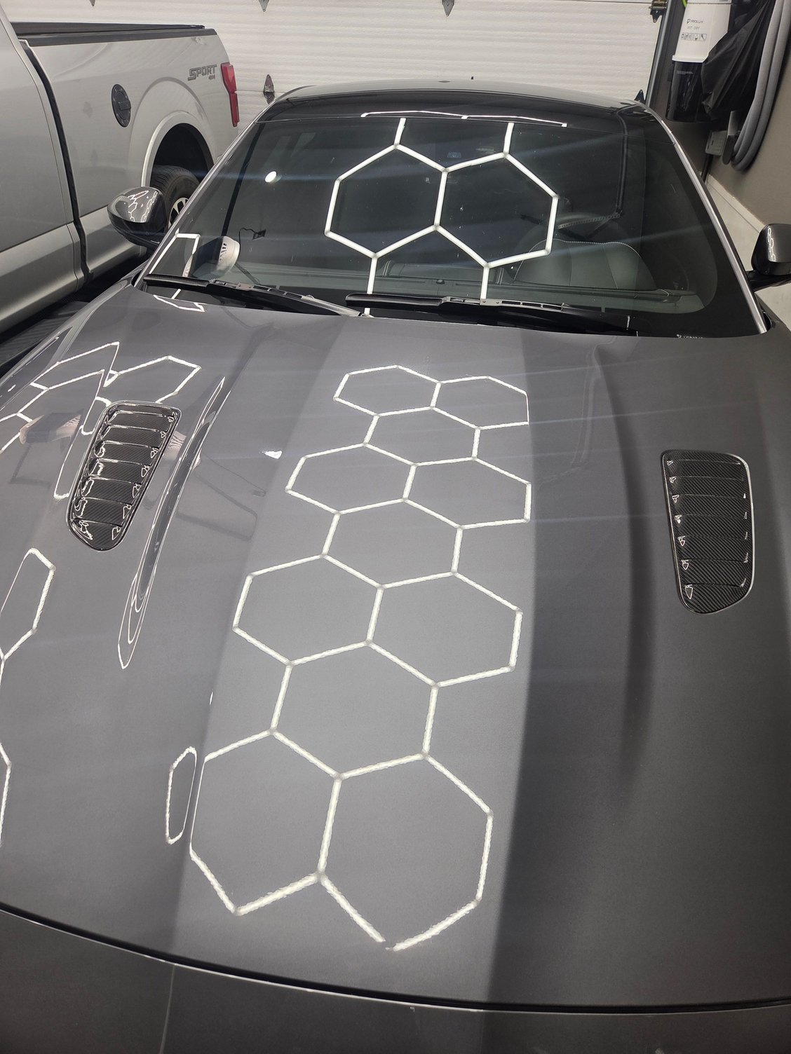

Carbon fiber hood vents from Mina Gallery. I made custom brackets to install them vs double sided tape.

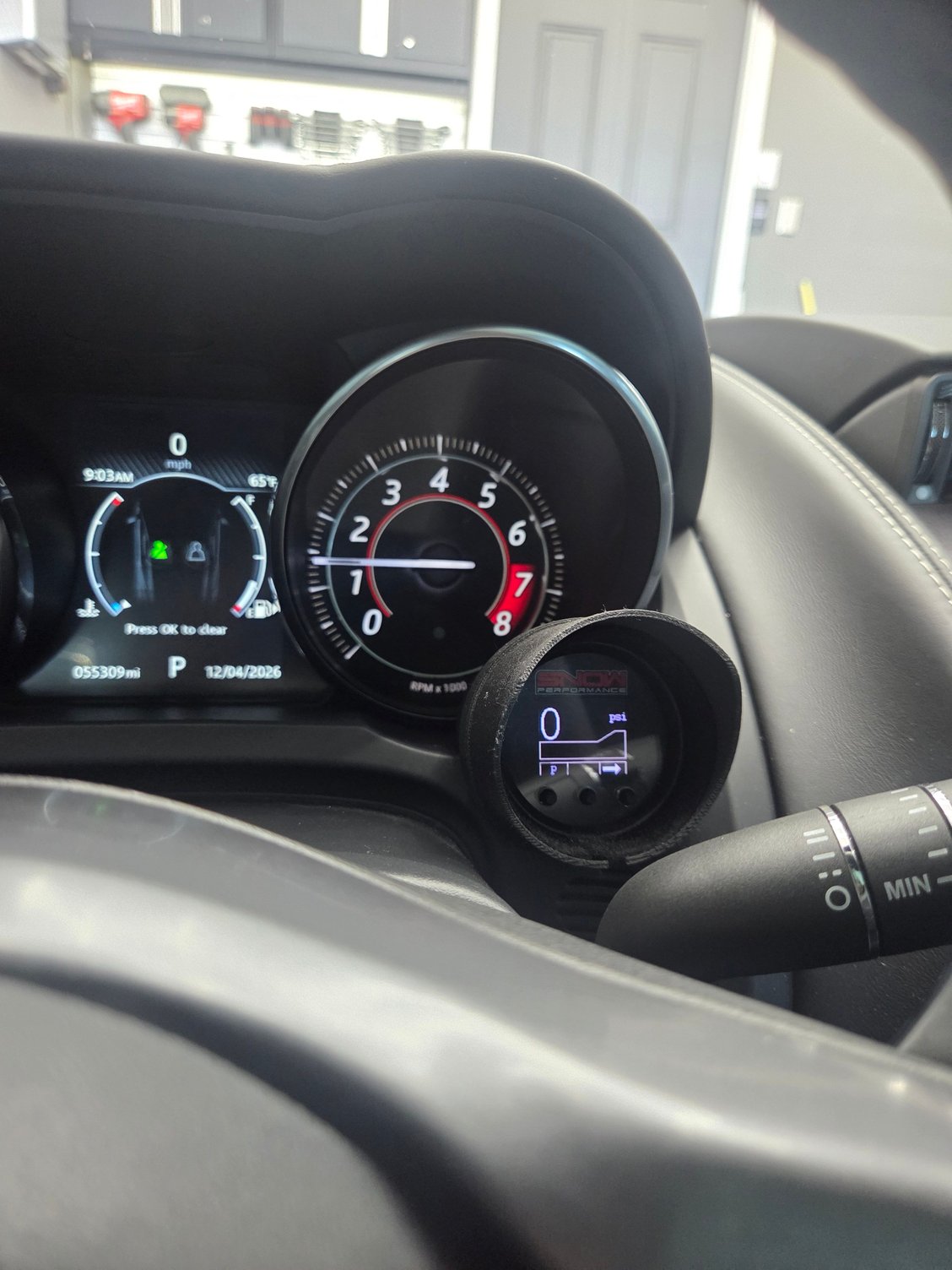

Snow Performace water meth control mounted by instrument cluster.

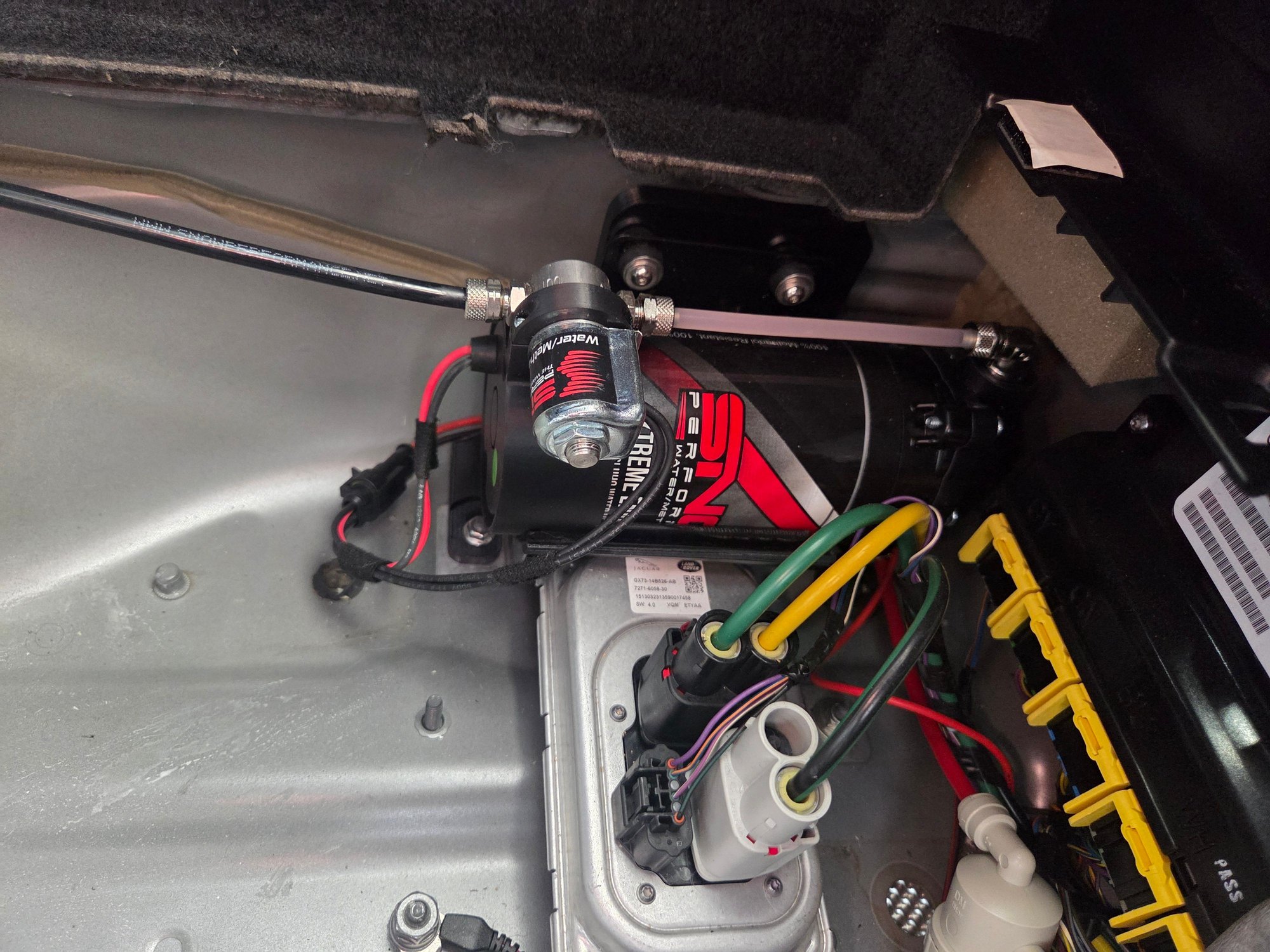

Pump for water meth located in trunk.

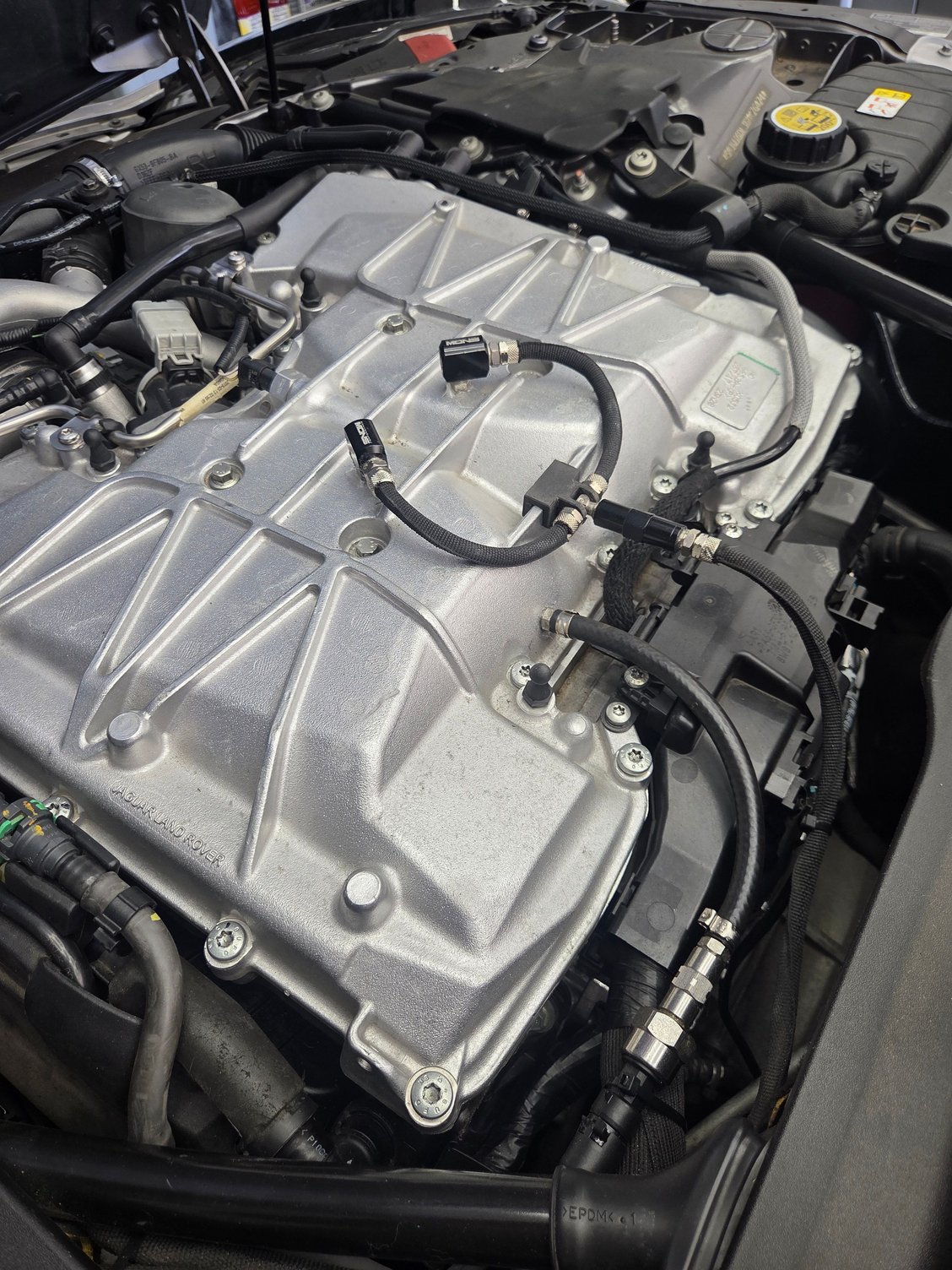

Water meth injection ports.

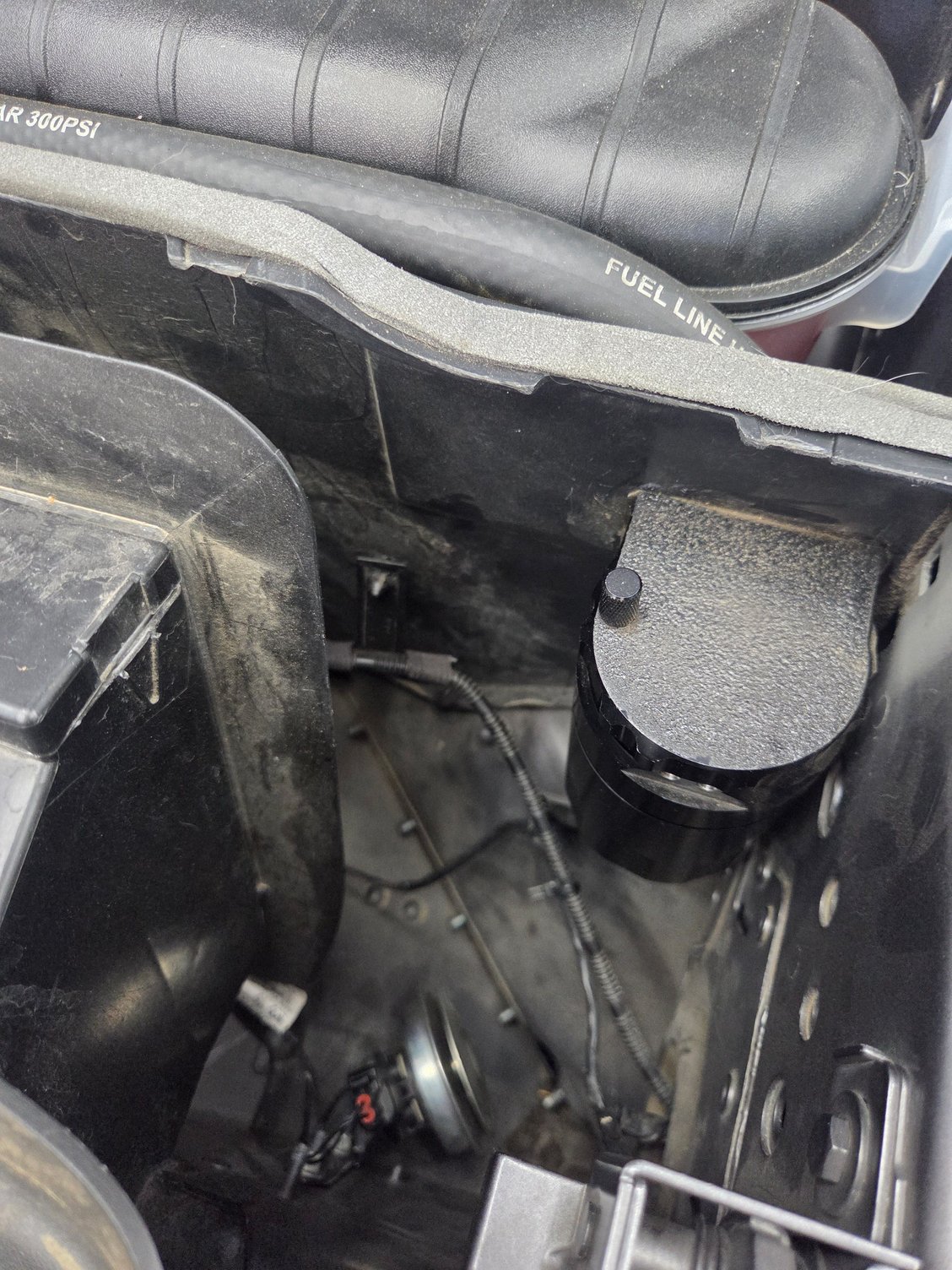

Oil catch can.
Oil catch can.

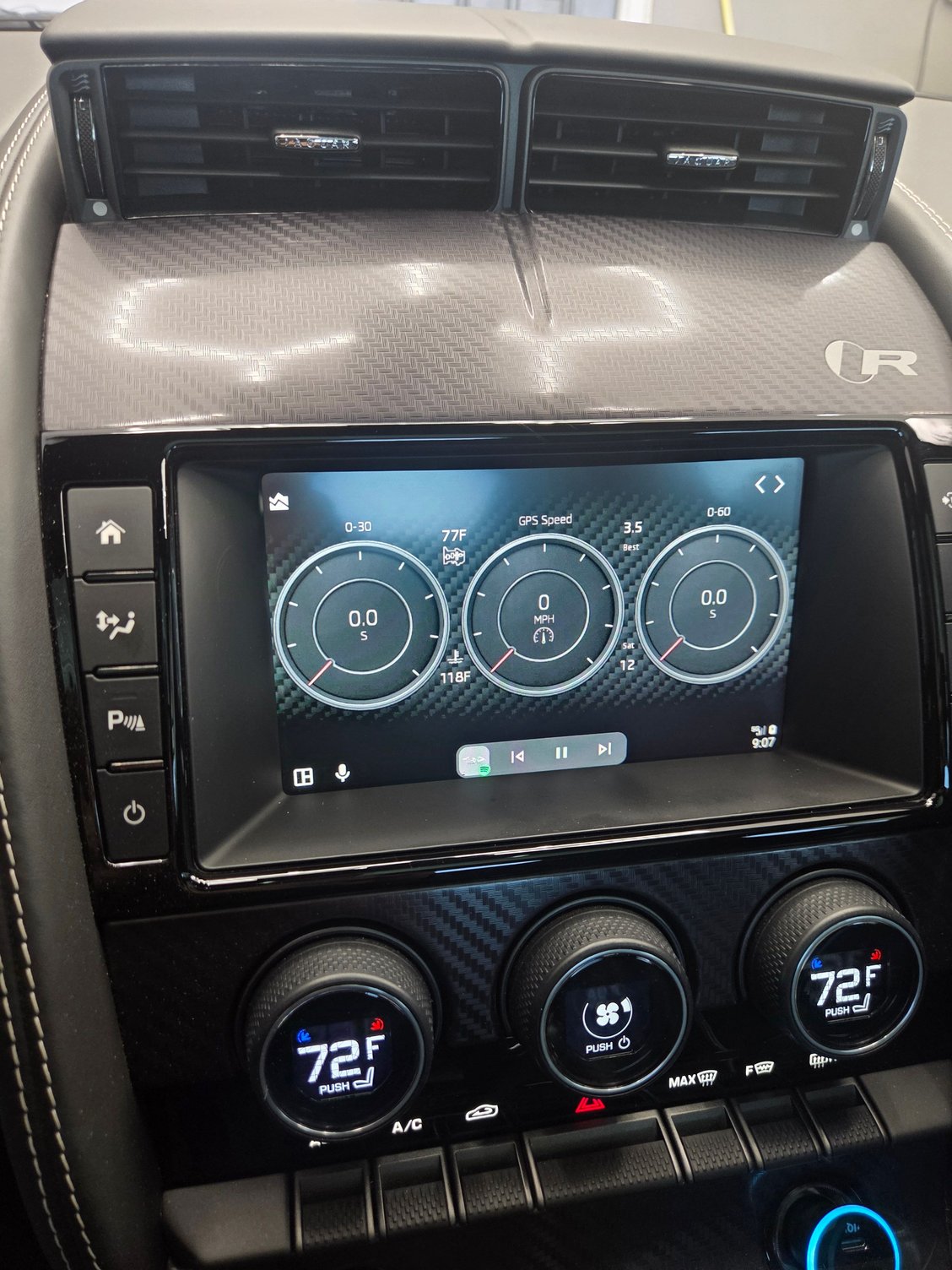

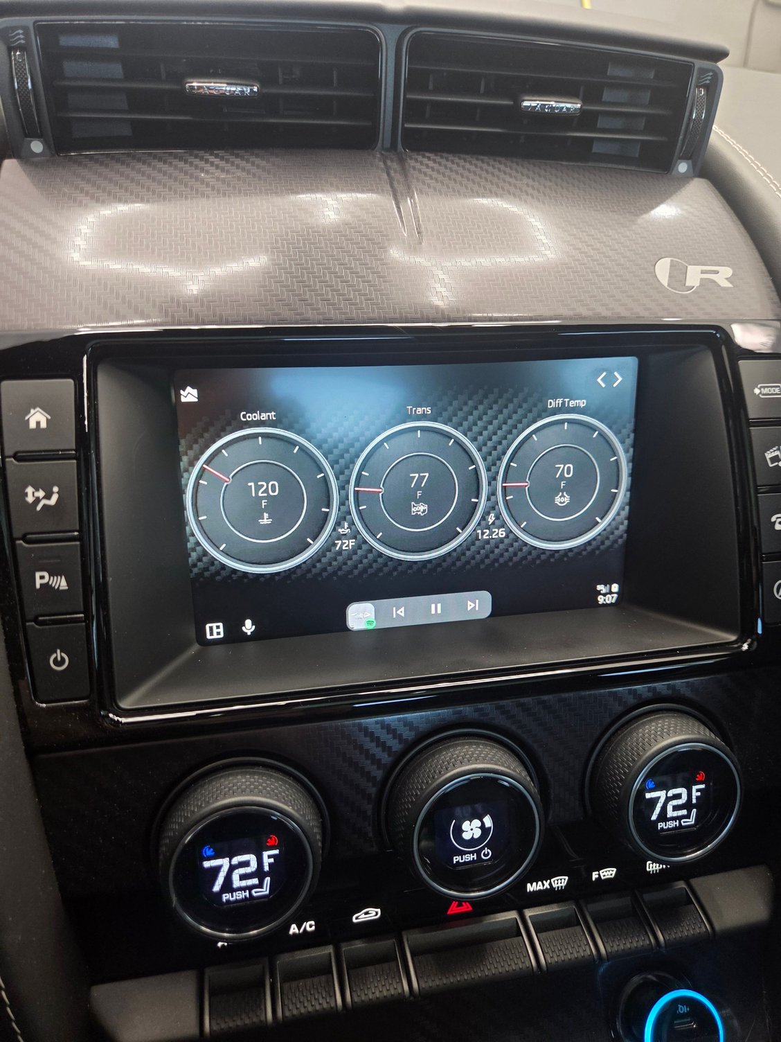

Gauge setup on android auto.
Another screen on the gauge setup.

Which gray is that? The bright wheels look great with it.
And your overhead lights make interesting reflections.

It's the ammonite gray metallic. I was originally looking for a silver but this one looked good especially with the wheels. They're the hexagon lights. Wasn't sure how much I'd like them but they've been really nice to have.

@JagCNC could you provide more information on the gauge setup under Android auto? How did you implement this? This is there an app on Android auto that produces this display? Thanks in advance!
Old Apr 13, 2026 | 10:28 AM
JagCNC's Avatar
Joined: Oct 2024
Posts: 18
Likes: 18
From: Colorado
The app is on github. I use a Samsung S20 mounted under the center console lid. Aatorque supposedly doesn't work on anything above android 13 although some people have succeeded. The 0-60 timer is part of a custom adapter I made that includes on board gps.I had to make a custom adapter because my car suffers from the obd port battery drain issue. Here's the
link for AATorque https://github.com/agronick/aa-torque.
