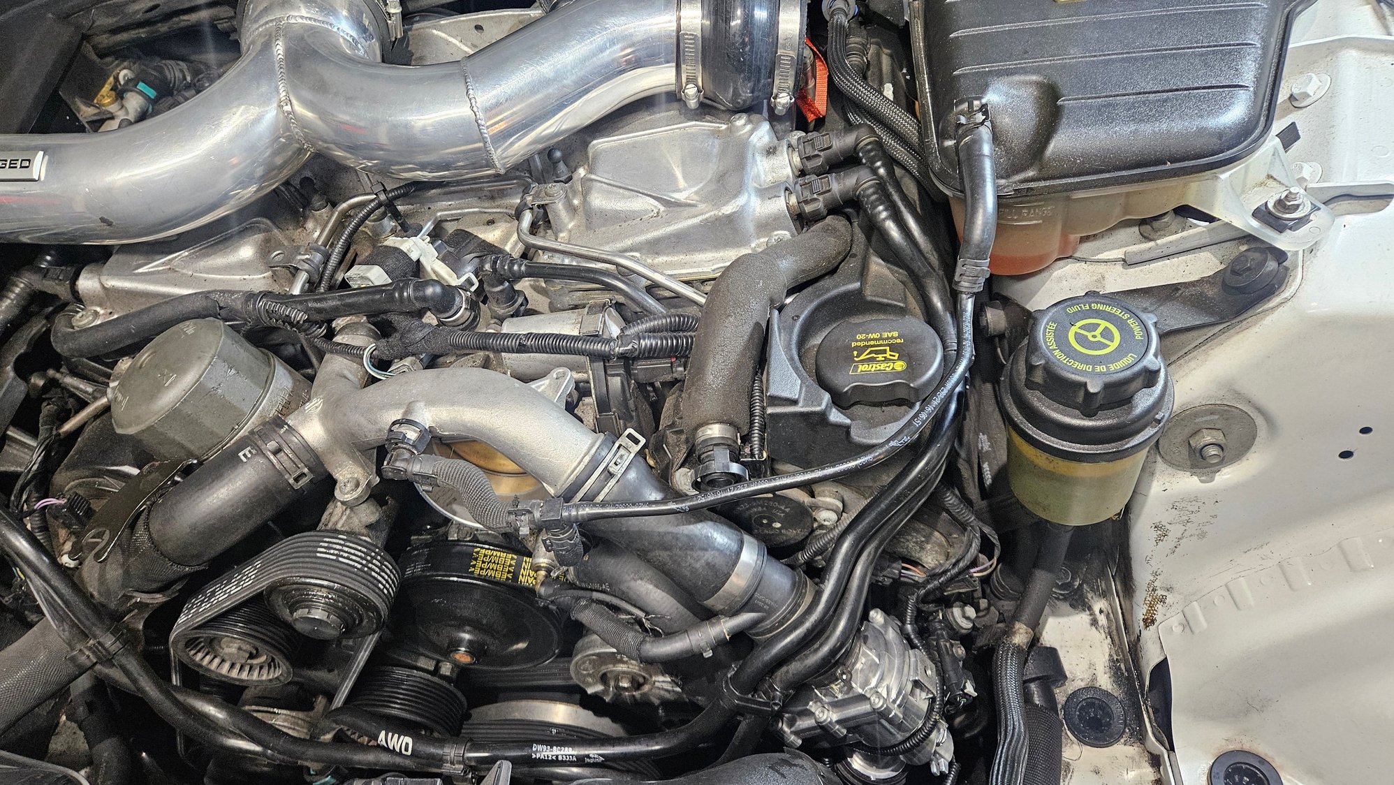

I'm going to be replacing the coolant pipes in my 2016 F-Type R. I have about 44k miles and I don't see any indication of a problem yet, however I want to avert disaster so I'm replacing them now. I bought metal pipes to replace the plastic ones. I'm looking to tackle it this weekend. I've seen some really great info and videos on this so I'm good there but here's my question. Is it a good idea to disconnect the battery for this job. I know a lot of these cars continue to communicate with modules even if the car just sits and with some cars if you don't disconnect the battery as you start disconnecting sensors you will throw a code as the computer doesn't understand why things are disconnected.

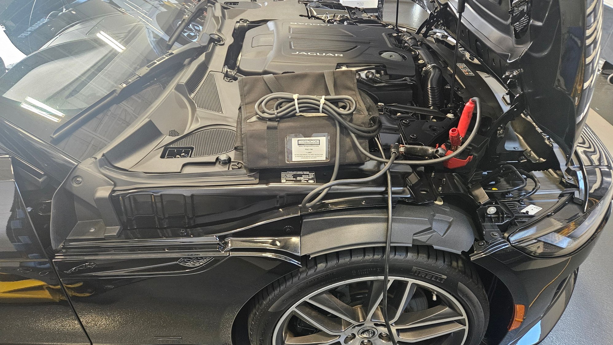

NEVER EVER DISSCONNECT YOUR BATTERY .....PLEASE! Just a heads up ,I've done many many cooling pipes installs

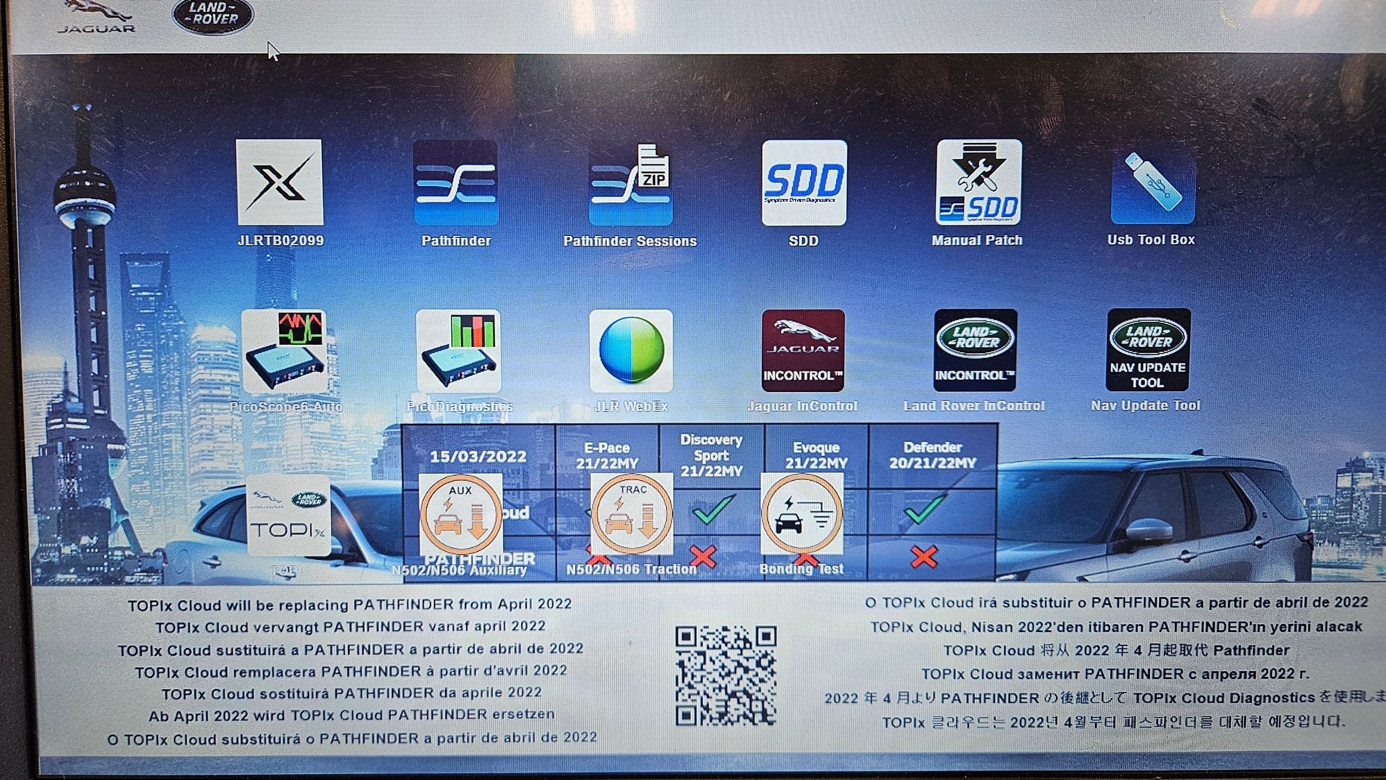

Only reason is if it did not shutdown fully ,alot of modules may fry ,(Kwm,rf Bcm modules) a common problem with newer cars ,you may get lucky just a heads up,I've had to replace a few modules on some members cas here on the Forum and program them with SDD, if you have any issues I'm here to help
