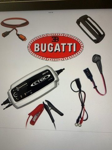

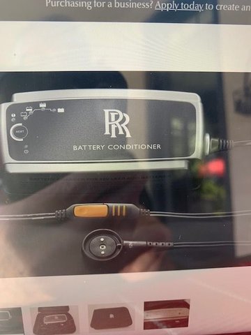

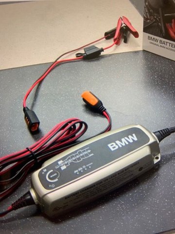

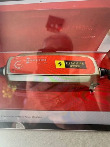

Clarification: You do not need to disconnect the battery when using a CTEK unit - but using a battery CHARGER (as opposed to a battery maintainer like the CTEK) it is safer to charge a dead or near dead battery isolated from the car's electronics.
For those who might think that this is a "Jaguar thing", a bit of proof that other cars also need the CTEK treatment in dealing with their electronic needs:
Lamborghini:
Audi:
The obvious one:

Even Rolls Royce:
This is my favourite example: the CTEK unit has morphed into a Ferrari genuine part!:
