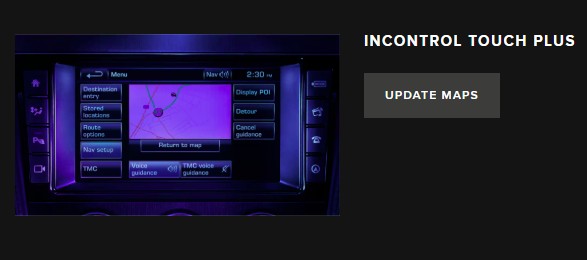

This is a graphic of the ICTP in my car:

That's the same system I have in my 2017 SVR. I thought you ordered it via a usb stick and plug that into the usb inside the center armrest console? Ordered via the Jaguar.here website.
Sounds like maybe there is an issue with it not recognizing your vin?
