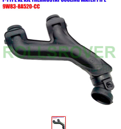

1. if it still has the 'flanged' heater pipes. You can tell by the top one in the engine compartment. The SC has to come out to get to the lower pipe... expensive work. These original pipes were seamed and heat glued, They often leaked and the coolant destroyed other engine components.
