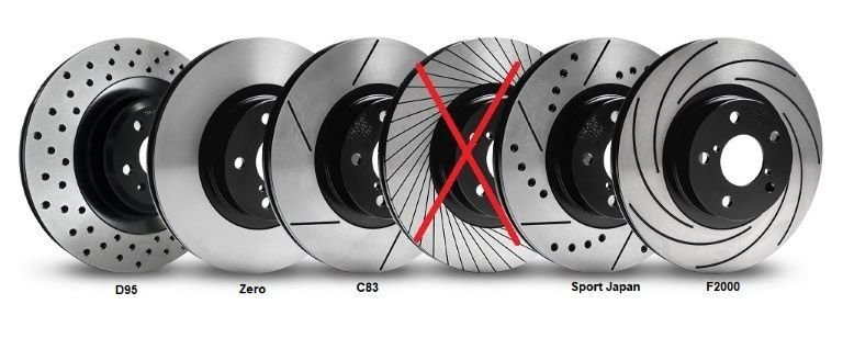

Tarox produce 380mm front discs in one (Part No 0438) or two piece (Part No S3-3262) configuration. These are also available in five 'styles', curved groove, straight groove, drilled, drilled and grooved or plain. The two piece front discs provide comparable weight savings to the VAP/Girodisc offering, coming in at 13kg (29lbs) each.
Although not listed for the F-Type on Tarox website, they do produce a 376mm rear disc for the XF (X250), Part No 0437, which is a direct fit for the F-Type.
Tarox discs are not 'cast' and machined in the conventional way, they are CNC milled from a solid steel billet. Quote “Using only the finest materials, each TAROX Bespoke disc is machined from a solid billet of high-quality European steel, which is then heat treated for extra strength. Our steel has an ultimate tensile strength (UTS) of 57kg/mm2. Using CNC technology, each slice of billet is machined into the exact dimensions required to ensure a perfect fit for each application. Vented discs are manufactured with curved internal ventilation, utilising 20 directional ‘venturi’ vanes which accelerate hot gasses and aid heat dissipation. Composite brake discs that require a two piece configuration receive a hub section machined from 7075 billet aluminium which we hard anodise for protection from the elements”.
Widely available in USA and Europe.
