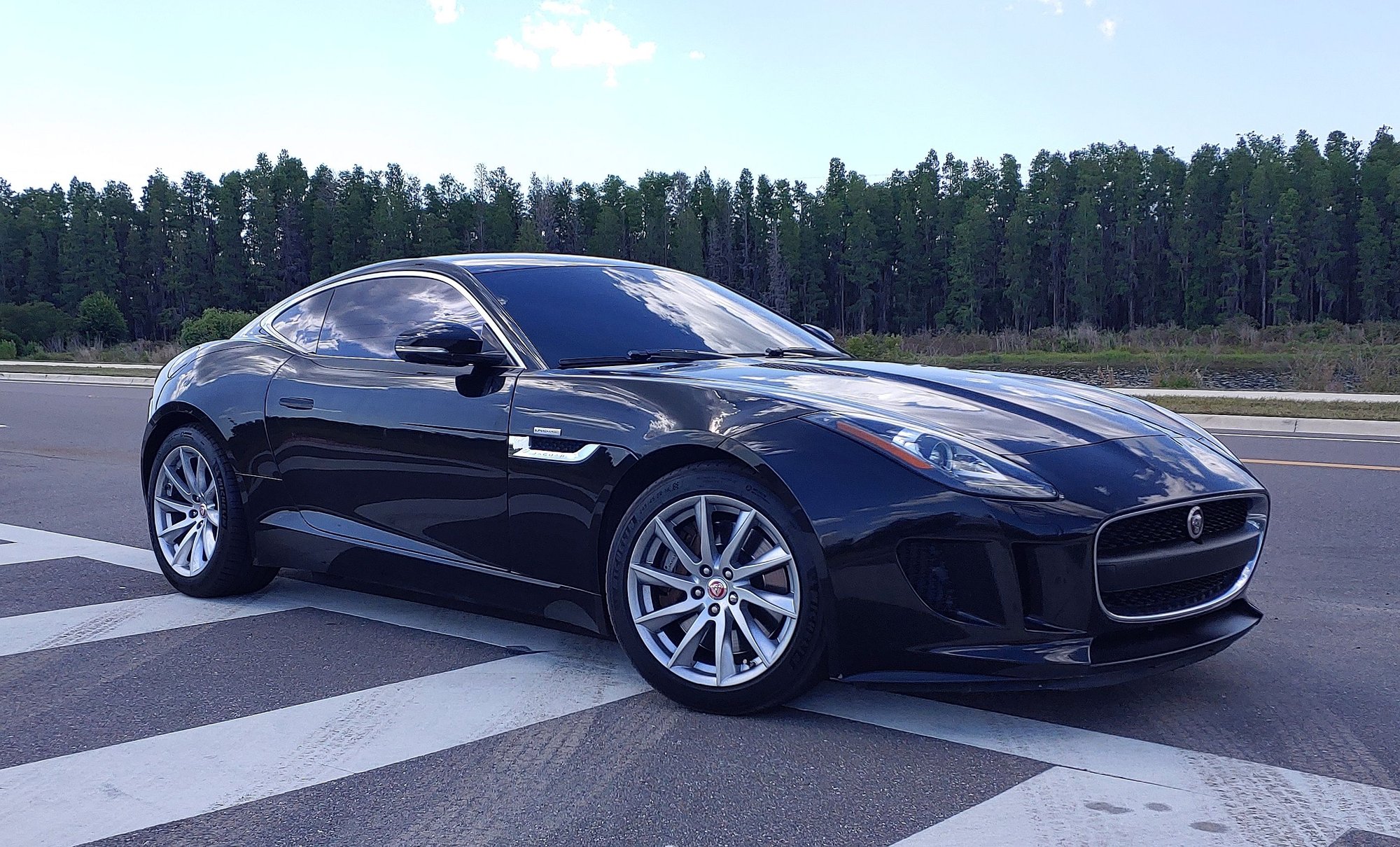

FTypeInTheSun's Avatar
Joined: Oct 2025
Posts: 35
From: San Jose, California
This has all been so helpful, I really appreciate all of the help here!
Would anyone be willing to take a look at the car I'm considering and let me know if they're are any flags or things to consider specific to this car?
Thanks again!
Old Oct 22, 2025 | 02:27 PM
6MTFType's Avatar
Joined: Nov 2024
Posts: 29
Likes: 8
From: Portland, OR
Great color and love the license plate. Price is high, with some gaps in maintenance in recent years. I’d have a Jaguar dealer or independent shop that specializes in Jaguar do a thorough presale inspection. Close look at coolant pipes and all the regular stuff. It’s an early car, I believe, so there may be bugs that were worked out on later production units. Overall, could be a deal at $25K but unless it gets a perfect bill of health I’d recommend looking elsewhere.
Old Oct 22, 2025 | 02:32 PM
Joined: Oct 2025
Posts: 35
SUPER helpful, thanks so much for the second opinion!

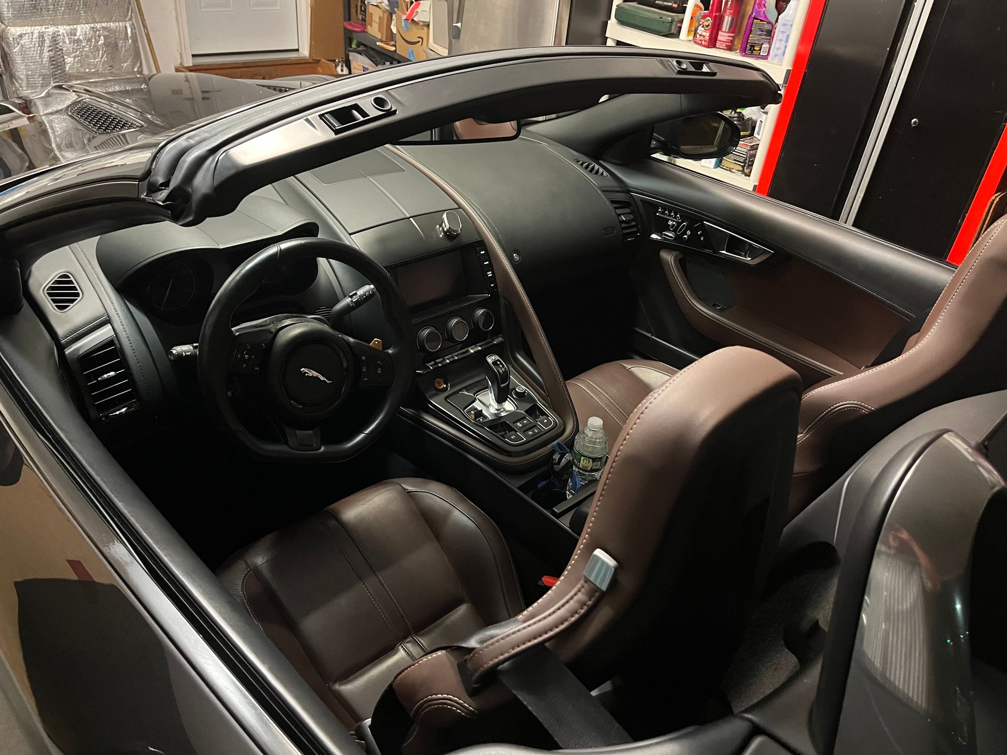

Listed on Autotrader last week, $28,900. I'm located in Blue Point NY. I can send whatever pics. Just recently spent $1300 on tune up, plugs filters. I put 3,000 miles on it in past 3 yrs. Winters it is garage kept. This pic is from Carvana, post, still looks the same
Old Oct 24, 2025 | 10:22 AM
WTC3super's Avatar
Joined: Jun 2025
Posts: 8
From: Suffolk NY
The pic I just posted is from garage, the first pic was a Carvana pic. Car is metallic Gray with black top, brown leather seats. Has all the bells and whistles. Everything works, type S, 380 hp motor. The only reason I'm selling is every 3 yrs I usually purchase something different. Before this I had a 650 BMW convertible and before that MB convertible, and so on.

After lots of research ( ummming and ahhhhing ) I'm about to pull the trigger on this car. Any final alarm bells I should be aware of based on the carfax report? The high(er) mileage concerns me a little bit, but as someone who will put ~6000 miles a year on it, maybe it's not that big of a deal. Thanks again for all the help along this exciting journey!
Old Oct 28, 2025 | 01:14 PM
6MTFType's Avatar
Joined: Nov 2024
Posts: 29
Likes: 8
From: Portland, OR
Hate to be a downer, but price + accident + spotty maintenance records make me declare this a “pass.” I think you would be better served to continue the hunt a bit longer.
