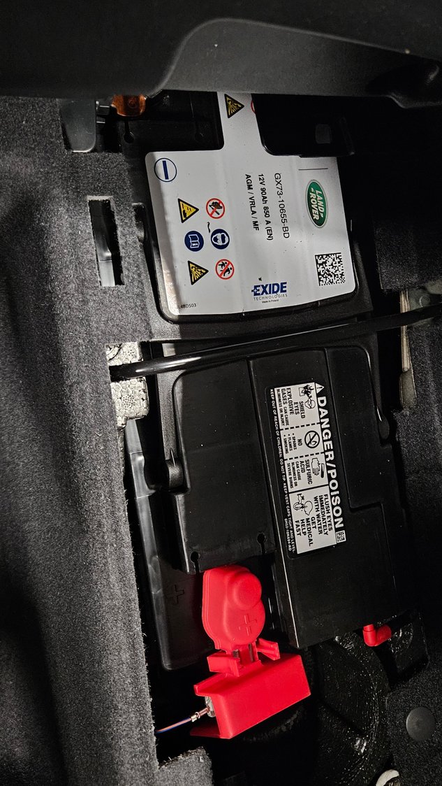

Car has 2 batteries, did you change both?
Old Nov 4, 2025 | 06:41 AM
DJS's Avatar
DJS
Posts: 7,024
Likes: 2,694
From: Metrowest Boston
The car doesn’t care if the start/stop battery dies. Mine died, and the only consequence was that start/stop disabled itself, no warnings of any kind. I eventually removed it. The 2nd battery disappeared as a feature somewhere around 2016.
