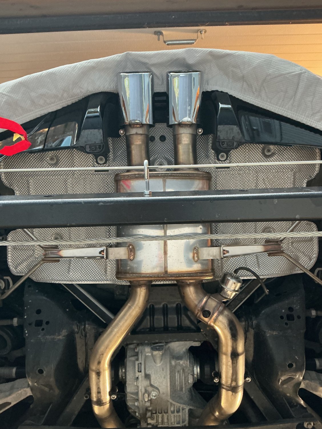

I have noticed that too - a small, sooty puddle of water on the garage floor.
My car cold starts with the sport exhaust “on” and it quiets down after a minute or so.
The warm exhaust gases and water vapor condense on the cold rear pipes and drip out at the vacuum switch which is mounted on the right side of the exhaust on this car.
(Supersprint exhaust)

<drip out at the vacuum switch>
I’m going to revise my comment.
The Black Jag is up on the lift in winter storage, and I was under there this afternoon. Evidently, the condensate leaks out of the right side pipe at the clamped joint and runs down the pipe to the low spot and drips on the floor.
I stand corrected ;-)
