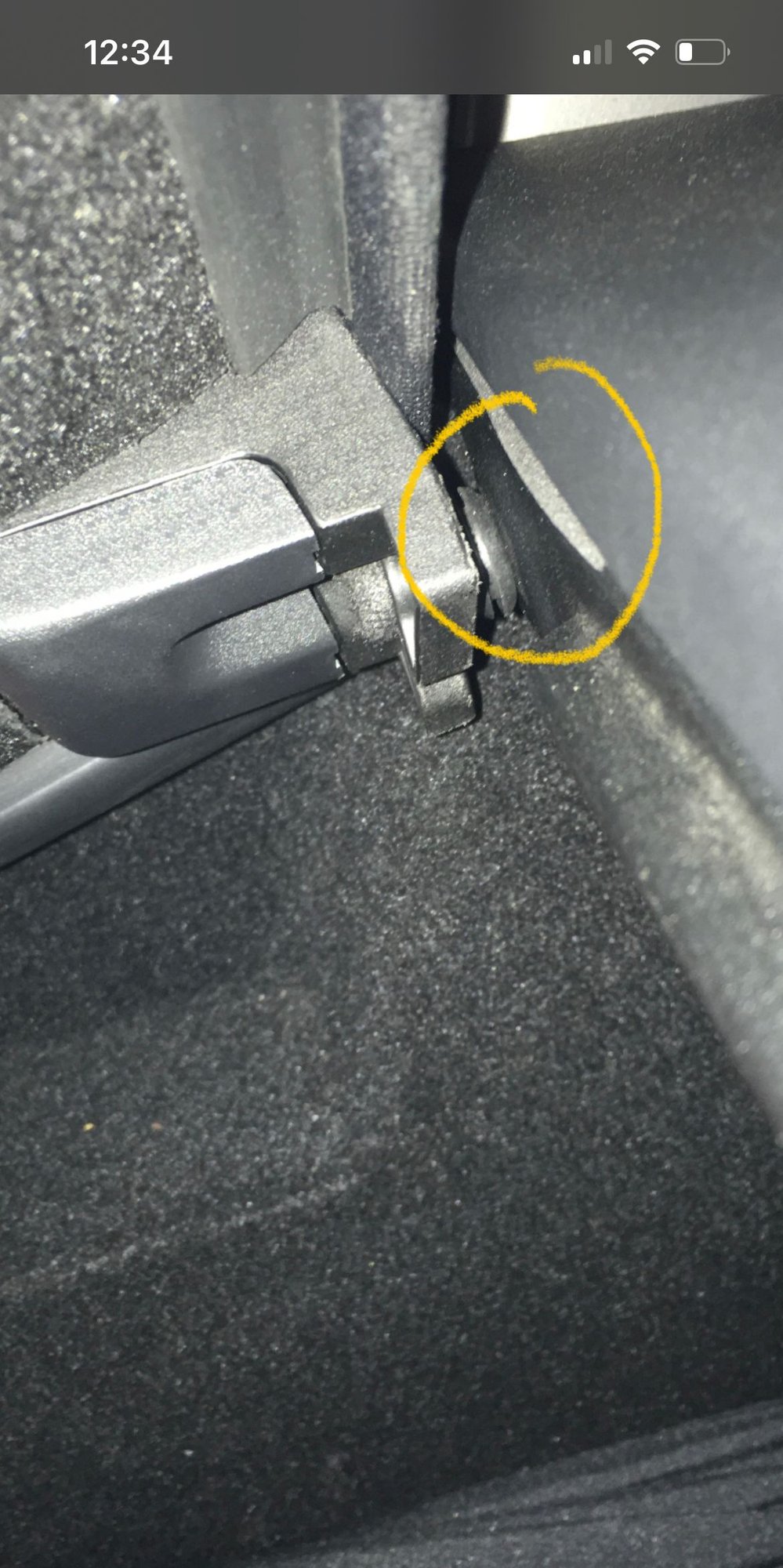

I put one of these on each side to keep the cover central and stop side to side sliding. Took delivery time plus 30 seconds! I think it’s similar to the TSB. . Seems to have sorted it for me.
