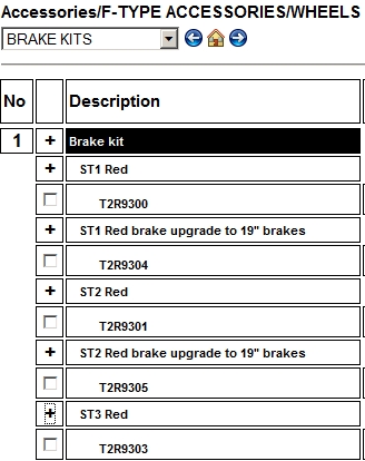

Originally Posted by Cambo
There are some "brake upgrade kit's" in the catalog but not for the Carbon Ceramics.
Attachment 122546
The Carbon Ceramics are referred to as a 20" brake kit in the catalog, so it's not one of the ones listed above.
All the parts for the Carbon Ceramics are available to buy if you wanted to make the conversion, but I think it'll be more expensive to buy it all in parts than it would have been to option it on a new car.
I priced up the bits from the XKR-S GT a year or so ago, just a set of four rotors and pads were around $13k at retail prices. Then add the cost of the four main calipers around $5k, plus all the little bits and pieces needed (dust shields, bolts, hoses, and the handbrake parts) easy $25k in parts, without taxes...
And then you've gotta fit them...
