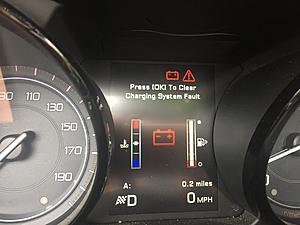

Yes, I did do a search and saw a few things, but my question is - do y'all think it's ok to wait until my appointment on Monday morning or should I go in before then (no appointments left this week)? I've had the fault come up twice and both times it was gone the next time I got in the car so I'm not terribly worried it's just going to die, but thought I'd ask opinions around here. Even more glad now I went with the CPO!
First of all, let me properly introduce you to the Prince of Darkness, aka Joseph Lucas, founder of Lucas Industries that provided most of the electrical components for British cars until recent decades. Lucas, well known for its questionable reliability, has been the target of substantial derision over the past century. The spirit of Joseph Lucas is so strong, that it still haunts British cars to this day, including Jags, despite utilizing Bosch components.
Next, what error message do you get and when does it occur?

it has happened twice now. I don’t remember the circumstances the first time, but Saturday I had left my eye doc, stopped for gas and it came on when I started to leave there. Next time I cranked it, it was gone. From what I saw in an older thread it might be an alternator issue. Maybe it was because it was a short trip? Only about 1.5 miles from doc to gas station. And sheesh I need to wipe down the inside of the car again. Pollen and leaving the top down in the parking deck = gross. Think I’m about to take care of that now.

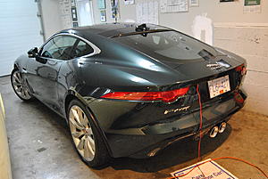

If the battery is the original one, and particularly given your history of very short runs (4 miles) at low speed, then that is likely the cause of the problem - because that pattern of use is very hard on a battery over time. The immediate solution would be to charge the battery to full voltage. I note that your car is kept outside, not garaged. If it were garaged then the solution would be to fit permanently a battery maintainer such as the CTEK (this is not precisely a battery charger- it maintains the battery at full voltage always - my car is always on this: photo). But in your case you might be facing a battery replacement. In any case, I would eliminate the battery as a possibility rather than concluding that it is a deeper problem. If you DO get a new battery - you have to be aware that they are almost never fully charged at installation, so the first thing to do is to have it fully charged.

Supposedly a spot is being cleared inside the garage for me to park, but since there are currently 7 vintage motorcycles, plus all of his equipment for his work (which is why the garage was built in the first place), I'm not holding my breath. I'll show him this and maybe that will move me up the line on getting indoor space. That's just my drive to work, but yes, since I live and work in town, I don't go out much farther, although I'm in the car longer than that sounds like (and when I go to physical therapy for my shoulder or any other errands at lunch time, I do get on the interstate and have more fun than short bursts of speed. Still, since like I said, I know the fault this past weekend was after leaving my eye doc, going about 2 miles (if that), getting gas and it happened when I cranked back up, seems like a valid assumption. I'll get that taken care of tonight and look into the maintainer. I just didn't automatically go to thinking battery since everyone else seems to have weird little things stop working when the battery is going.
If I go and have the battery tested is there a particular number I'm looking for to know if it's not maintaining enough? I'm assuming there is a minimum voltage number we need? I suppose I could go look for myself but since y'all probably already know and I already have about 10 tabs open trying to research the proper carb for a 62 motorcycle, I'd rather not fall down that particular rabbit hole at the moment.
