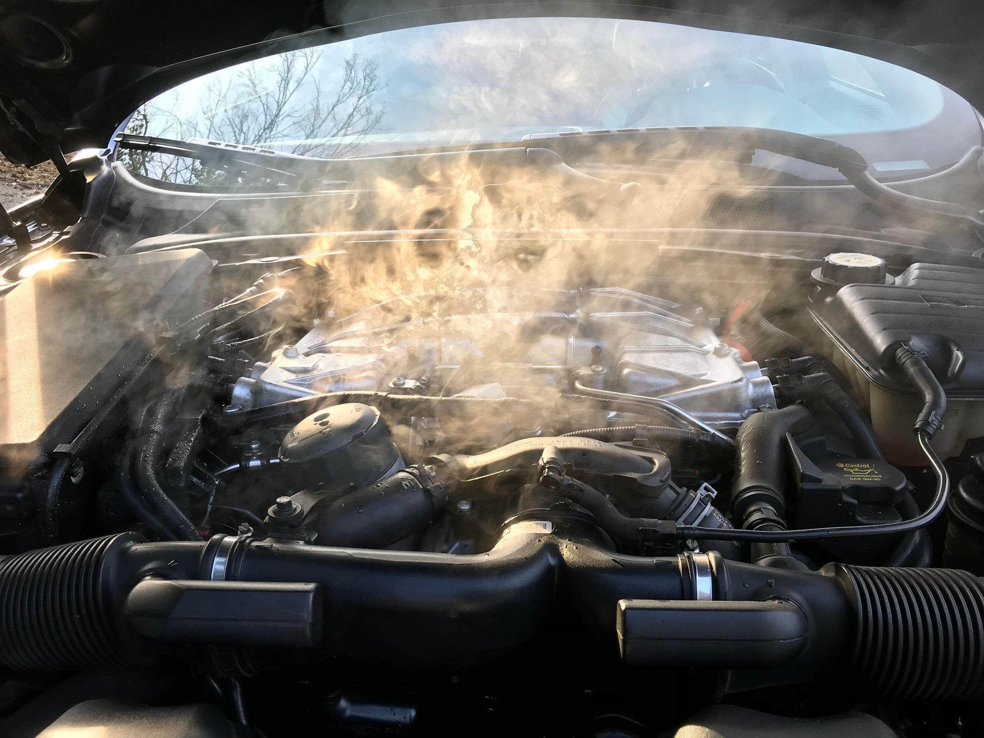

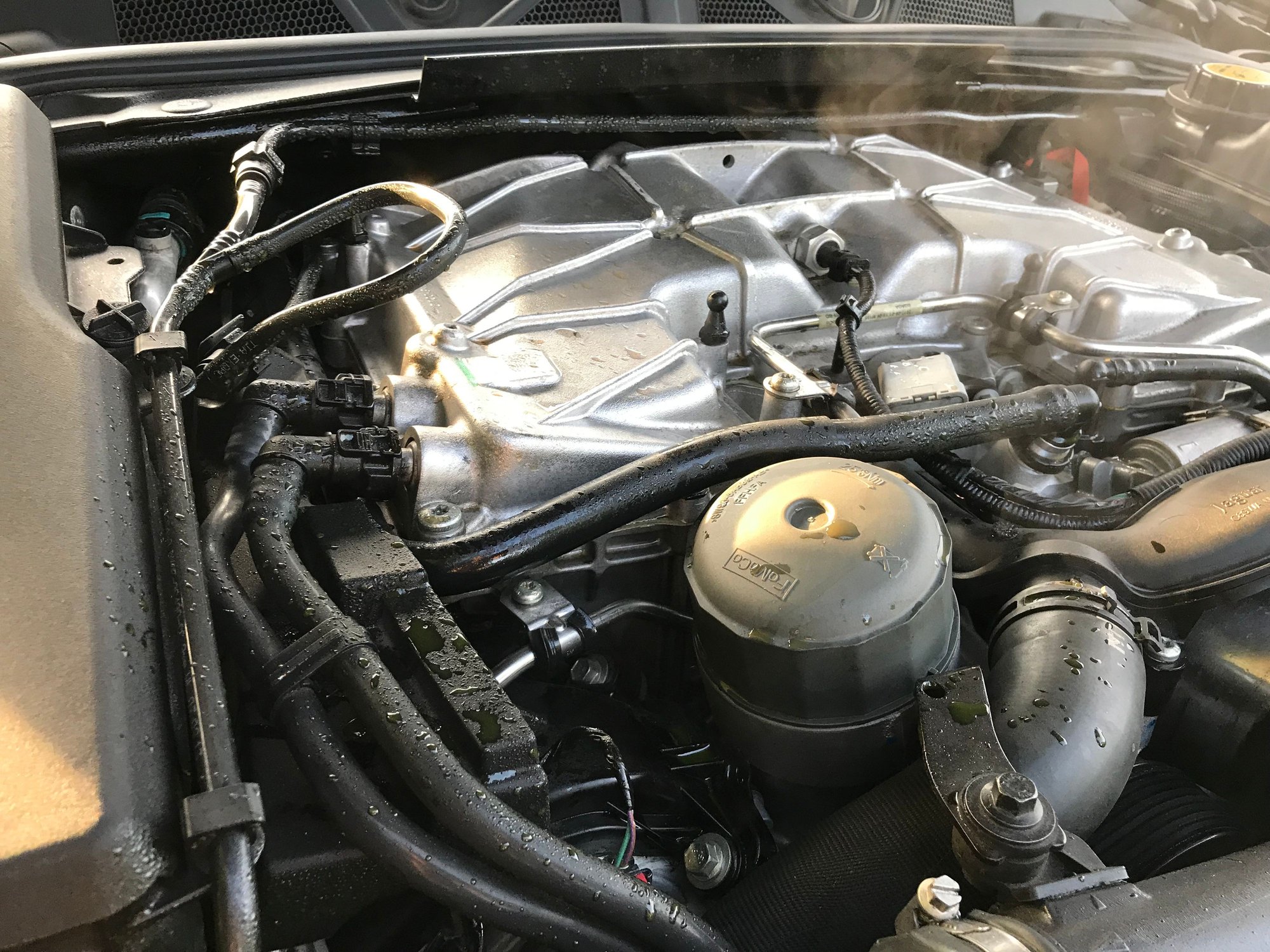

OK so today I had a drama, it went like this:
1. out on a drive, squirted off pretty hard just really from 0 - 100kph;
2. about a minute later I got a low coolant message;
3. about 2 - 3 minutes later I got an overheating warning;
4. pulled over, white smoke was coming from under the bonnet. It didnt smell, I think it was steam;
5. there was a lot of fluid sprayed in the bay mostly in front of the oil filter I think. The fluid was brownish/clear and slightly greasy to the touch but it felt a lot thinner than oil and there was no burning smell. I am hoping it was just coolant. Coolant was quite low so it is all pointing to a failure of something to do with the coolant system aside from the greasiness of the fluid. There was also a lot of fluid under the car.
I had the car bought back by truck to my brother's house while I work out whether it is something that can be dealt with there or does it need to be trucked off to a repairer. So:
1. any thoughts on the likely failure?
2. any thoughts on whether the repair is likely to be a Big Thing?
3. if I fill it with coolant, is there much risk starting it up?
Help always appreciated!

Sounds like one of the common coolant system parts (Y pipe etc) or water pump has conked out. Normally not a huge thing but usually requires the supercharger to come off to be able to reach the parts that need to be replaced. I doubt there would be much risk to just start it up if you fill it with coolant.
When the water pump went in an XF 3.0 S/C I had years ago it played out in a very similar manner with massive steam and coolant sprayed all over the engine compartment.

No question it is coolant and a pipe/tube/seal whatever has cracked or split.
Check the simplest thing first - the expansion tank hose/tube where it splits into two thin tubes which then plug into the front cross-over pipe, one up high and one lower down. The higher one of the two split/cracked on mine a few years ago and sprayed coolant all over the front of the engine bay, got the low coolant level warning but luckily no overheat warning.
Top the expansion tank back up with distilled water, start the engine, let it warm up a bit, then inspect those two little tubes and wiggle them a bit and see if you can spot a leak. If it is one of those tubes you are in luck as a new pipe is cheap and easy to fit.
If it's not one of those tubes then you may not be so lucky and it is most likely to be the infamous Y-pipe or cross-over pipe, big $$$ to replace as the SC needs to come off.

Good info, thanks. Hopefully it is the top pipe as the water is definitely all over the top of the engine bay, on the air pipes etc. Though it looked pretty much identical to Major Tom's pics above.
