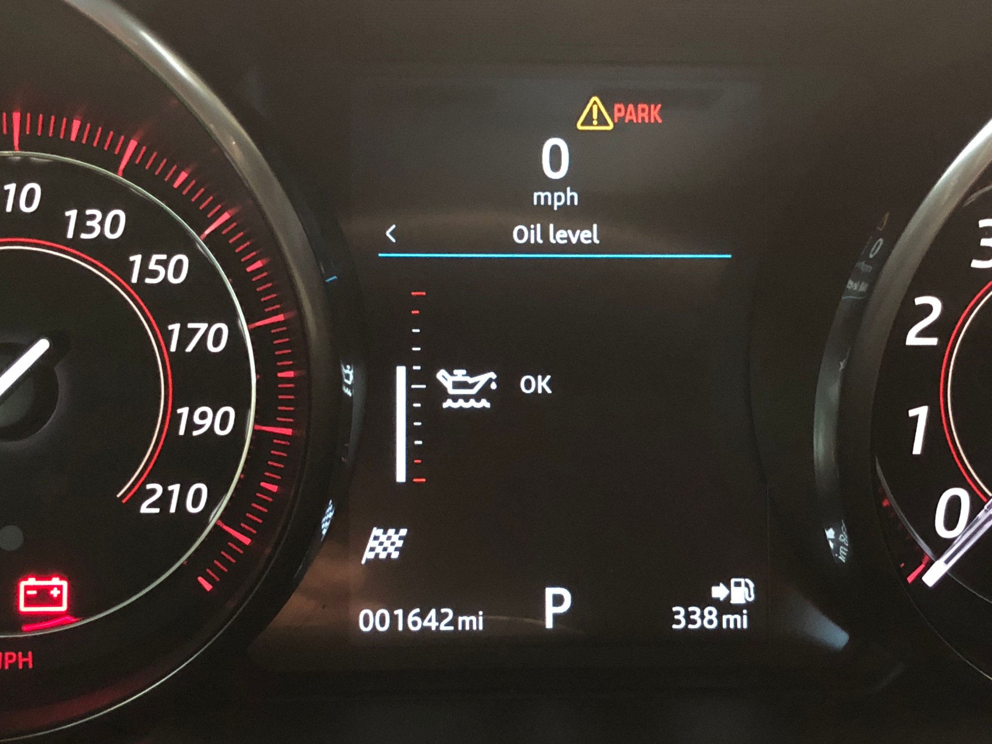

Old Jan 10, 2019 | 05:42 PM
eeeeek's Avatar
Joined: Jun 2018
Posts: 1,615
Likes: 754
From: Granite Bay, CA
Add me to the overfilled list. Instead of waiting for an appointment for the dealer to address it, I just ran down to the jag shop down the street, Gene McCafferty's Automotive Services, and they quickly got my car in. Up on the lift it went, they drained 2 quarts from it and then brought it back down to refill to the appropriate level and they put back in...just over a quart. So, doing the math, the dealer probably filled it to the RWD spec. How is this still happening?
Anyway, thanks to the resources here. I never did figure out how to get the 'live' reading going (the instructions from Tel appear to be for the older model), but in normal mode, you could see the oil being added back in.
