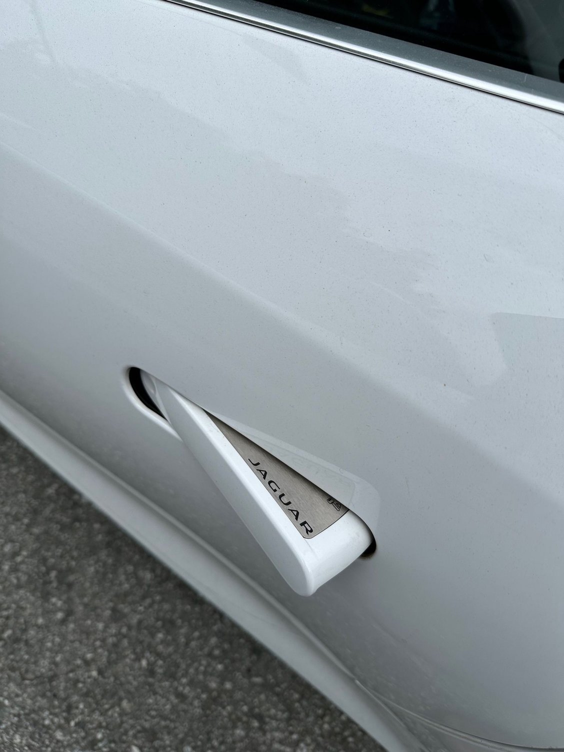

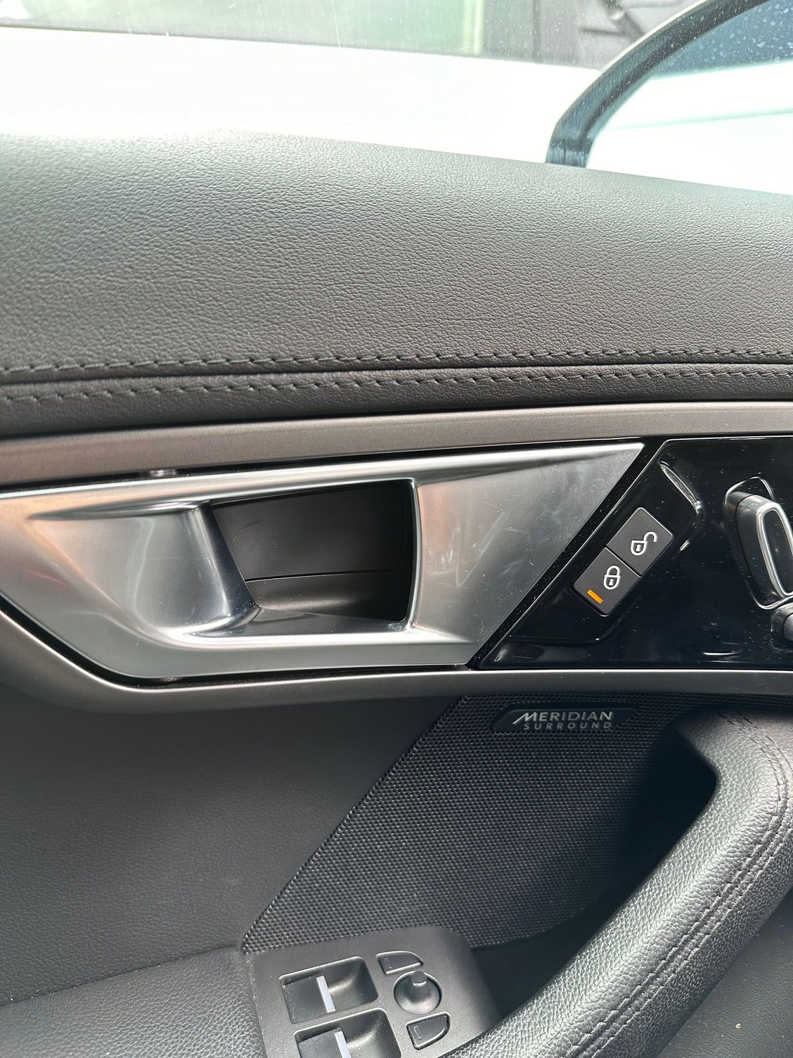

Brief description of the issue: When hitting the unlock button on my key fob, the door handle pops out as expected. However pulling on the door handle does not open the door. As you can see in the 2nd image below, the lock light is still illuminated, and pushing unlock does not do anything. The only way to open the door is by pulling the interior silver handle. Once the door is unlocked, I am able to open/close the door as I please from the outside as long as I don't lock it again.

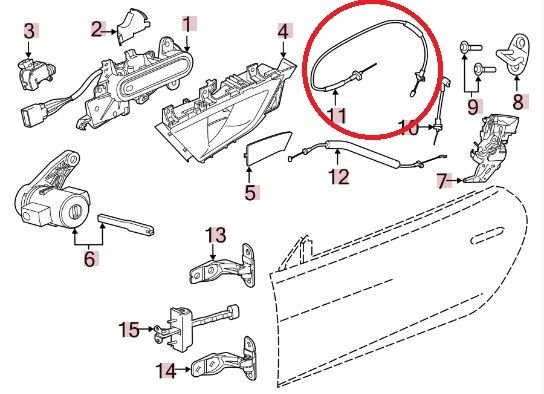

Had a similar issue happen on my passenger (Left hand - UK) door, but my issue was with the interior handle not opening the door. Turned out the interior handle to lock cable had detached from the rear of the door card meaning the outer cable was not fixed, absorbing the movement of the inner cable. See pic below
Thankfully easy fix by pressing the outer cable back into its housing.
The outer door handle is attached to the door lock by a pull cable just like any other car door handle and I suspect using similar fixtures to the interior handle. It's only the initail 'pop out' that is actioned by a small servo. The door card is not difficult to remove, a few torx screws and the usual plastic trim retainer clips (released with large trim tool). Video posted by Valerie shows you how to do it.
I suspect once you have the door card off, you will find the pull cable (item 11 above) has detached from its fixture and is therefore not actioning the door lock. Alternatively the cable may have snapped or the 'nipple' at each end may have sheared off. Cable is T2R81366 priced at $68.11.
