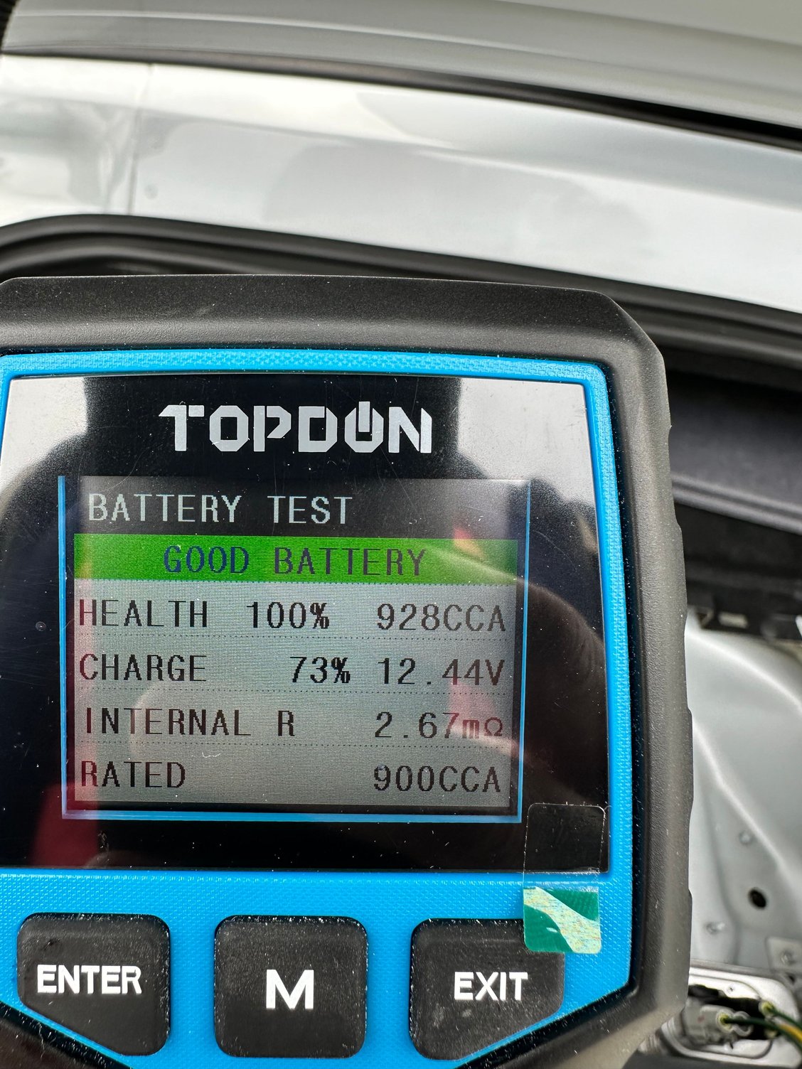

I'm beginning to wonder if my battery tester is having issues. These two pics depict back to back tests. Note the "good charging". There was nothing charging. Another thing is when tested the old battery the tester said to replace battery. I picked up a new battery and tested the old one while still installed and got "good battery".
Can all of this be happening at the same time? good grief!!
I replaced both fobs with new batteries as my battery stock had some "2024" batteries in there. No change at all they still work intermittently.
Decent point, you could pull the battery out and take it to a local autozone (or the like) to have them test it. Even then, we all do know these cars are finicky with battery charge and these AGM batteries are a little different than your typical ones. If this is the original Jaguar battery it is definitely overdue for replacement anyways - batteries don't last forever. You can get any equivalent, they all work fine.

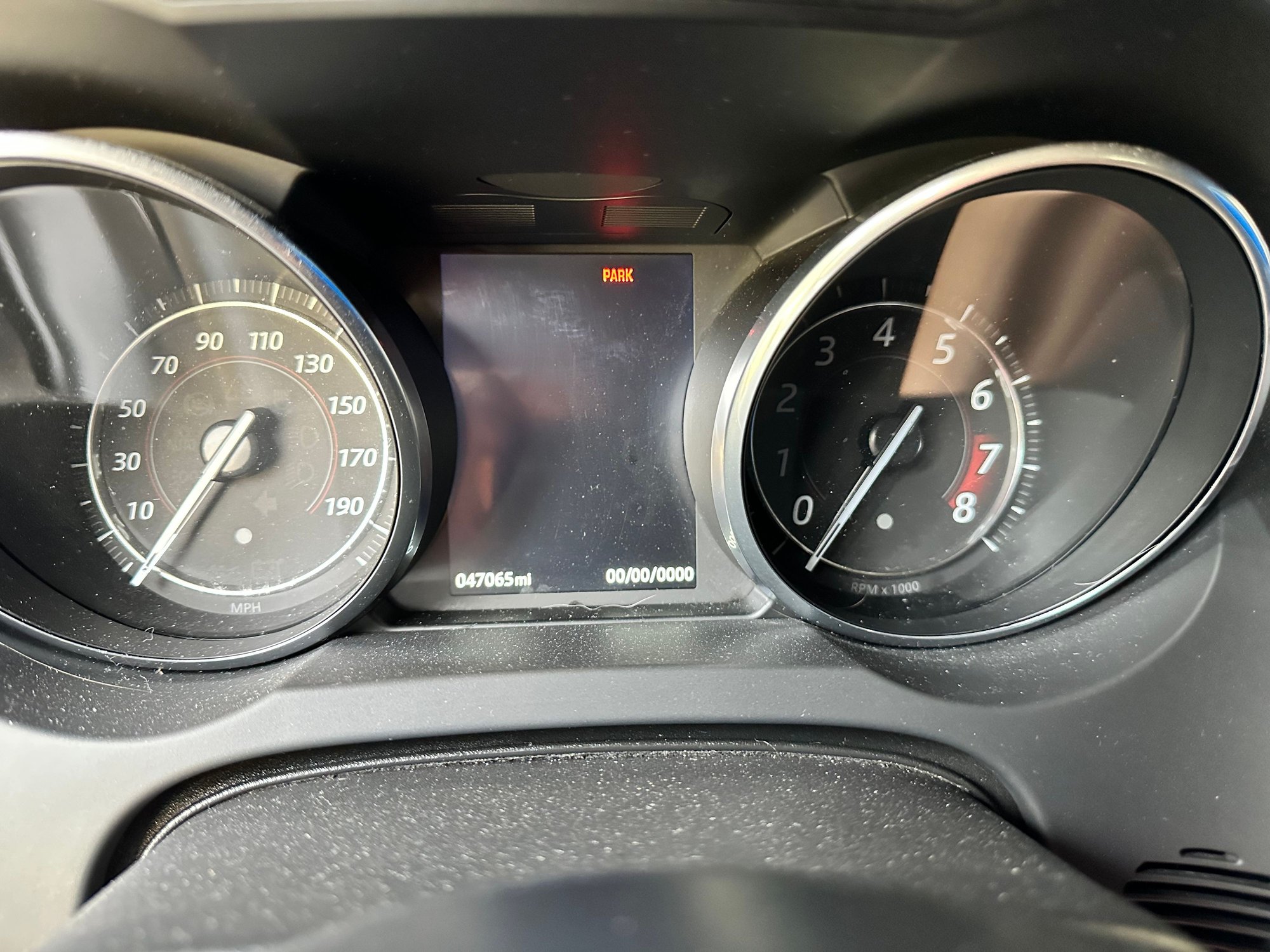

while I was screwing around with the fobs I decided to try to start the car and the friggin thing started. As soon as it did the tach decided not to work. After about five minutes the entertainment center decided to come on but was not responsive to to any button pressing. Interior lights worked along with heated wheel (weird). The windows would roll up and down every so often.
i hooked up a charger and called it a day. I’ll disconnect in the am. I was finally able to arm the alarm after numerous attempts with both fobs and the door handle.
This is when it started
These are five minutes later
