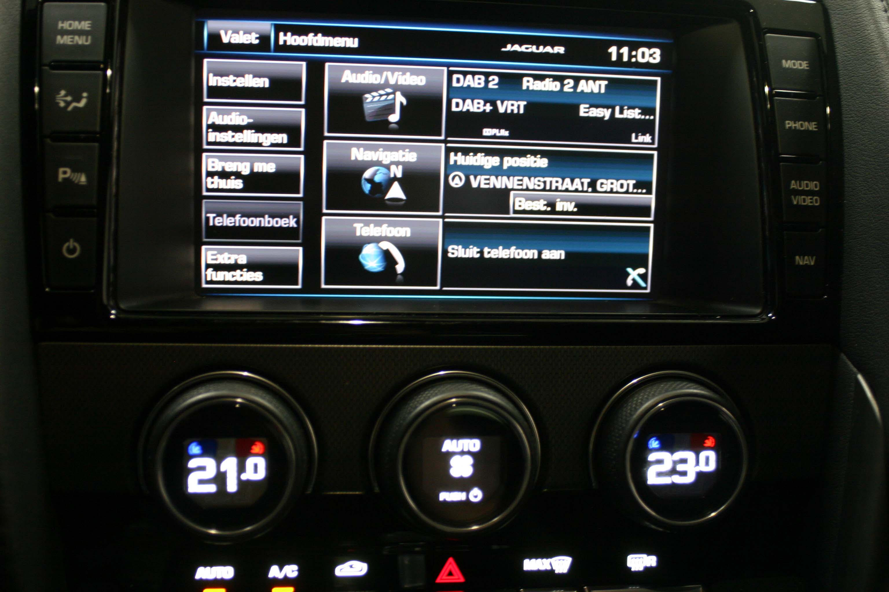

Old Apr 15, 2018 | 04:46 PM
  #53
Cambo's Avatar
Joined: Jan 2011
Posts: 8,637
Likes: 4,526
From: Sydney, Australia
After much head scratching, cross checking, de-coding and a little stroke of luck, we were finally able to figure out the Dual-Zone vs. Single-Zone climate mystery.
Long story short JLR made a mistake in the car configuration file.
But now it's possible to enable the Dual-Zone climate in any F-Type up to 2017MY.
