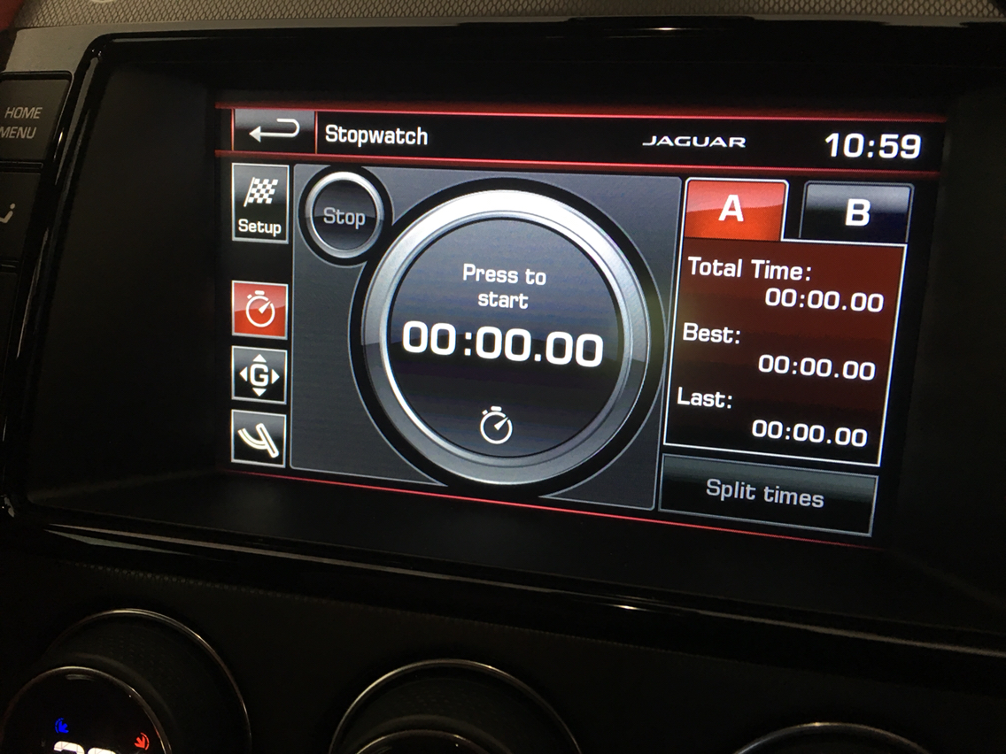

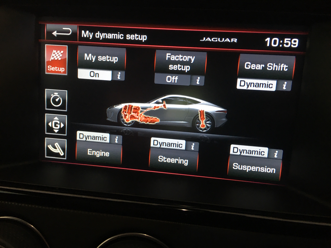

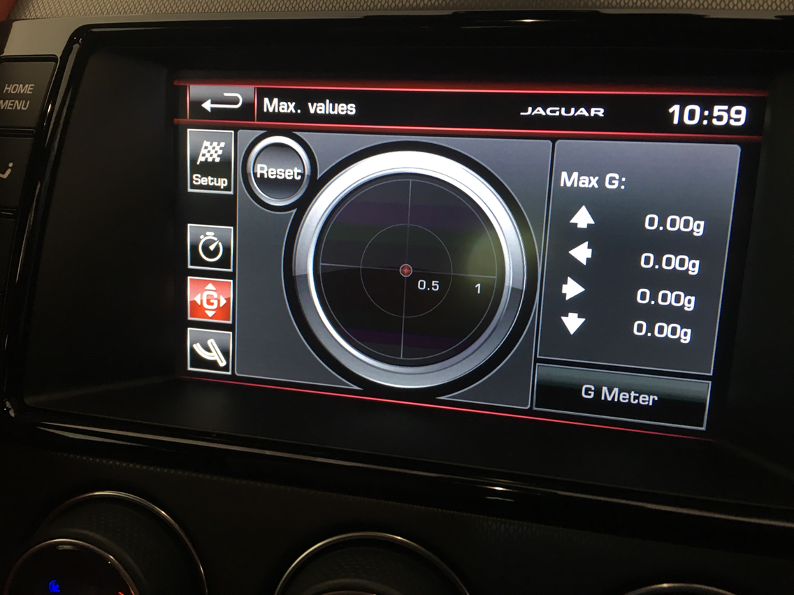

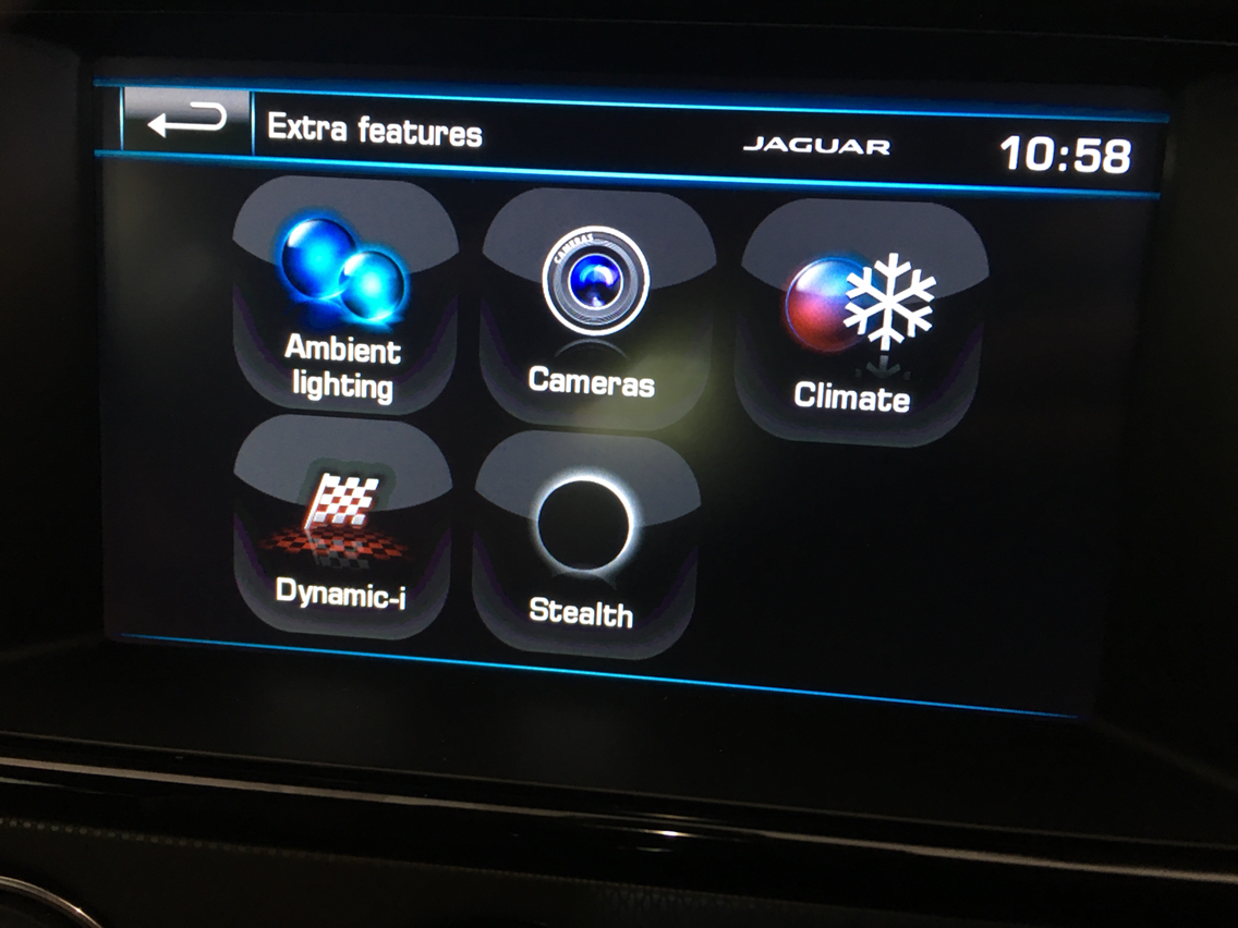

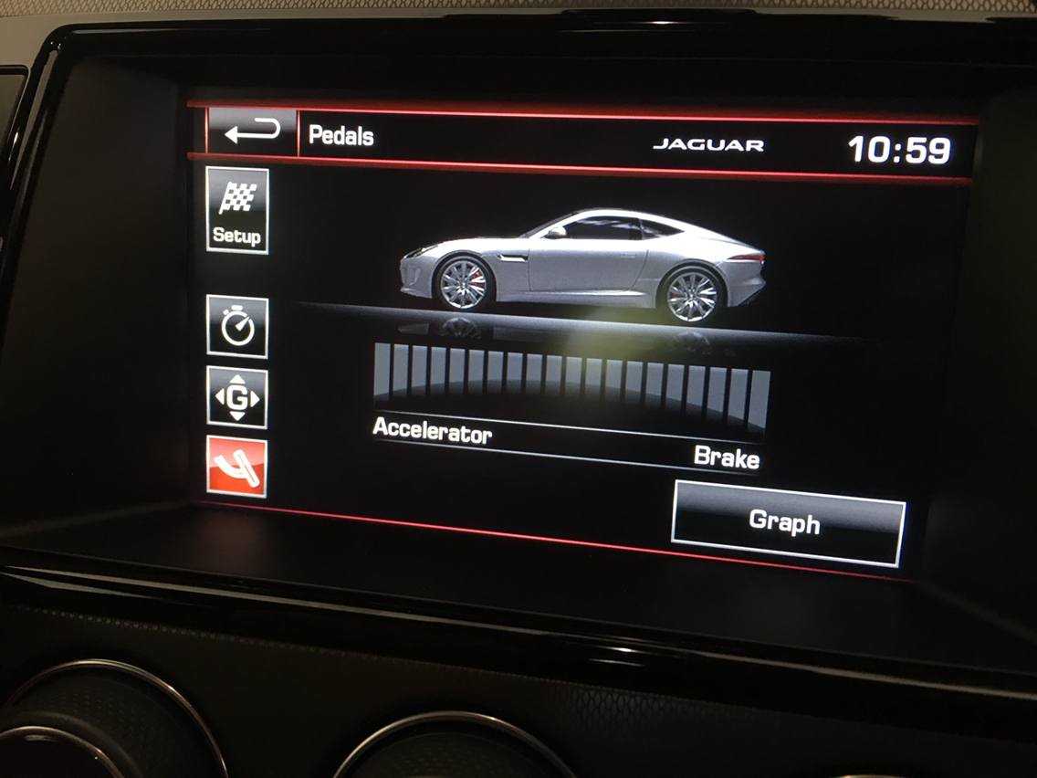

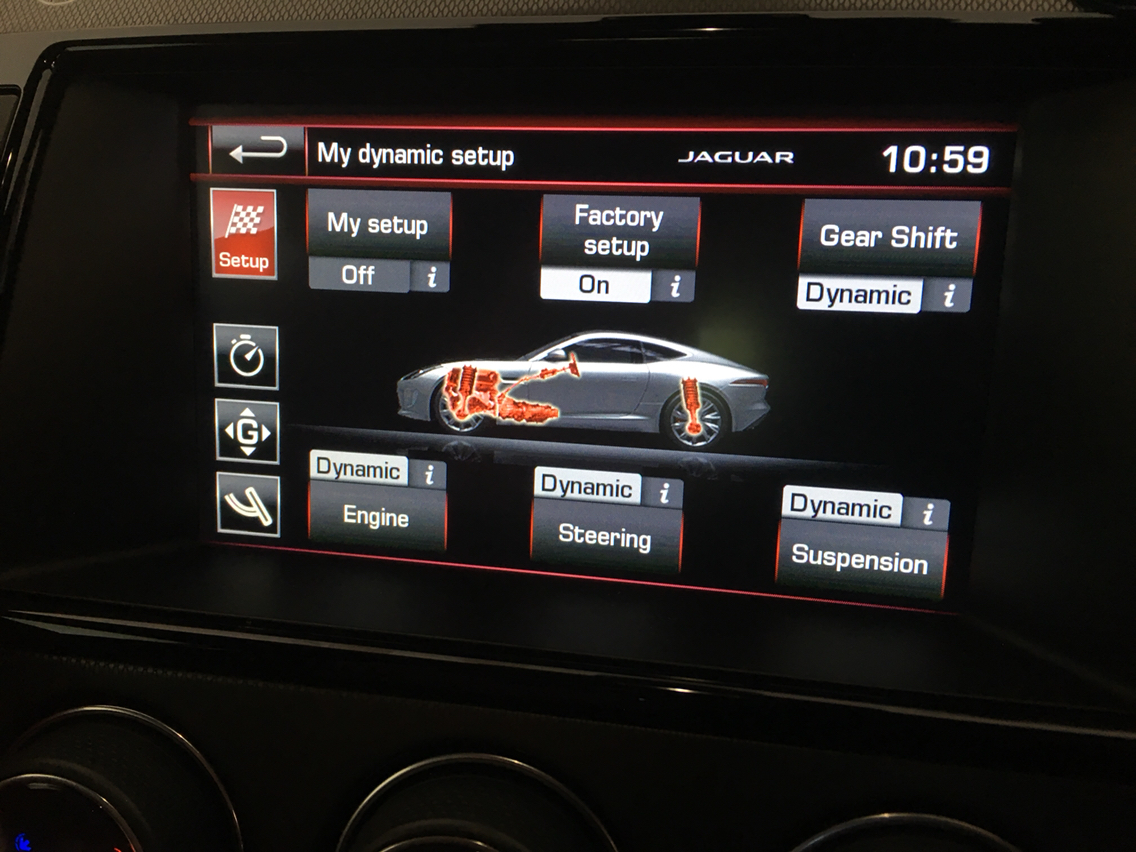

Here's the pics I took today;

I haven't had a chance to check which models in other markets got this feature, I know the V8S and R have it as standard. Could be that the V6S in North America has it as standard as well?
I don't think it'll be possible on a base V6 without the Adaptive Suspension.
But it seems odd that it was left out on your V6S, it's only software after all...

Yes, the V6S manual has full i-Dynamic capability (obviously the tranny dynamics are established with a manual foot dance). Otherwise we can set the throttle, steering and shock sensitivities, record max and monitor g's in 4 directions and view fore/aft throttle and braking input. Maybe other stuff as well, but I'm usually paying closer attention to driving. Checking the pics above, the only difference is that mine lacks the gear shift button in the upper right hand corner of the setting screen.
