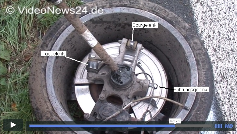

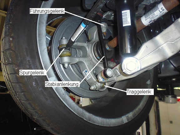

When you look at these pictures it is actually quite shocking how little is actually holding the whole hub and wheel assembly on, considering the forces involved. It would only take a manufacturing fault in that tie rod end to fracture and the wheel to get a little out of true and the forces at speed would then just tear through the suspension arm mounts.

Bigger pictures help!

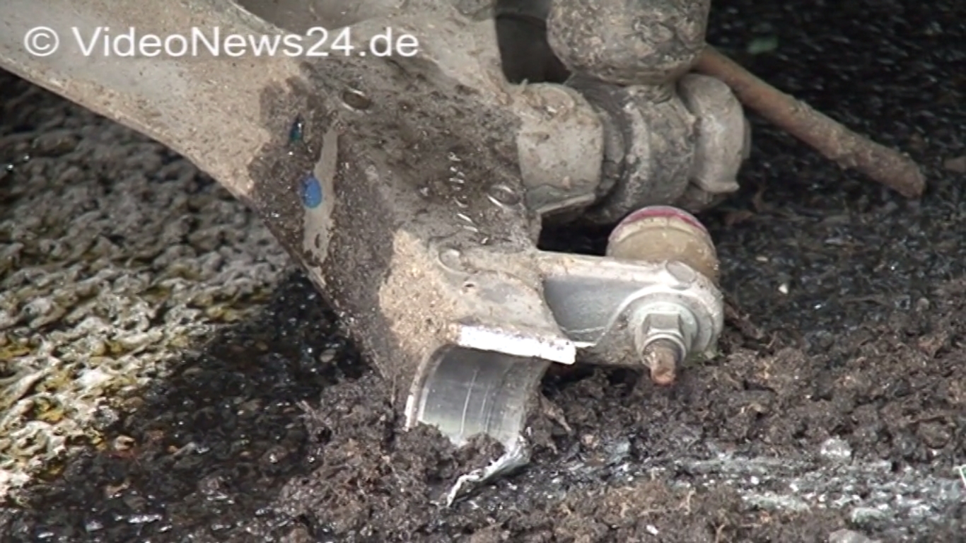

Although the rear lower wishbones on the F-Type have different part numbers to the XK, XF, and the earlier cars, they do externally appear to be identical, and are no doubt from the same supplier and probably cast in the same moulds. This design of wishbone has been in use since 2002 with the S-Type and X350 XJ.
So if there was a design problem, or perhaps a metalurgical one, such failures would be seen on more vehicles around the world, not just two F-Types in Germany.
EDIT
I do find it interesting that the boot of the CV joint on that dislodged wheel looks to be melted.

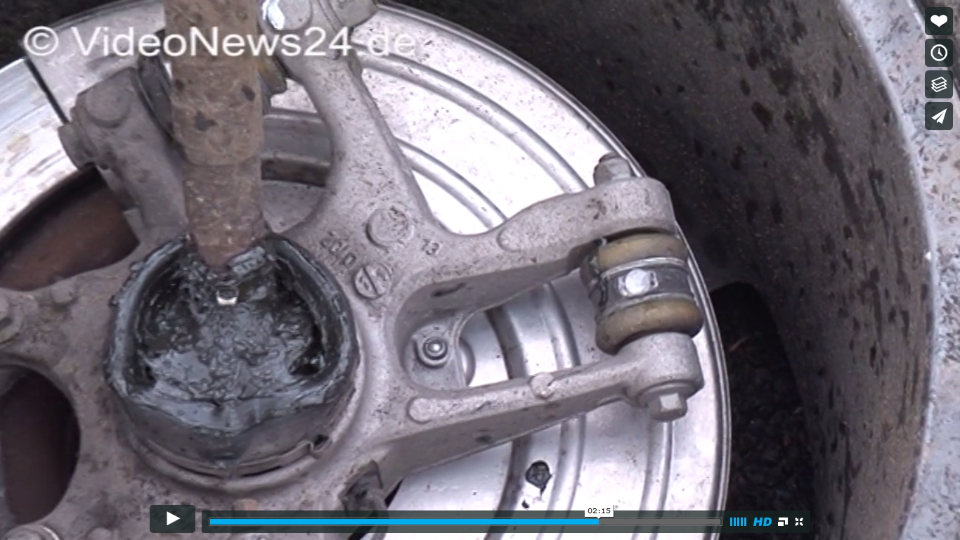

OK here's some better pictures from the video.
The failure points are pretty obvious. But the reasons why they failed are anyone's guess.
Nobody has actually said if the rear wheel came off the F-Type first, which caused it to collide with the SUV. Or if the SUV hit the F-Type, breaking the wheel off it and sending it into the wall.
Plenty of heavy accidents have occured with many different vehicles, that have ripped wheels off the suspension.
My eyes are still drawn to the CV joint on the separated wheel. What happened to the boot?

I've been staring at the CV joint also. Not sure what exactly is going on but it does not look to be recent damage. A bad joint, even at the point of failure will generally not release enough heat to melt a boot. Being that the half shaft remained with the wheel ***'y during the event, and that a failed joint will not affect suspension geometry, it's probably not a contributor.
The fracture points on all the visible suspension components appear to be very fresh, with no evidence of pre-existing condition.
On the other hand, it is also notable that the right rear wheel, still somewhat attached to the car, has a pronounced toe-out angle. A car with any significant toe out would be almost impossible to control. The rim of the wheel also has fresh impact damage spread over most of it's circumference, indicating that it was rotating at the time.
There's virtually no body panel that has not sustained damage. The left front tire has been punctured. This suggests that the car spun extensively, striking other objects before coming to rest. The amount and type of body damage behind the rear wheel assembly is substantial and significant in nature.
To state that the fault originated with the left rear suspension based on what it known at this point is premature.
I would think that if the root cause was indeed the left rear wheel assembly, it would not likely have come to rest ahead of the car on the hard shoulder.
