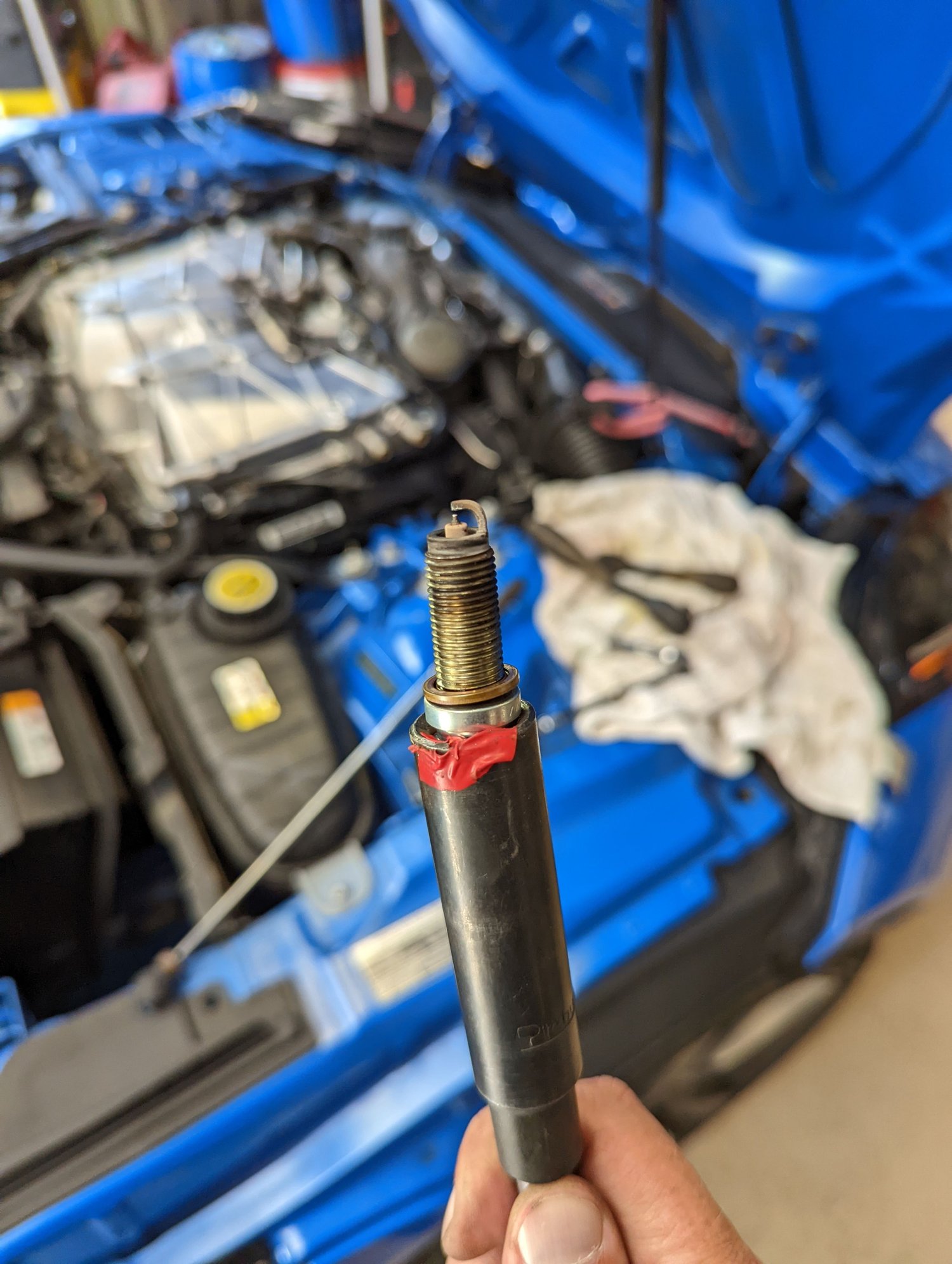

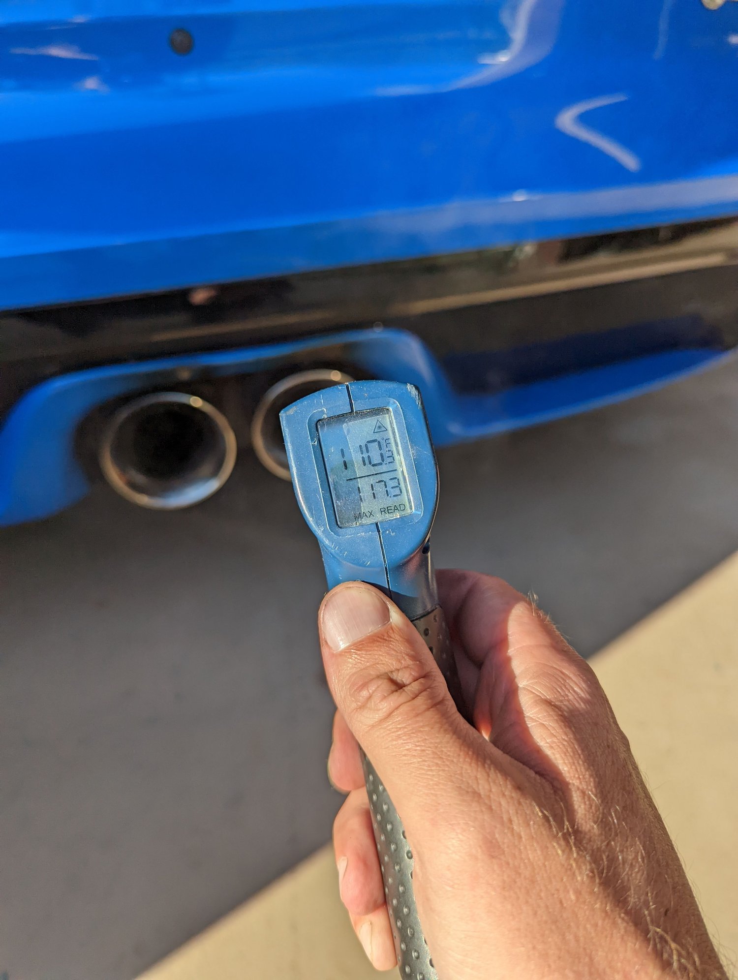

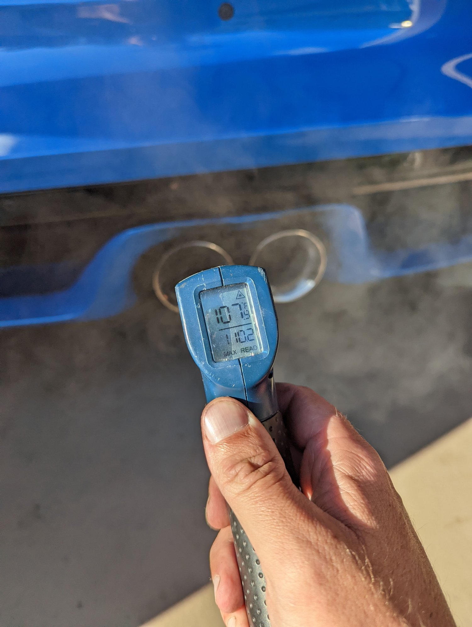

Sorry for not getting back to posting the results. I got stuck in Mexico for a few weeks.
Anyway, after a 45-minute drive, I measured the exhaust temps of the exhaust tips (107 & 110), and manifolds (355 & 350). Both sides were within 5-10 degrees of each other. The bumper felt cool tho the touch. I also did the OBD scan and it came back with no codes. I also pulled the spark plugs on the passenger side and they looked good.

That ground electrode looks like it has some white deposits on it. The only way to truly read EGT is to install a probe just past where the header collects the pipes into one, and then connect that to a guage you can read while driving.

I went back and looked at the pictures of the plugs and compared them to charts I found online. It's definitely running lean. Now it's got me wondering if it only happens when I'm at high speeds and it's a fuel delivery issue or if it's happening all the time due to a o2 issue. I might pull the plugs on the other side to check those as well. I hope I don't have to take it to a shop to fix this issue
