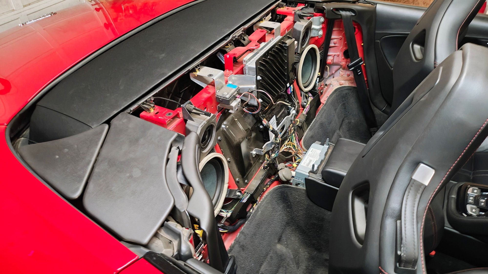

I believe the rears are subwoofers only.

This is normal unfortunately. Don't know what they were thinking when they designed the sound system.
The trim around the rear woofers just can't take the bass frequencies and rattles and buzzes. The simple solution is simply to fade the sound forward. Unless you want to tear things apart in the back to add some vibration damping material. The front door subs can make things in the doors buzz and vibrate too, but that's easier to handle. There are some threads on here about how to pull off the door cards and add sound deadening.

I ended up installing a 10-in powered sub behind the passenger seat with the signal fed from the front door woofers so I could turn down the meridian woofers behind the front seats.
