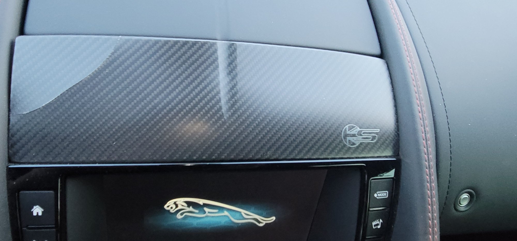

I have a 2017 Jaguar F-Type British Design Edition 3.0L v6. The interior piece on the dash just above the radio and below the center vent got cracked. It's the rectangle piece, and I need a new one because mine broke. I found a lot of ones online, the only issue is my car is a british design edition and it has a different symbol displayed on that piece because of that. Is their a place I should be looking to find a replacement that would have the symbol I am looking for on it to mark it as a british design edition?
This is the piece that is broken and i need a replacement for. Notice the symbol on it.

Did you call your local jag dealer and ask the parts person?
Also, on the back of it should be a parts number, do a search on that and the should turn up something.

According to the parts manual, the piece is called a "Centre Stack Bezel" under the Facia Components Section. I would say your best hope would be through a dealer and they would need your VIN number and hope for the best. Otherwise get one without the British Insignia which will probably be cheaper and most likely found on E-Bay

Part number is T2R21140. Contact dealer for availability.

Bad luck, that part number shows as discontinued

Perhaps you could find that piece from a totaled F-Type?
https://www.car-part.com/
But, I'm sure that the specific piece would be difficult to find.

Plenty of replacements for that piece but the OP wants the badging as well. Given it would have been a limited production run you have Buckley’s to get a OEM replacement. Maybe you can get a normal piece and get a stencil or sticker custom made to add later
