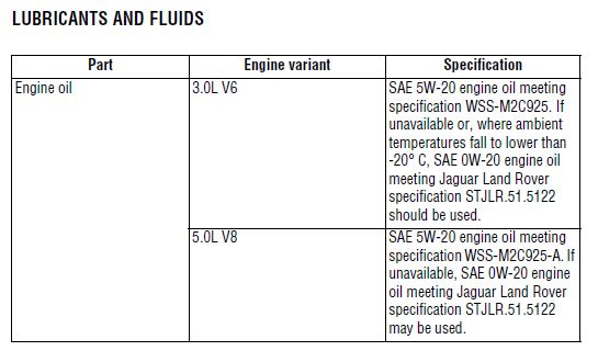

Originally Posted by DJS
The manual calls for 0W-20...
There has been an update to the Owners Handbook which may help with 0W-20 vs. 5W-20 confusion.
The 5W-20 oil (WSS-M2C925) is the oil specified for the 3.0L V6. 5W-20 (WSS-M2C925-A) is specified for the 5.0L V8.
The 0W-20 oil (STJR.51.5122) is for climates where the ambient temperature falls below -20 degrees Celsius (-4 degrees Fahrenheit). This oil may be substituted for WSS-M2C925.
Attachment 83429
I might just add as a latest update on the oil side (taken from the w/shop manual) for those with 8 cylinders:

Interesting - so it's the 0W20 that has to meet their crazy spec. May explain why my dealer didn't use the fancy Castrol Edge Pro when they changed my oil, as they used 5W20.
