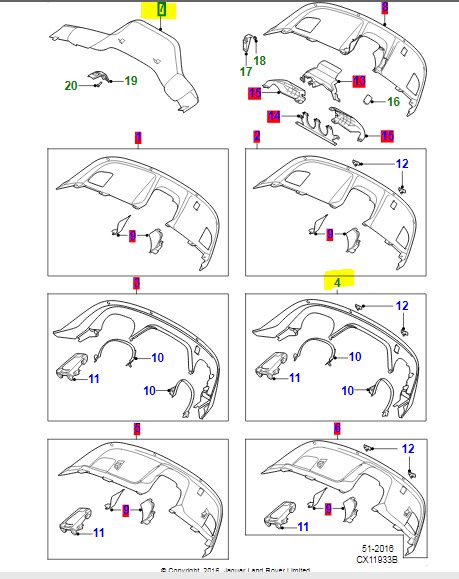

Hi all,
Hoping someone that has done this can chime in.
I'm in the process of converting my dual centre exit V6 exhaust to the quad V8. So far, I've acquired the V8 muffler, reverse/foglights, valance, and quad-exit diffuser.
Looking at brackets, I'm getting a bit confused about how it all comes together. Part T2R2853 (centre bracket) looks like it bolts up to the body of the car and valance - is this right?
Part T2R17333 really has me stumped. Does anyone have an idea of where this is supposed to bolt up to?
Thanks in advance!

Hi, I had the performance guys do mine but I had sent them this https://www.jaguarforums.com/forum/f...ffuser-212349/
and I had also received this while identifying parts

If I remember correctly, I was able to use all of the V6 brackets to fit the V8 panels. One of the brackets needed just a bit of tweaking to line up the bolts.
Obi
