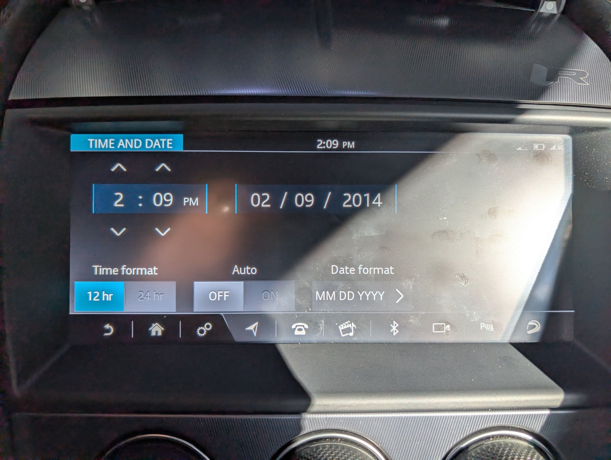

The GPS in my 2018 F-Type R has been busted for awhile (the car thinks i'm stuck in some place a few hundred miles away and doesn't move).
However, I've recently updated my infotainment (changing CCF and screen from 8" to 10") to be able to do Android Auto / Car Play, and AA doesn't like when my date is stuck at 2014. Unfortunately it looks like I can't change the date manually, and it may be linked to the GPS?
Would anyone happen to know if it is possible to change the date in the infotainment manually? If not, I'm taking a look at how to replace my antenna to fix the GPs issue (and hopefully the date?) There are several antenna available https://parts.jaguarpalmbeach.com/sh...sembly=6471456 - I was wondering how to choose which one to get? Radio/cell/etc all work, just not GPS. Thanks!

Thanks for the reply - currently I have the stock system, just the updated screen. Unfortunately while I can change adjust the time (seemingly within +/- some number of hours of what it thinks is the current time), I cannot adjust the date.
If not the GPS module, some have suggested it might be linked to the cell connection, although that seems to be ok (you can see the 4G bars in the upper right)?

Try to turn Auto OFF. (between Time format and Date format)
By my understanding then you should able to set it manually.

Thanks! How would I go about testing this? The only location I've found where I can attempt to adjust the time/date is the setting screen above, but unfortunately that doesn't seem to work. If there's another way I'm happy to try it!
I also do have Pathfinder, so if there's a test or way to check through there, I can also try that out.
