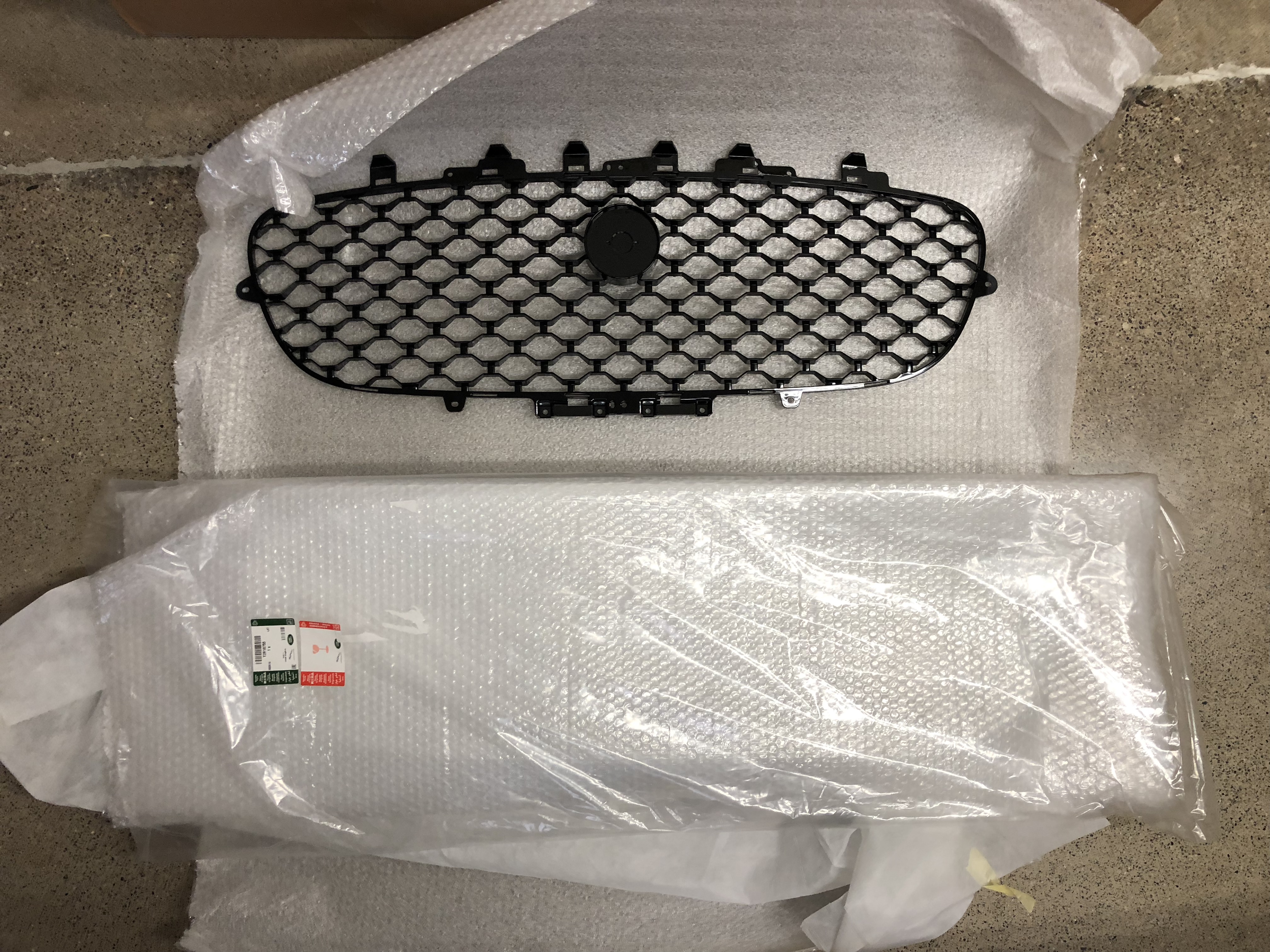

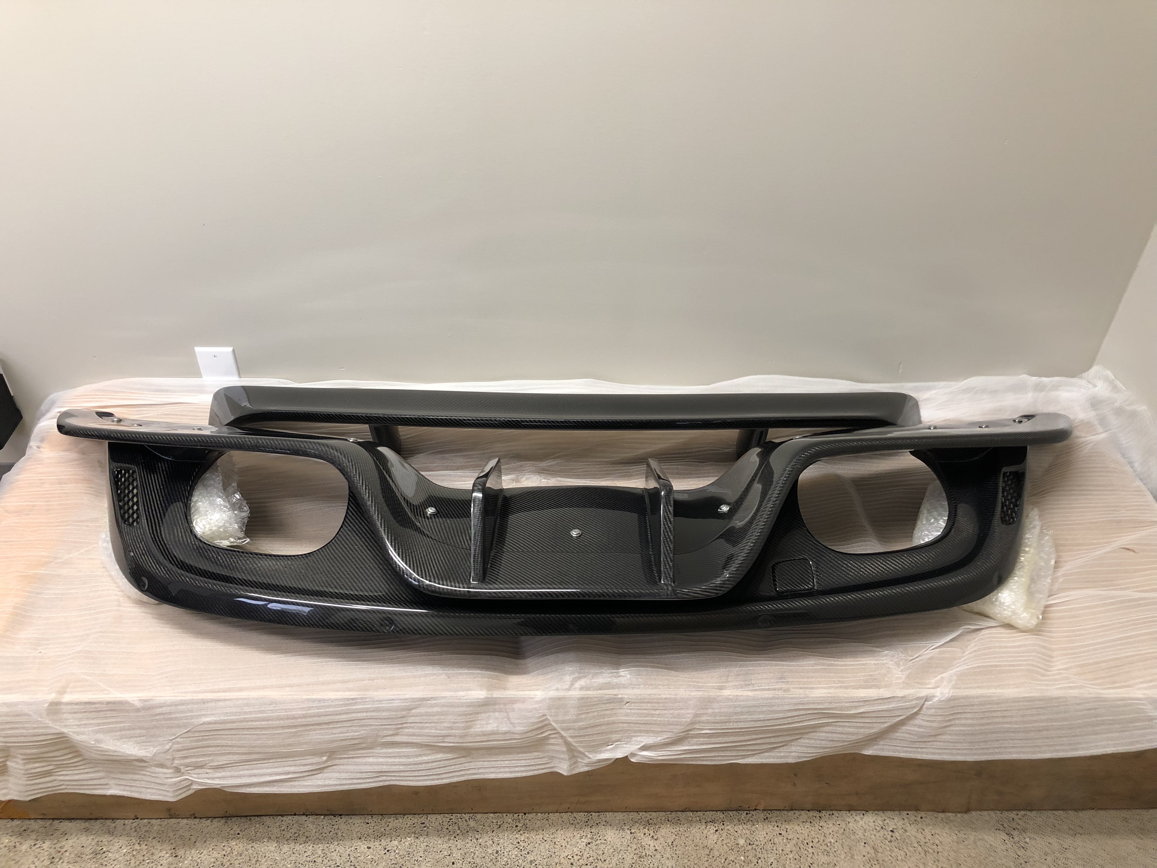

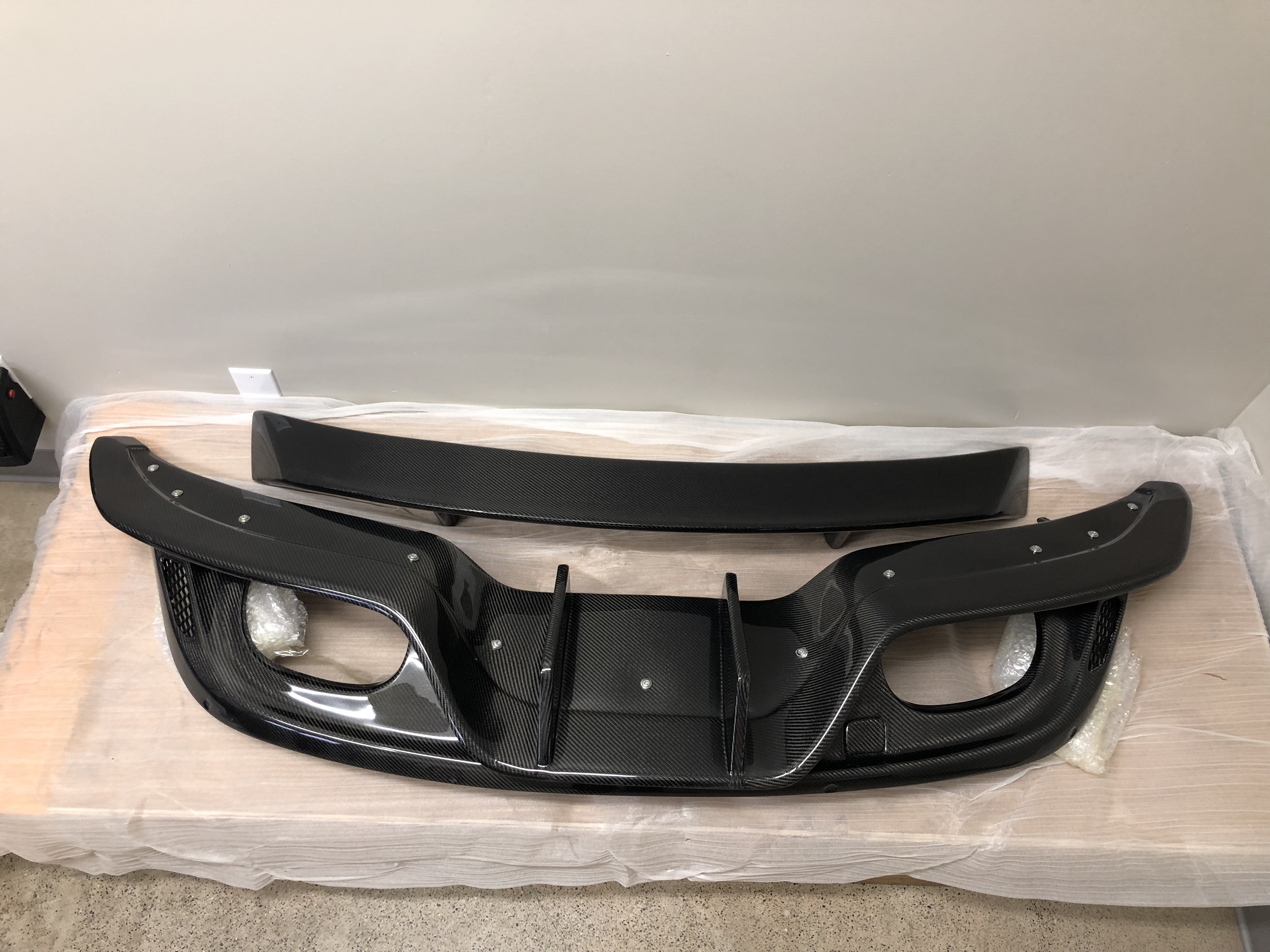

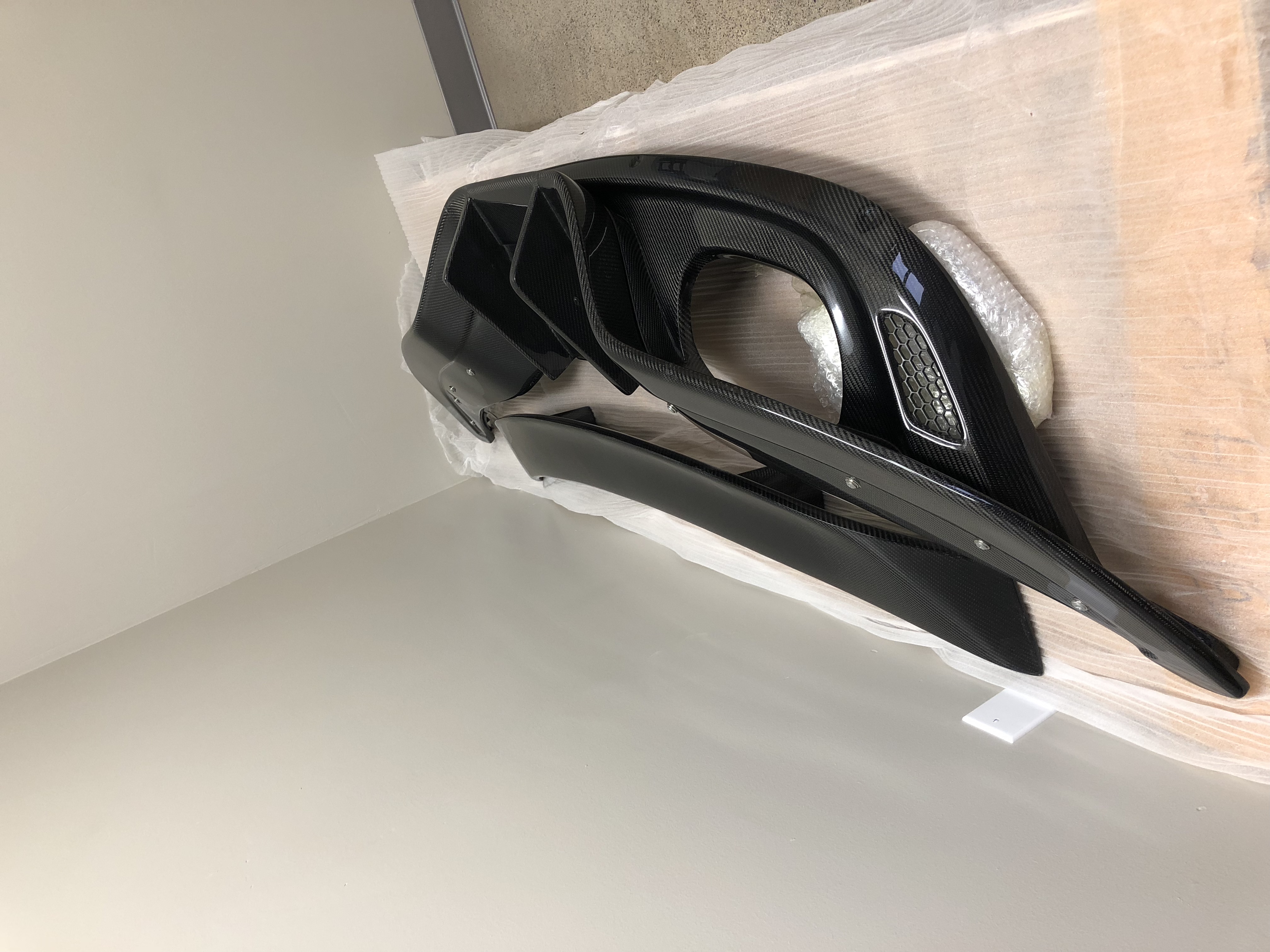

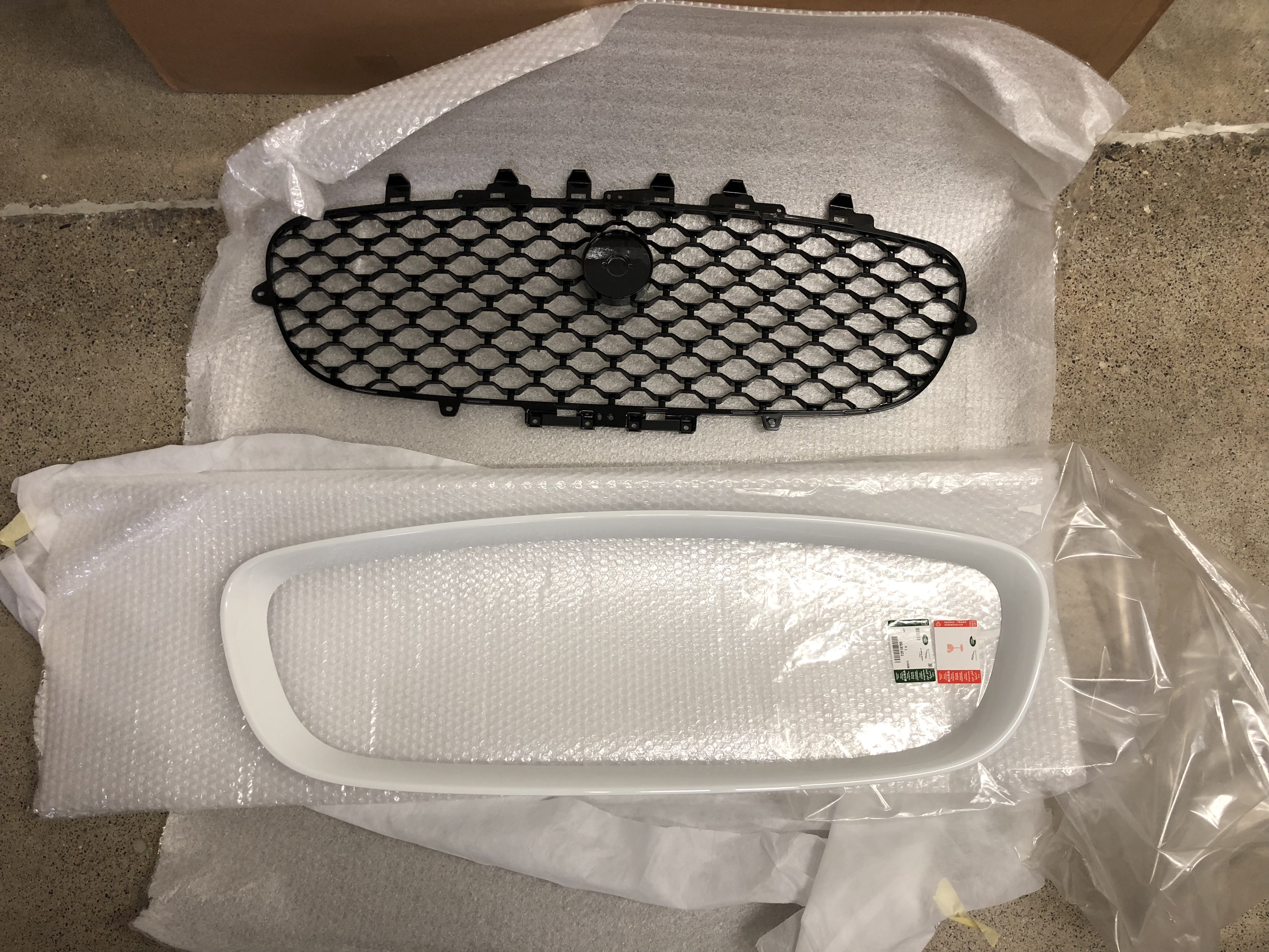

Everything is starting to come in for the new changes this month:
OEM Project 7 Grill Delete
GT Carbon Rear Diffuser
GT Carbon Wing
OEM Side Sills
All parts will be wrapped black to keep the car to the OEM+ "GT3" design. Can't wait to start the install!

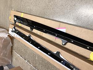

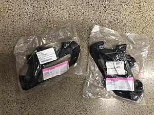

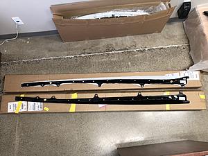

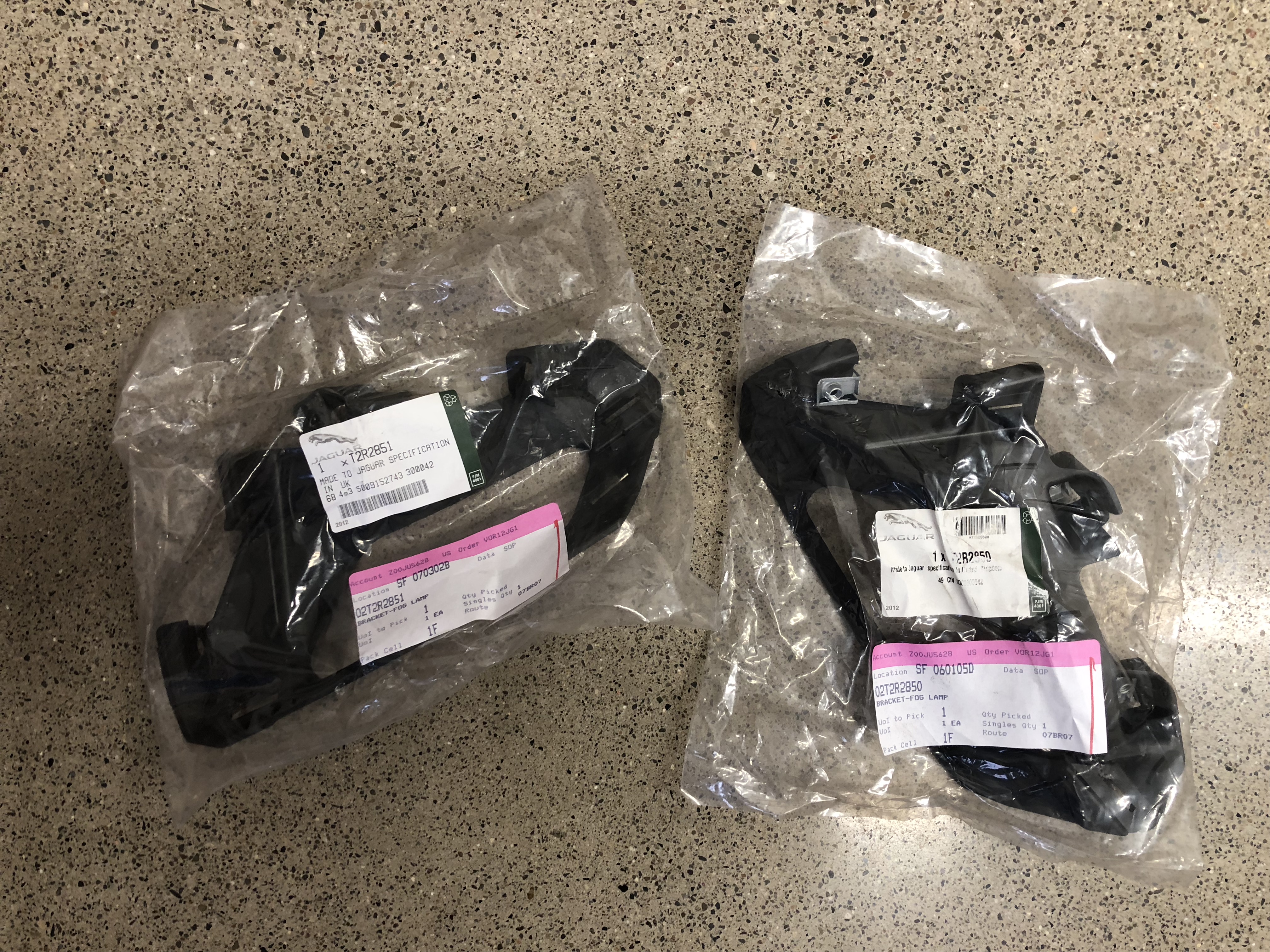

OEM side sills came in today and to my surprise they are already pre painted black. That works! Also received the OEM reverse light brackets to run the OEM lights. All parts are here now and ready to go on.

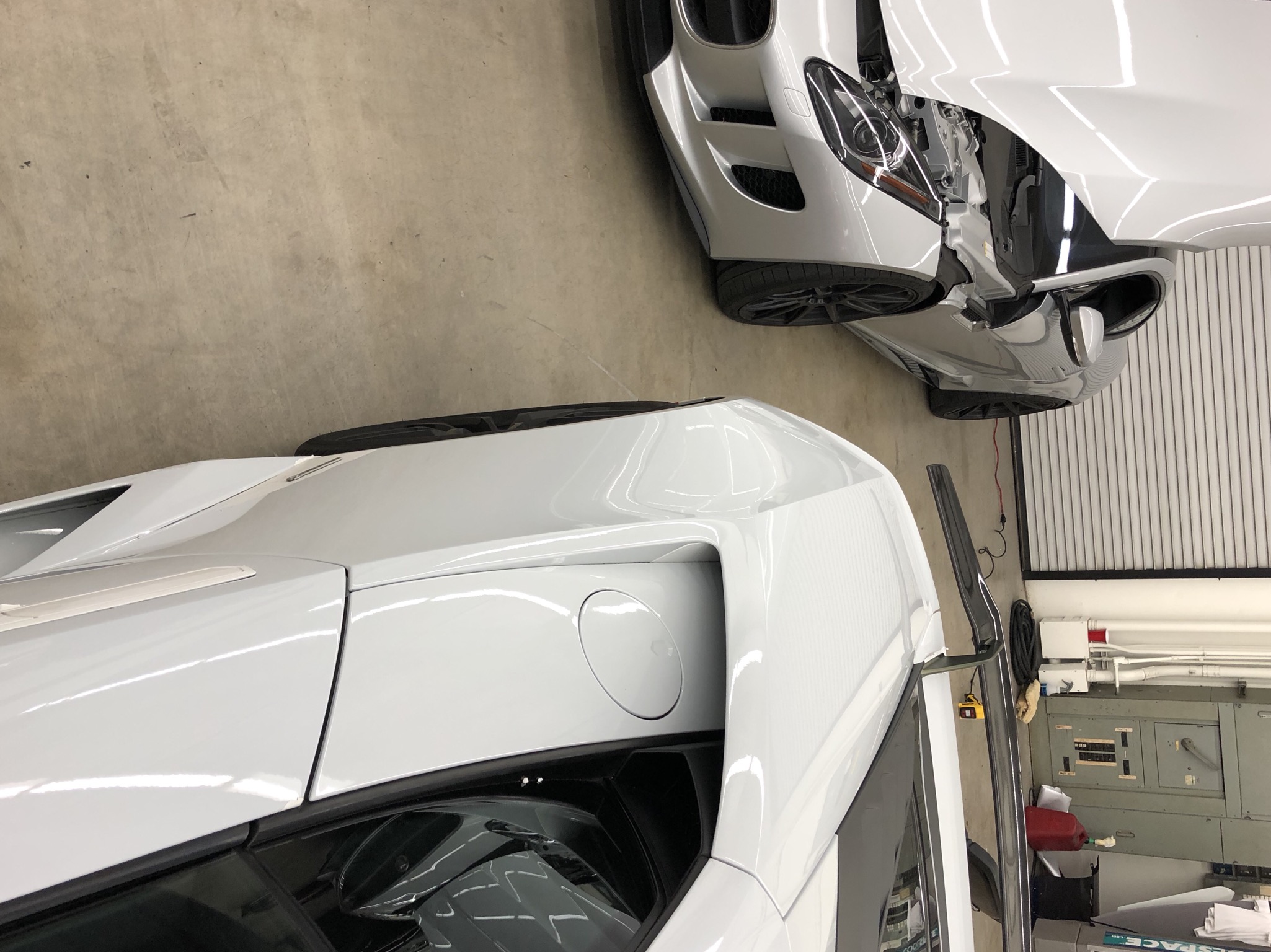

Mock up

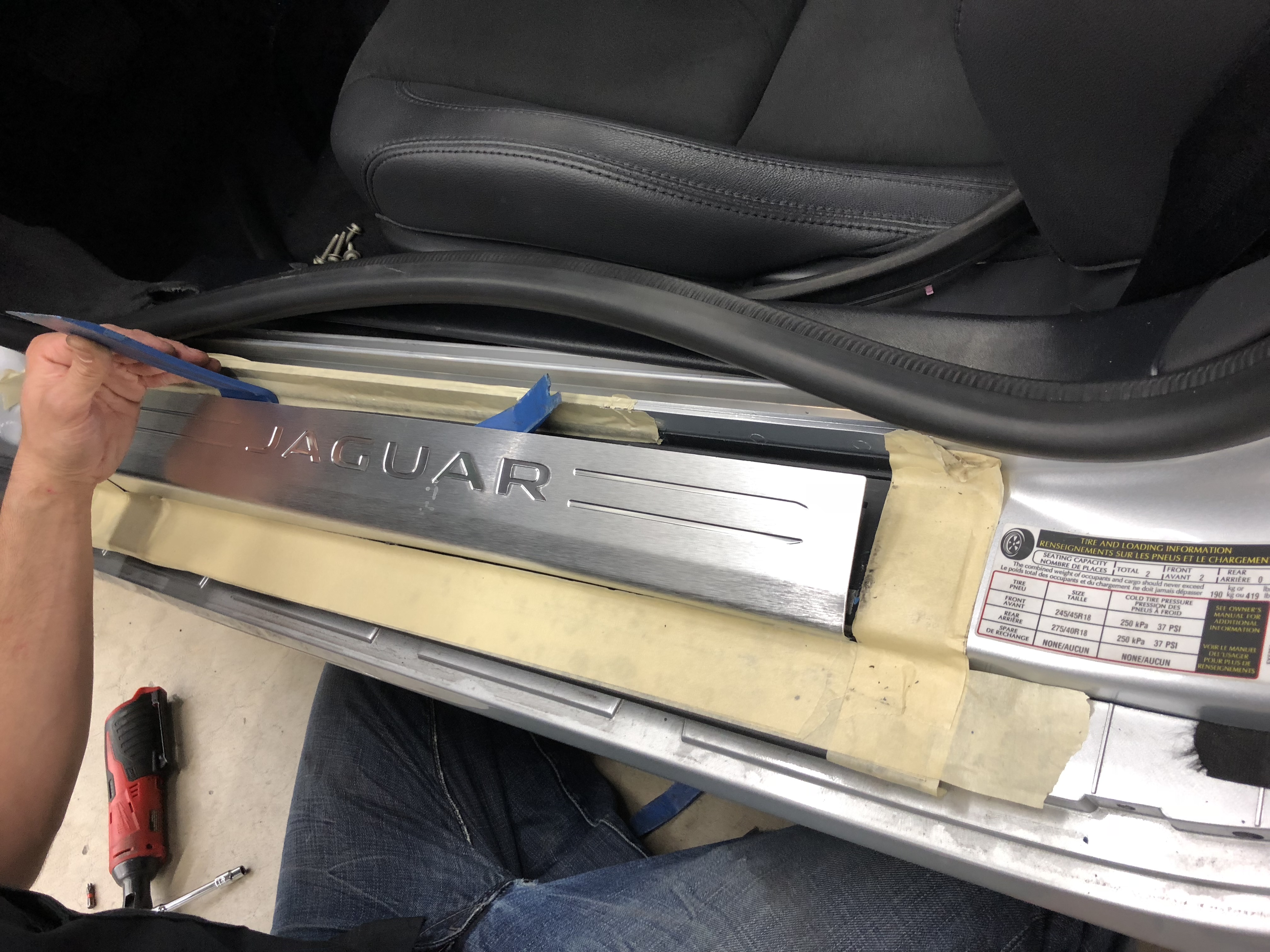

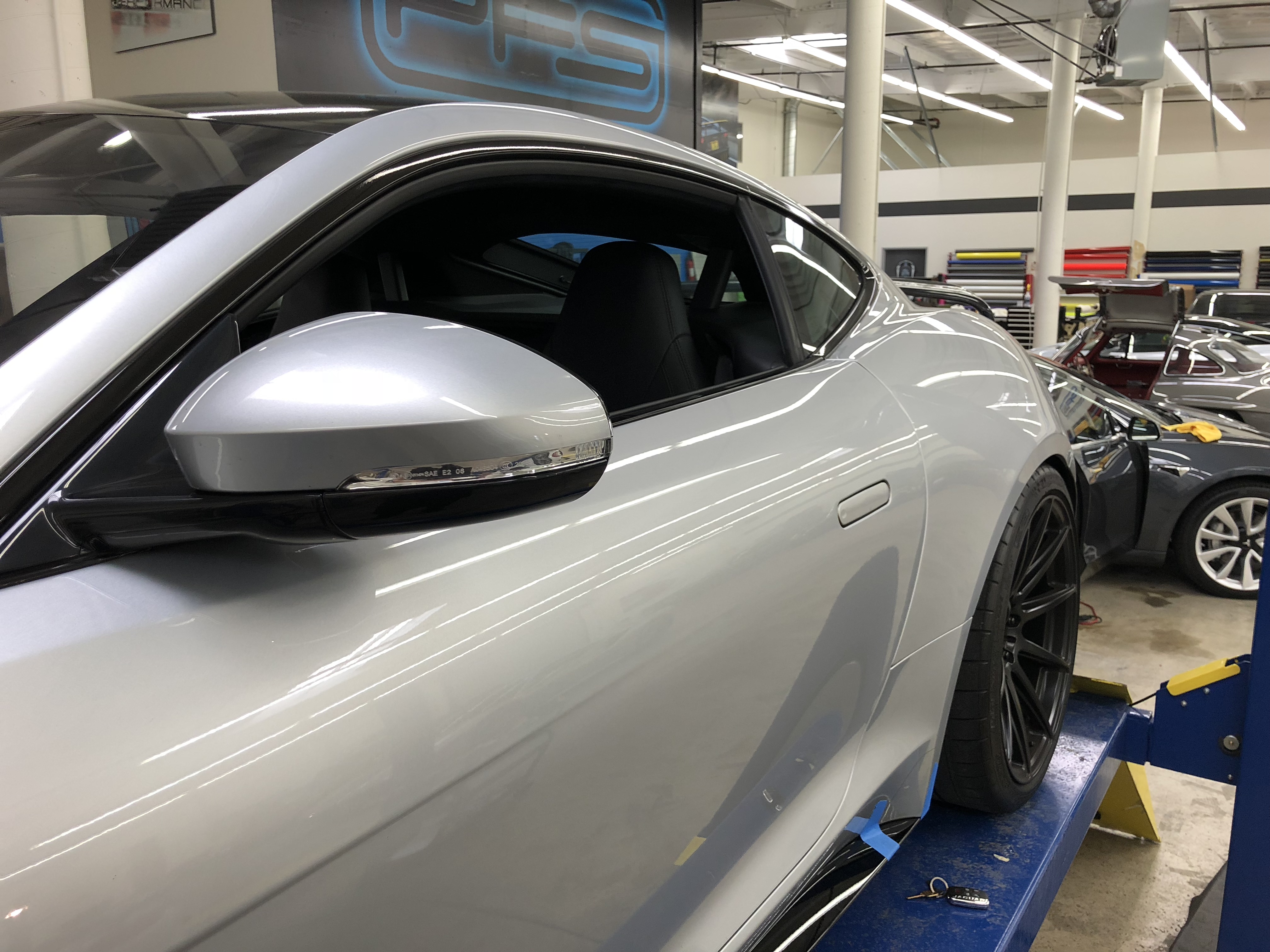

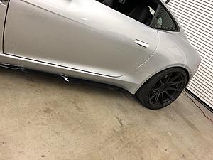

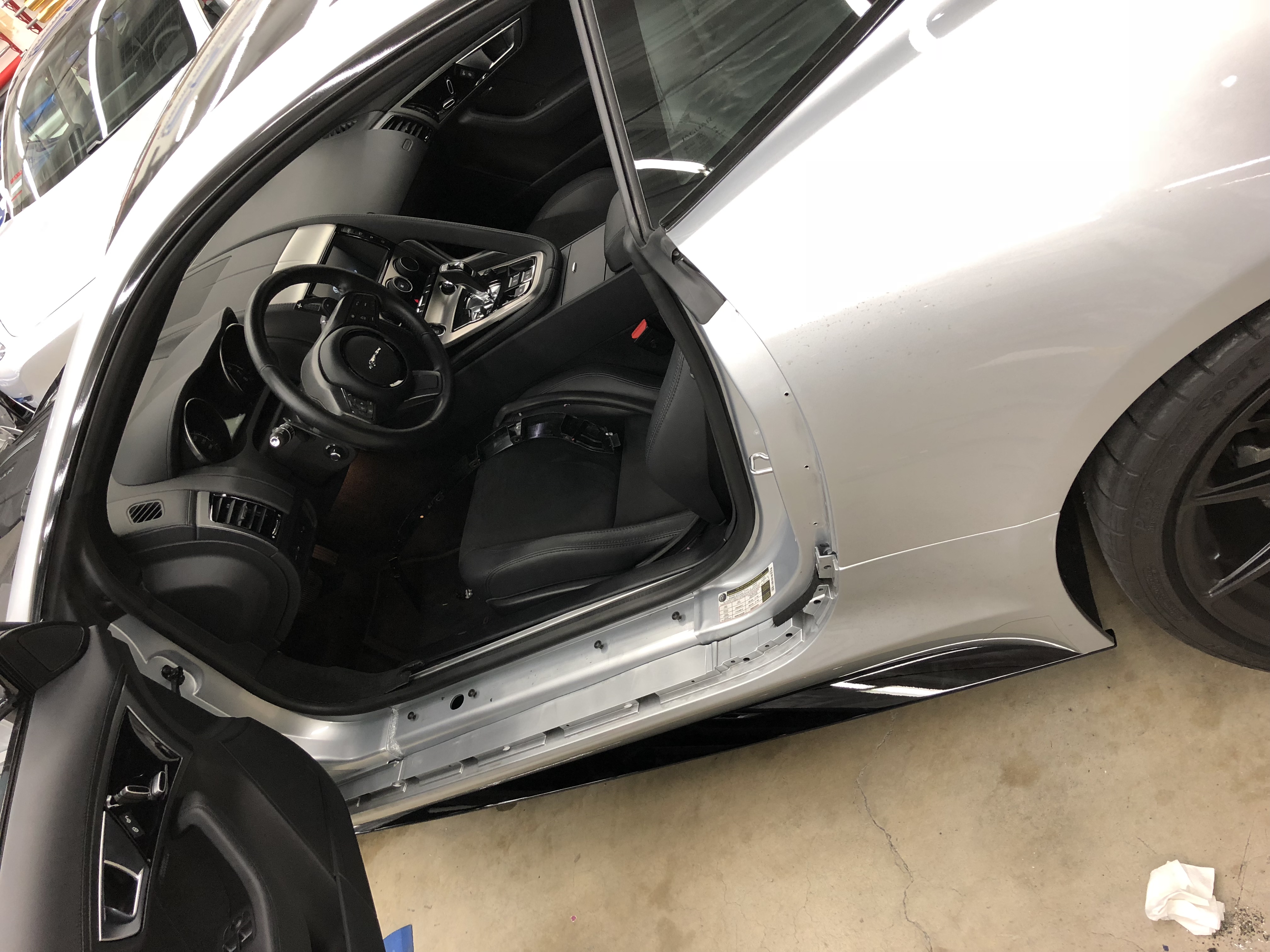

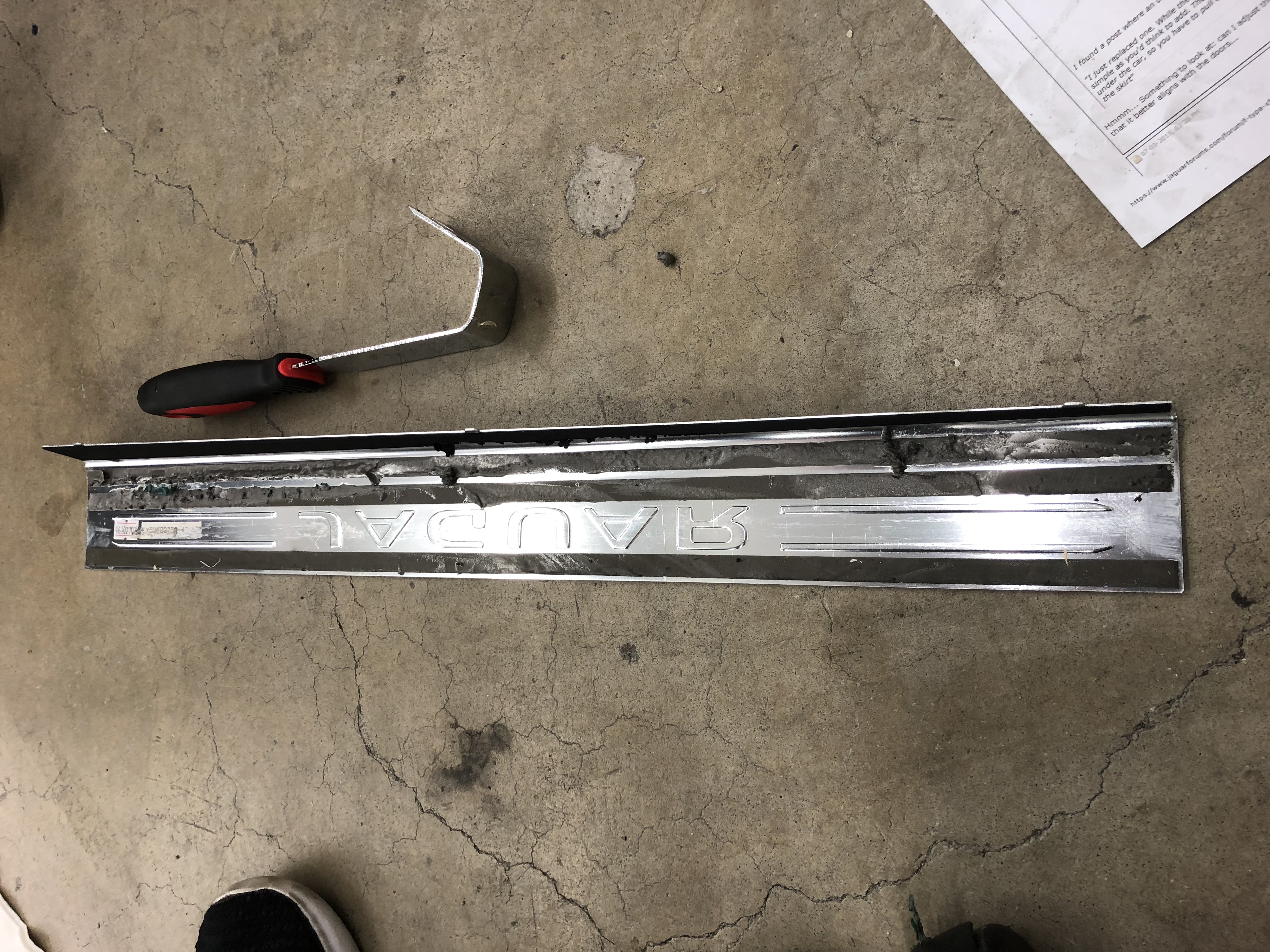

OEM Side Sills Installed
Well after searching for a takeoff set of the wider year 16+ side sills (also known as the finisher panel) I ended up just buying the year 14-15 sills that came repainted black from Jaguar. We spent a good 5 hours last night installing them the correct way. A lot of you were asking about the process on other threads and what all has to come off in order to install or remove ANY side sills so hopefully this helps!
1. Remove the interior door lining trim and remove the screws
2. Remove the aluminum Jaguar plates (THIS IS THE HARDEST PART DUE TO 3 LAYERS OF DOUBLE SIDED TAPE) Take your time and they will slowly lift up!
3. Remove the rest of the screws and plastic clips
4. There is a zip tie holding the back of the rocker panel on the car (cut it and leave it off)
5. Remove the 1 wheel well front bolt and the 2 rear wheel well bolts
6. Remove all of the retaining clips holding the rocker panel on from the bottom
7. Drill out the 2 rivets holding the plastic wind/debris deflector to the rocker
8. Remove the rocker panel
9. Drill out the required holes on the bottom of the rocker panel to install the new side sills
10. Use double sided tape across the inner portion of the side sill
11. Mate the new side sills to the rocker panel
12. Slowly install all of the new bolts and peel the back of the double sided tape off before completely tightening down all of those bolts
13. Reinstall rocker and side sills to car
14. Reverse order the install process
15. Drink a beer!
Attached Thumbnails FR500GT's F-Type Build Thread-57dc5009-5b7a-4cd6-94fc-ec0f590eac23.jpeg   FR500GT's F-Type Build Thread-c4a00562-6fff-4d64-878c-d92305b70017.jpeg   FR500GT's F-Type Build Thread-f0d75b51-62e8-4dcb-8781-f185f5eda864.jpeg   FR500GT's F-Type Build Thread-3a012564-4f5a-4975-a08c-bd2504cefc00.jpeg   FR500GT's F-Type Build Thread-b5303ca7-4cbd-4e10-b628-3bddf001574a.jpeg

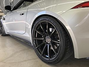

New Michelin Pilot Sport 4S Tires Installed
I decided to keep these wheels for a bit longer and I was in need for a new set of tires so I decided to upgrade from the Super Sports. I’ve been running MPSS’s on all of my cars for over 5 years now and love them but from the reviews everyone says the 4S’s are even better. I went with the same 255/35 and 295/30 sizes since they fit the car well. I look forward to testing them out on the track soon!
I am amazed you were able to remove these without damaging them. My body shopped worked hard on trying to remove it without bending it, but the 3M tape was strong and would not let go. Ended up just buying brand new plates. I am jealous you completed this without destroying the plates.
Old Jan 18, 2018 | 05:39 PM
  #118
FR500GT's Avatar
Joined: Mar 2017
Posts: 737
Likes: 153
From: Orange County, CA
Originally Posted by zmoothg
I am amazed you were able to remove these without damaging them. My body shopped worked hard on trying to remove it without bending it, but the 3M tape was strong and would not let go. Ended up just buying brand new plates. I am jealous you completed this with destroying the plates.
I read your thread as well as all of the other threads on this subject for weeks and it helped prepare us but with A LOT of time and patience we made it happen. Hopefully my write up will help instill confidence in others to tackle the project themselves in the future.
Old Jan 18, 2018 | 06:11 PM
  #119
OzXFR's Avatar
Posts: 9,031
Likes: 3,664
I wonder, would it help to remove the tread plates by heating them up a bit and thereby softening the 3M tape adhesive? This works for such things as removing glued on badges on the bodywork, so why not with the tread plates? I would try a hair dryer first before resorting to a heat gun which could melt/damage the surrounding vinyl/plastic.
Old Jan 18, 2018 | 06:45 PM
  #120
FR500GT's Avatar
Joined: Mar 2017
Posts: 737
Likes: 153
You are correct! We used a blowtorch to lightly go over the top and help loosen the adhesive. I forgot to mention that in the write up.
