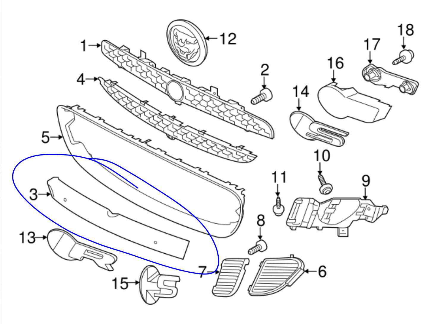

Any tips and tricks? How long should it take?
I plan on replacing this piece:
Thanks!

less than 30 minutes to remove the nose.

Thanks! Have you done it? Any steps you can share? From what I gather, a bunch of washer fluid stuff has to be removed...

After the bolts are removed and the nose is pulled forward about 6”, you have to disconnect two of the proximity sensors (those in the cross bar) and pull the hoses off the 2 head lamp washers. All very straight forward.

The clips on the grills are ridiculously tough. Removing the bumper has taken 10% of the time so far.

By the way, for anyone referencing this in the future -- use a heatgun to heat stretch the clip openings wider. Each clip will take about 5 seconds of heating. Once the grill is off the car, heat each opening again to melt the plastic back to the original size.
