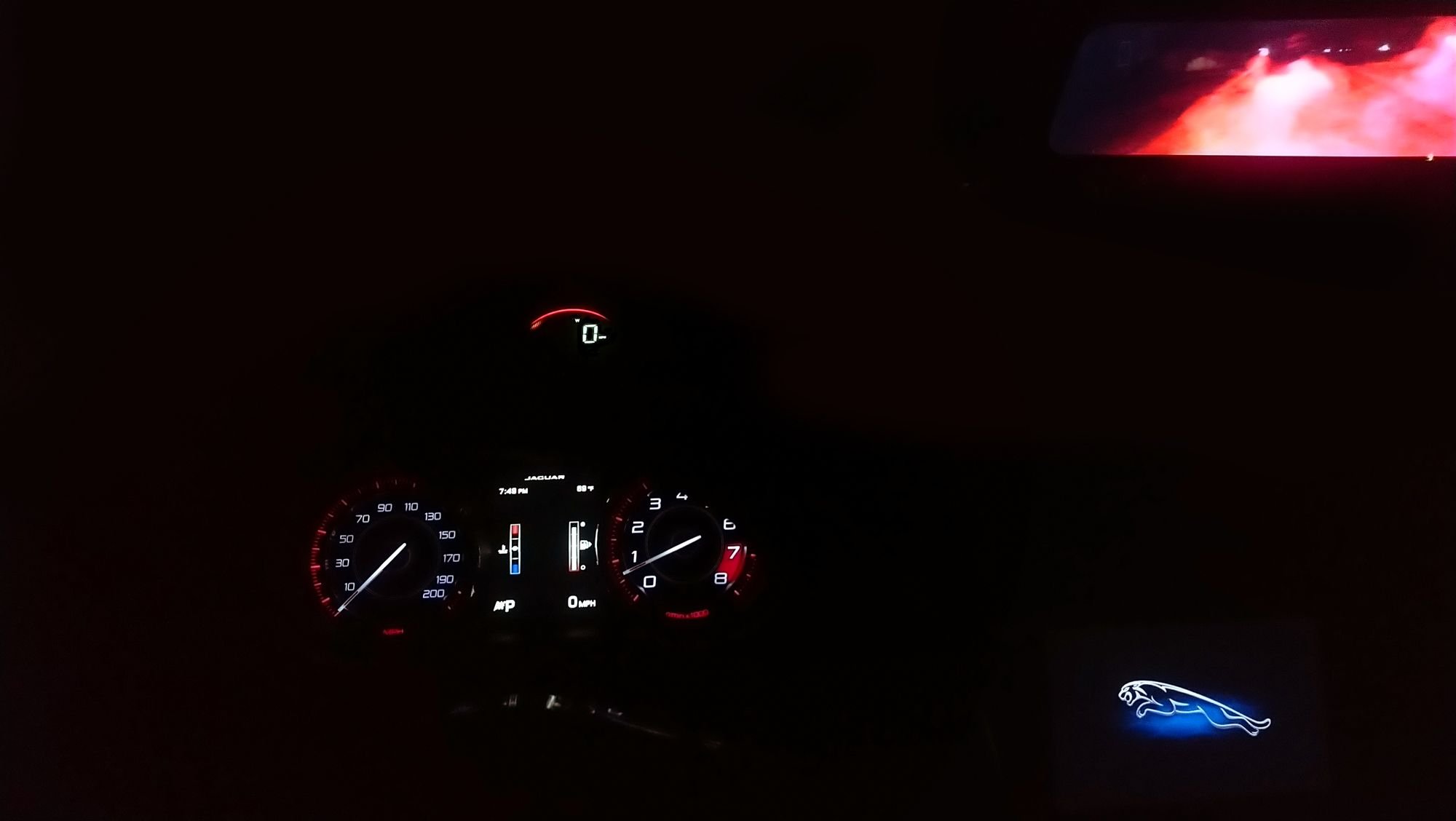

I'm in the middle of a HUD experiment and will post negative battery impacts after I use it for a while, if any. I have a 2014 V8 S. I got this simple HUD off
Amazon Amazon
(no affiliation) because it is speed calibratable and runs off either OBD or GPS. In OBD mode it displays the same speed as my digital speedo using the factory calibration. The only issue is opposite to other HUDs I've installed which is that it's too bright for my taste even in the daytime. At least that was fixable with two layers of 30% window tint over the white numbers and one layer over the RPM arc and now it is perfect. I like the simplicity and small size of this model and it sort of matches our Dynamic Mode theme with the optional red arc over the top of the RPM band. Like all digital tachometers IMO, the sensed RPM is too laggy to be of any use so it is just for bling. This model doesn't even pretend the RPM reading is useful with no numbers displayed. The mph OTOH works as good as the car's digital display. Another nice thing about this HUD is that it displays the battery voltage for a few seconds before it cycles off with the ignition. It stays off when the ignition is off, but wakes when the drivers door opens or the start button is pressed, just like my rear view camera/dash cam mirror in the upper right of the photo.
