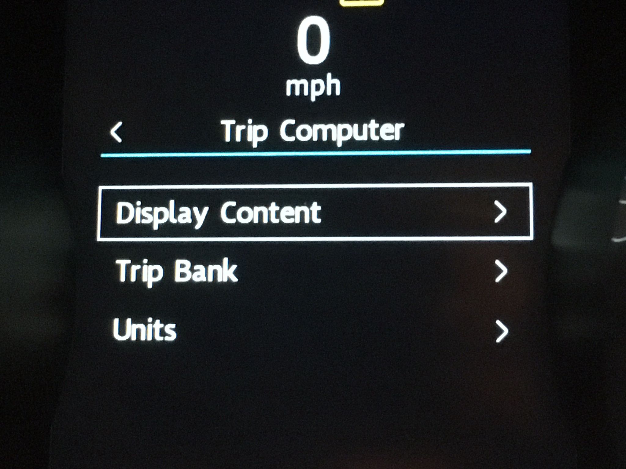

So after a quick trip to the garage I guess I still need some help .....
My only choice seem to be
Display Content
Trip Bank
Units
I don't seem to have the "Display Settings" the others mention......
Am I looking in the wrong spot?

press menu, press up arrow until you get to display settings, press menu, scroll up or down to widgets, press menu, scroll to "logo", press menu, then press left arrow until you get back to logo. Rather than "logo", I find the trip data far more useful. Puts all trip data on the screen at the same time.

I have no "Display Settings" choice.
Only the three choices shown in my post above....
I did have to disconnect the battery to get my maps back in my Navigation.
I wonder if that caused it to reboot into a different mode?

Yes . Rebooting the system will default the display back to audio dislay.
The 3 options above are in the Vehicle Settings menu (wrong menu).
On the left steering spoke is the menu/enter button surrounded by the 4 scroll arrows. Start by pressing the left arrow several times. Then:
1) press menu,
2) press up arrow until you get to "display settings" (not vehicle settings)
3) press menu, scroll up to widgets
4) press menu, scroll to "logo",
5) press menu, then press left arrow several times until you get back to Jaguar logo display.
